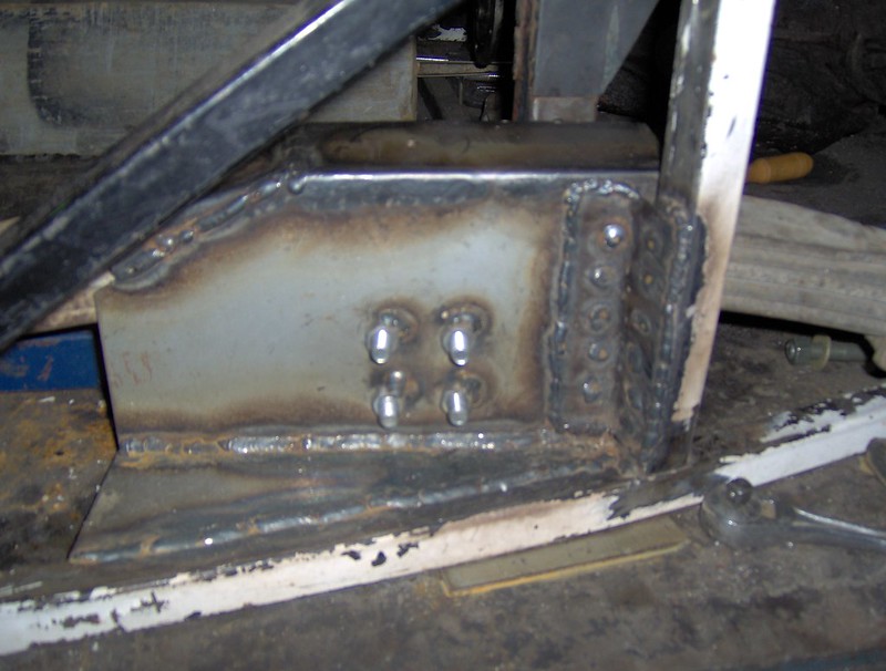

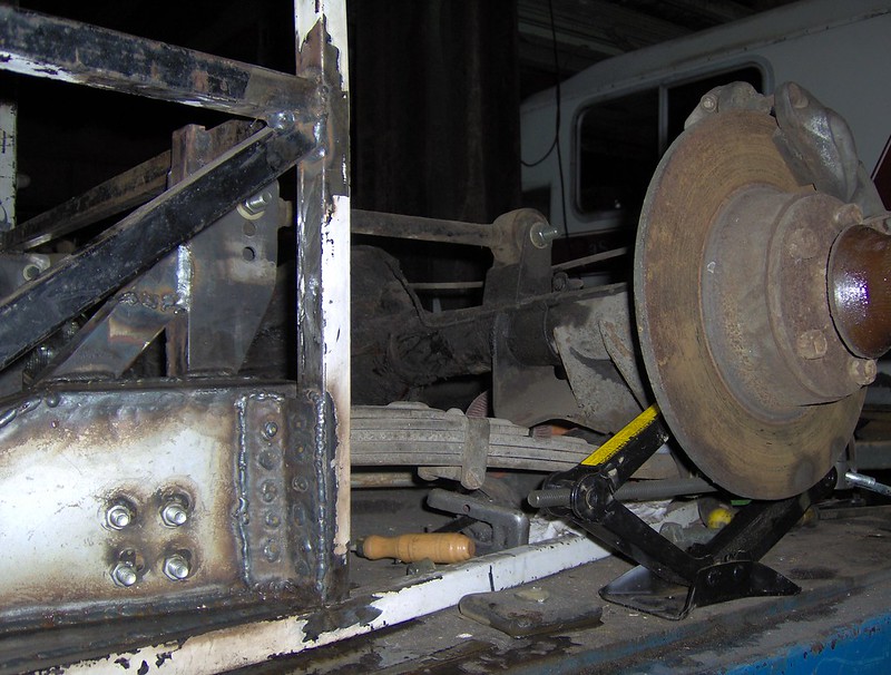

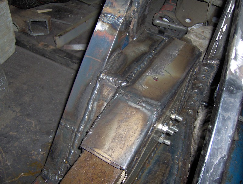

    I jumped in with both feet today. I started wleding the spring boxes in solid. First though, I tapered the front edge of the boxes down for a little more **** room.
    Mounting these things is like putting a puzzle together. It is hard trying to figure out how to weld it all together such that you can actually get to where you need to weld.
    I got them welded in enough that I was able to put a jack under the rear axle and cycle the suspension. My spring boxes work as intended....as the rear goes up, the front of the spring pushes down.
    All in all, it was a good day in the shop.
    I will try to remember to take pics tomorrow and post them.
  6. Flipper
    Joined: May 10, 2003
    Posts: 3,604
    Flipper
    from Kentucky

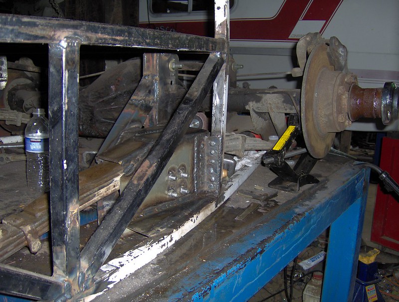

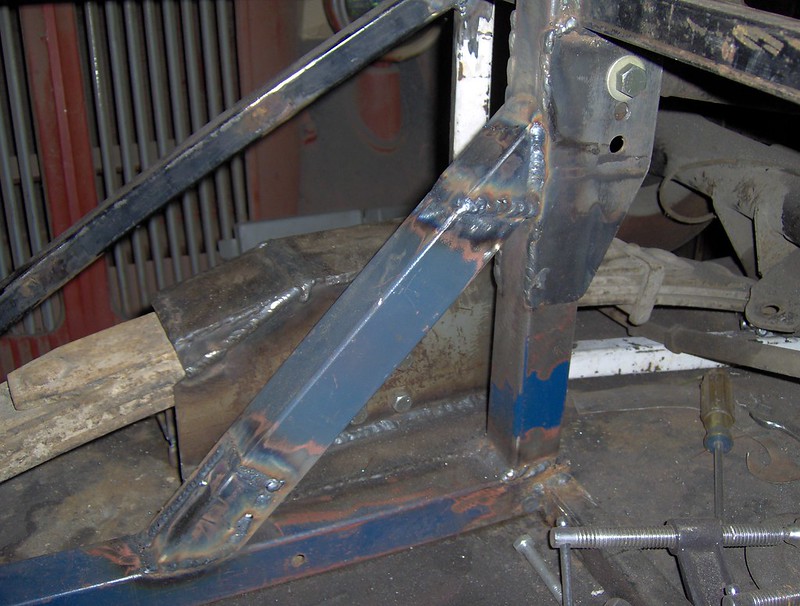

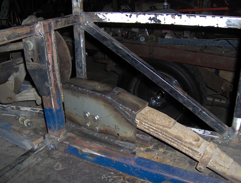

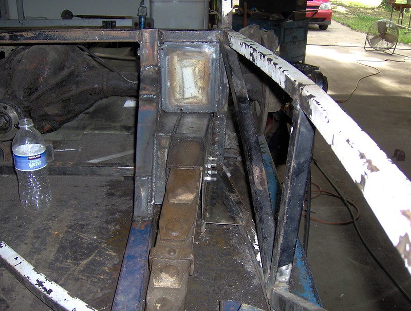

    Here are the pics of the boxes getting welded in.
    The link mount needs support. I will also tie the boxes in to these.
    Stuff is too crowded to get to all seams. I cut the tube apart. Some of the welds are on the inside. After these welds are done, the tube gets put back together. Fun!
    kidcampbell71 likes this.

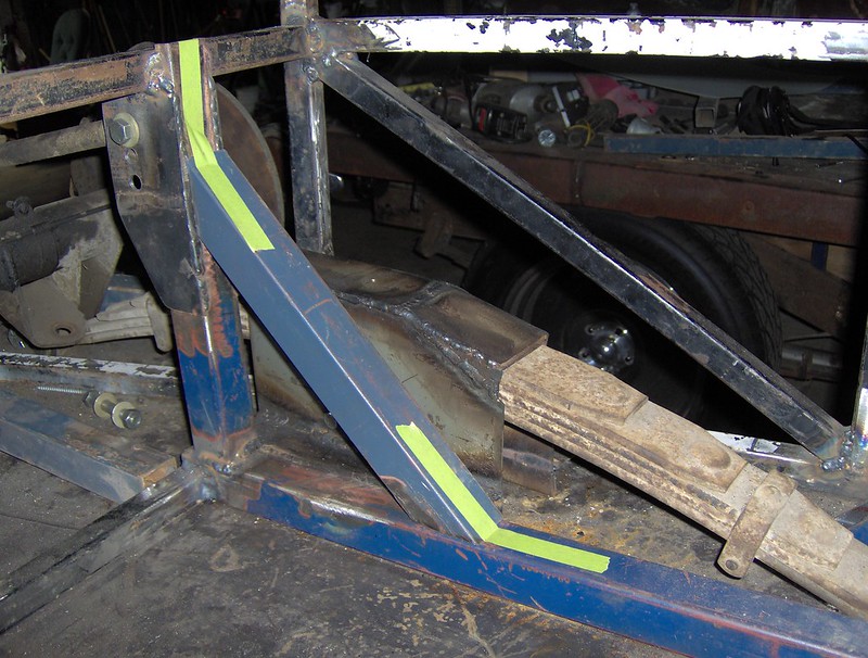

    Tubes put back together
    Boxes tied to the diagonal
    Pics of loading the suspension. I think links are going to work fine where they are.

    This is where I ended the day. I plated in the opening above the boxes. I feels really solid.

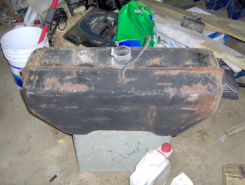

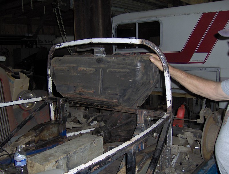

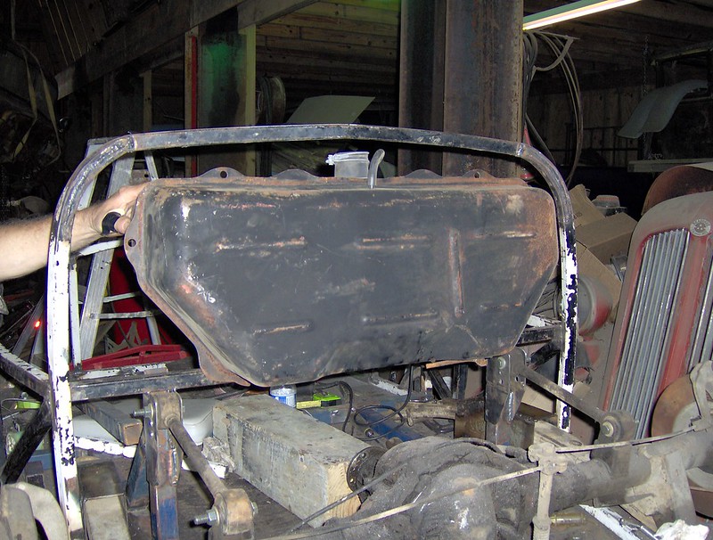

    I also played around with what to do for a gas tank. 1952 Mercedes gas tank looks like it will work for this car.
    It should clear the links OK and has a little bit of clearance for the diff. Fuel inlet will work with a racecar style cap on the top of the boattail.

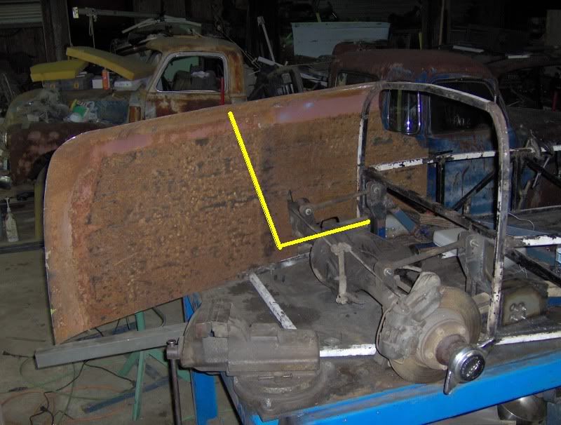

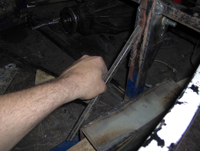

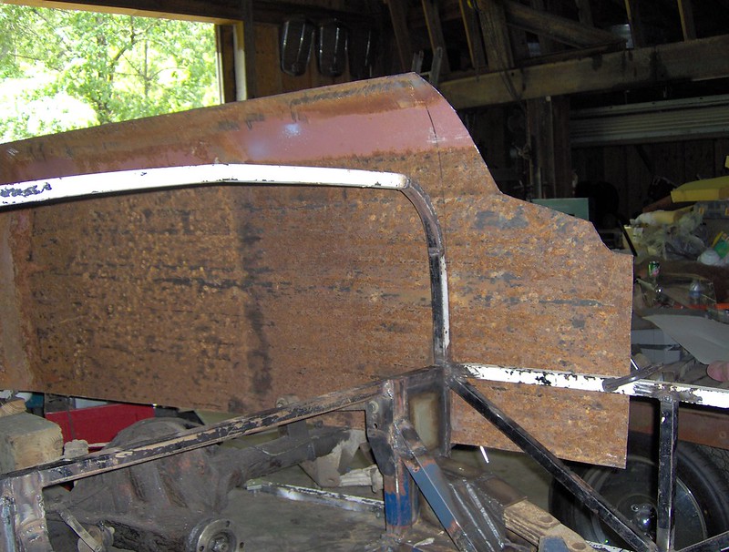

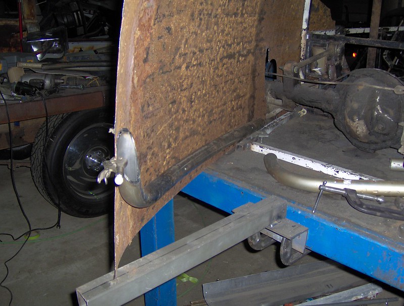

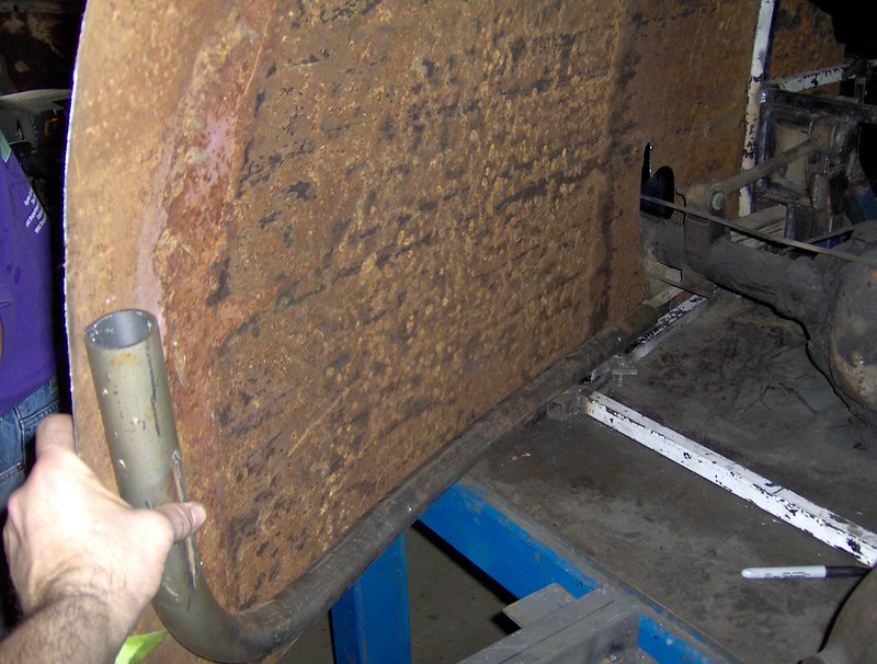

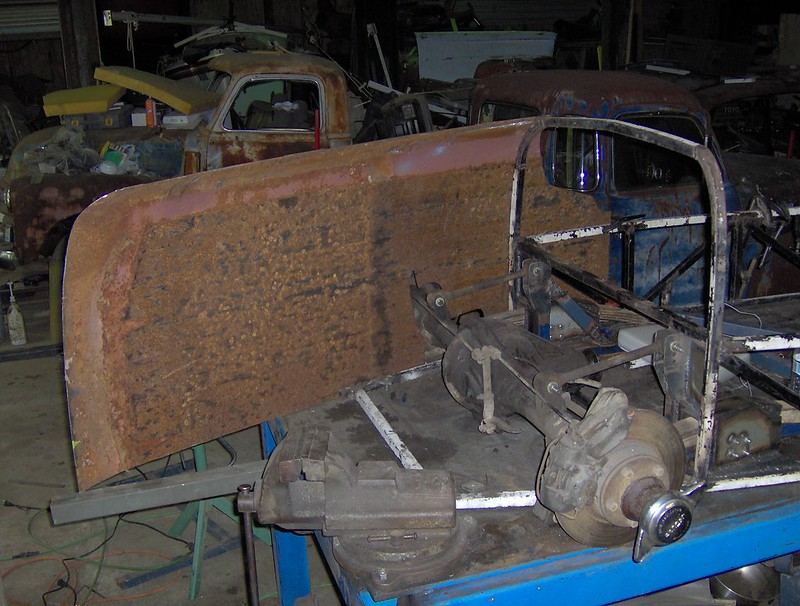

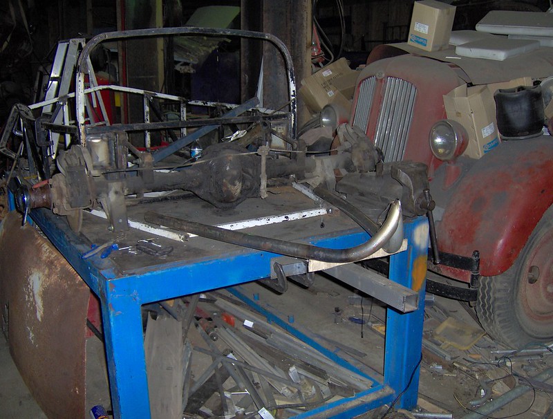

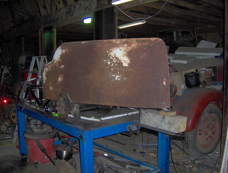

    Today was a fun day. I finished up a little welding on the p***enger side spring box and then started trying to mount the body side.
    It was more difficult than last time. There is an axle there.
    I started by mocking the body up on top of the axle and blocks of wood to see where stuff lined up.
    I am glad that I thought to draw a reference line last time it was mocked up.
    First set of dimensions....end cut out was WAY different.
  12. Flipper
    Posts: 3,604
    Flipper

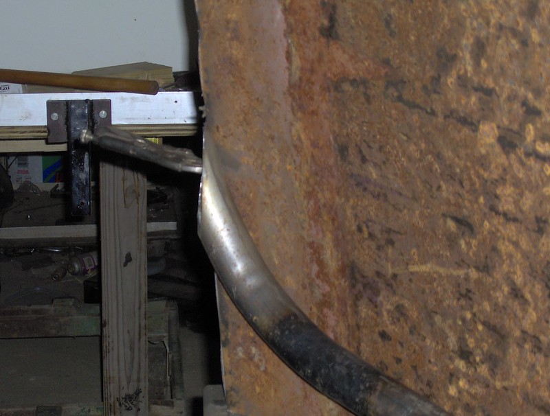

    from Kentucky

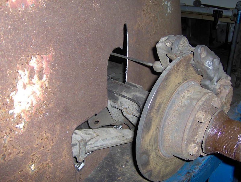

    The first cuts were barely a good starting point. I am glad I started slow and snuck up on the shape. The axle moves rearward as it compresses.....really moves rearward! That parking brake cable was kind of a pain too.
    Lots of jacking and drawing, then triming and re-instalation.
    Final shape. ...I think.
    ratrodrodder and kidcampbell71 like this.

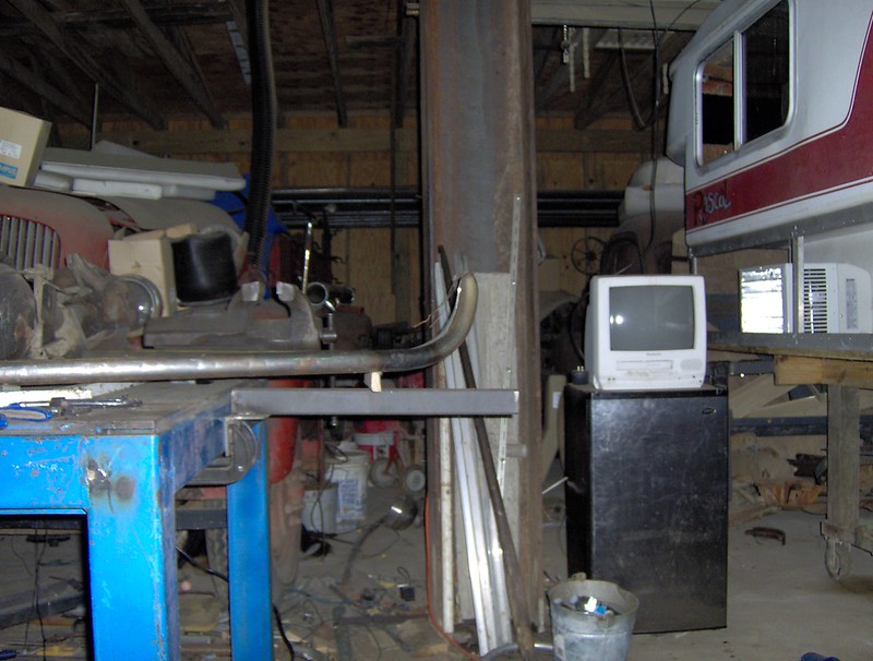

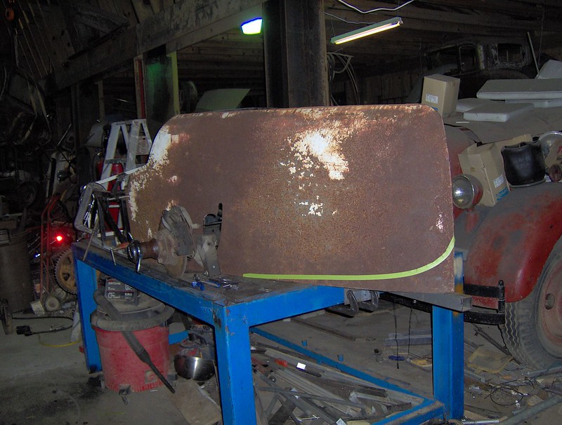

    from Kentucky

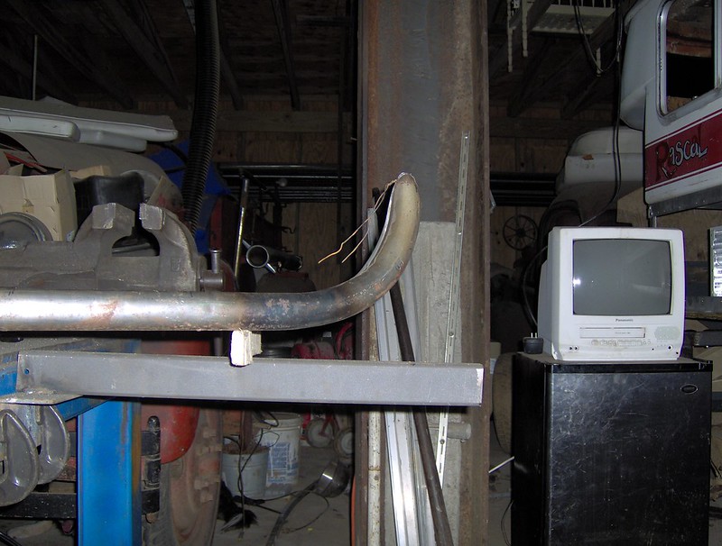

    I know the tail sticks way out there and will drag everything, but I can not make myself cut the heck out of it for clearance. I think I am just goint to beef up the tail so it can handle being dragged. I may even add a caster back there.
    Here is the current idea. Slight sweep with a radius at the bottom.
    Right now the whole back end is an almost clean sheet to work with
    Playing with cop car roll bars and a harbor freight pipe bender.

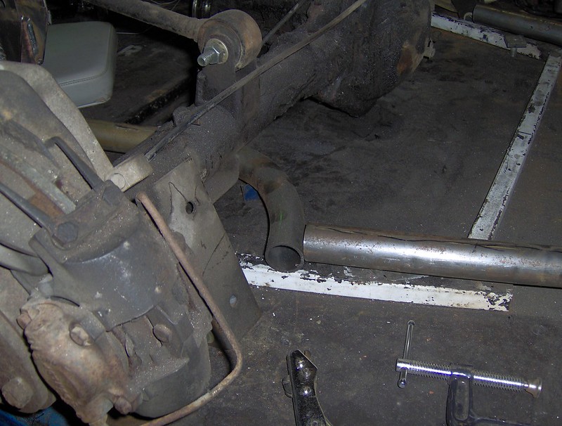

    I trimmed the tube. kinda hard to do just by eyeballing it. Still needs a little fine tuning....but I think it will work.
    Close enough that I made another one for the other side.

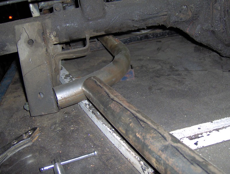

    Flipper
    from Kentucky
    I am using more cop car roll bar parts to complete the rear frame rails. Using a couple of bends, I will be able to clear the shock mounts and tie into the 1.5 x 1.5 that runs below the upper link mounts. The joint will be mitered.
    This will also gime me a "crumple zone" for the rear frame rails. Heaven forbid I take a hit or spin out in it, the 90 degree bends should fold.

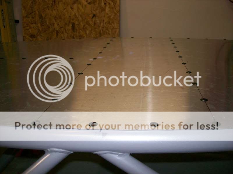

    Thinking about using screws like these to attach the body panels. Any opinions?
  24. James D
    Joined: Feb 8, 2007
    Posts: 5,132
    James D
    Why not. Its interesting and different.

    What exactly are those screws above?
  30. Flipper
    Posts: 3,604
    Flipper
    from Kentucky
    I think they are "truss head sheetmetal screws"
