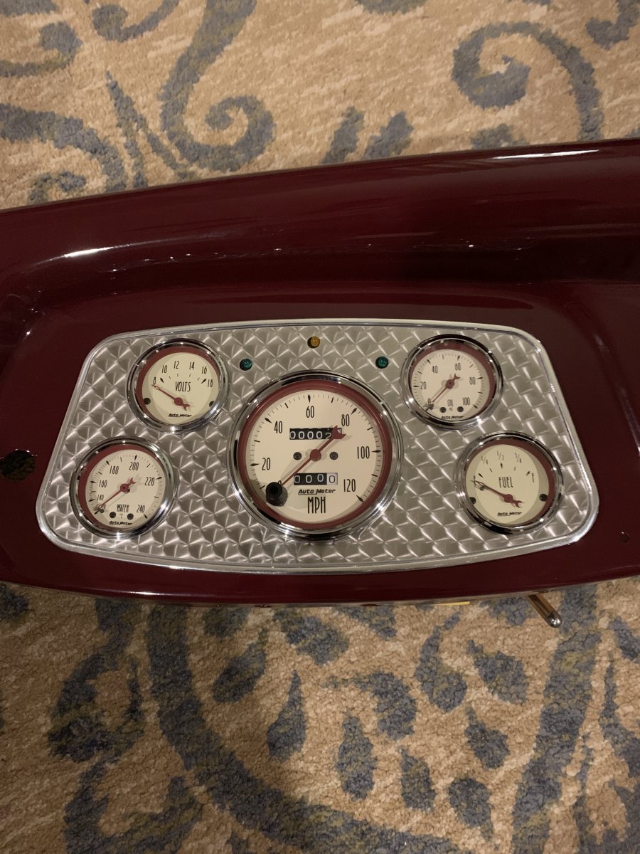

    Here is a picture of the dash and gauges. The Maroon is the color of the window garnish as well. I am going with the same color for the wheels.
  18. Very pretty!
