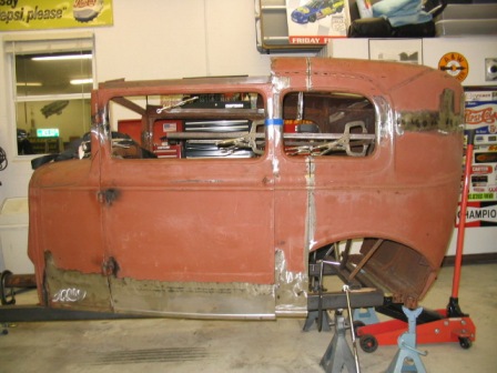

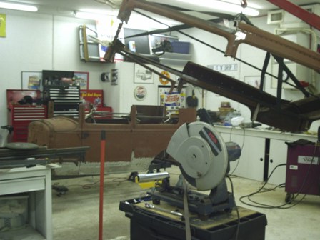

    I built a frame jig to work on, attached the body and began replacing all of the body panel areas on the lower half.

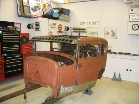

    Once that was completed, I took 4 1/8" out of the top.

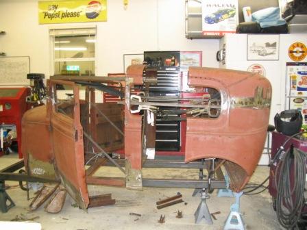

    Then I built a jig that I could slide and adjust (one-man-operation here) so I could section the body 15".

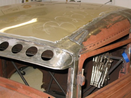

    I then aquired a Model visor from one of my HAMB brothers, and proceeded to break-in my hole-saw collection.
    I needed to fill the 'shortend-roof', and a trip to the bone-yard yielded a roof from a Chrysler Concord. I have them deliver the entire roof section, and I laid out the diamensions, and cut away.
    It fit perfectly, and has a very nice curve....lays on nice.
    The roof area above the doors near the visor was all damaged or missing, so I made new pieces, and welded them in.

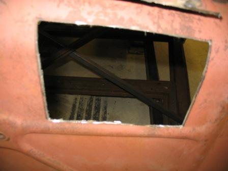

    The firewall had your typical spliting of the sheet metal where the support braces went into the firewall.
    I used 16 gauge sheet metal, and hand formed new pieces, marked out the area of removal, cut out the bad areas, and welded in the new pieces.
