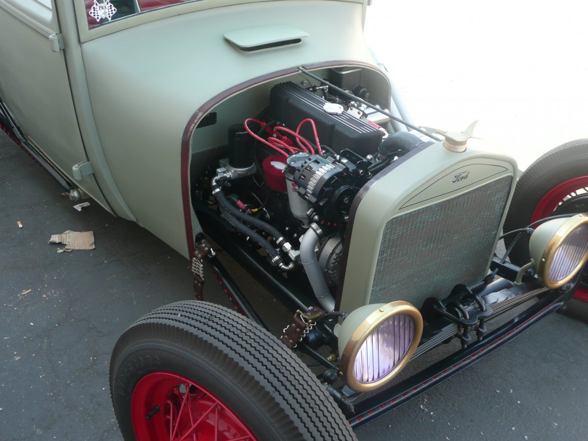

    I was seriously thinking of buying this truck several years ago. A truck closer came up. Anyway I don't know if this will help you or not. It is a '31 but that shouldn't matter. This particular truck had a 5 speed (T5 I think) and a quick change rear.

  6. This is as close as I can get, a 4 cylinder Chevy II (actually it is the 181 cubic inch Mercruiser version with a 153 head) in a '32. Sure nice to have plenty of room for the fan. I think it looks better with Ford Green on the engine. I think if you go with the Iron Duke you need to be sure the motor comes from a rear wheel drive car or you will have problems with the adapter to the early Ford transmission. The nice thing about this conversion for a '32 is that the transmission, pedals and wishbones problems aren't there.

    Mercruiser offered a true 8 port head on it's 140 hp package but it's not a cross flow. That engine also sports a bigger crank. Ansen made a cross flow head though.
  8. To illustrate your post attached is a picture of the 153 and the 181 Mercruiser heads. I have also included a picture of the Ansen cross flow head for the Chevy II engine. Note that heads for the Chevy II 4 cylinder will not readily bolt onto a Iron Duke. I think the current GM Industrial 4 cylinder is the same as the 181 Mercruiser except the Mercruiser had water cooled manifolds.
  9. Cool stuff. Here is the engine. I took it off a little 27 roadster that came from the states to germany. I think it belonged to John Evans before it made it to Germany. The new owner did ask me for a V8 swap so I did what he said and took the cool little 4 banger in trade. Now there is a 30 sports coupe near by that has a hopped up banger. The owner doesn't feel safe with A engine and want's something "bullet proof". I will put this Chevy in the coupe and he will give me the hopped up A. I wan't to stick with the closed drive, hence not so much cutting. Idea is Adapter, V8 box and home made pedal braket. Does not need to be T5.
  10. This is the sports coupe the Chevy is supposed to put in.
