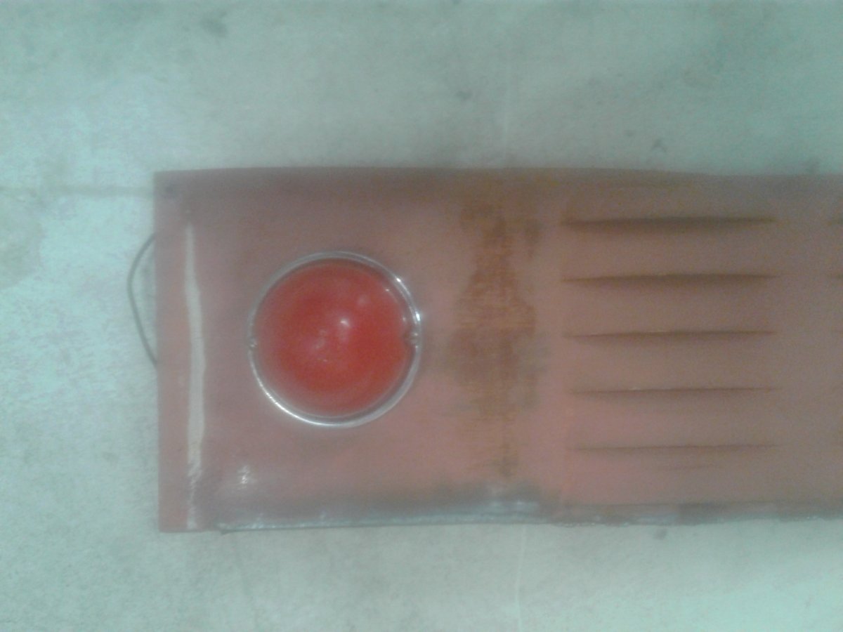

  1. Hey guys.
    Thinking using 3" brake light/turn signals on my truck but afraid of people not seeing them..
    Also i refuse to use LEDs in older cars so that option is out,unless they can be made to look old.
    Thoughts?
    Here's what im working with:

    By your photo it appears these lights are under the tailgate on a rolled pan. You need something up in the back window or some stop lights hidden under the upper bed rails to be safer. I know it's your choice but better safer than the way they were when people who gave a damn drove cars..

    It's pretty hard to see how the lights will look, from one blurry picture of a part of the car. I don't see any reflector in the lens, which is something you probably want to think about...if the lights go out, or you're stopped on the side of the road with the lights off, or even if the tail lights are kind of dim, having some reflection will help folks see you at night. Also we can't see the inside housing, to see how reflective it is. having a rusty or dirty inner housing gives off less light than a shiny plated or white painted housing.

  16. Here's how they will mount.
    Just like jimmy6 said..
    I really dont want to add a 3rd light even if I have an 8" "stop" light.
    Thanks for all the suggestions so far.

  25. This is something that many builders ignore, but having a red reflector present on the rear of the car for safety has been a SAE or DOT requirement since the '40s. Most OEM lenses have it built-in, but not all; on vehicles that lacked the lens reflector, the manufacturers installed a separate reflector and still do this to this day.
    The lights shown look like re-tasked clearance lights and lack the reflectors, so were never DOT approved for stand-alone use.

  30. The housing needs painted but it is white,the lense is plastic and its old thats why u cant see the bulb.
    But i have the glass ones,i used this as my mock up.
    U are right om thinking of adding reclectors in the tailgate as it was when i was given it.
    I wouldn't know where to mount it.
    Yes these were clearance lights.
