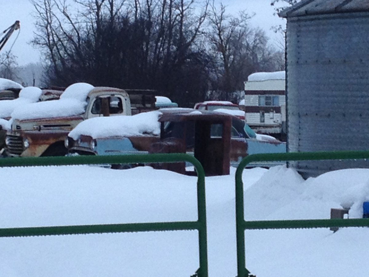

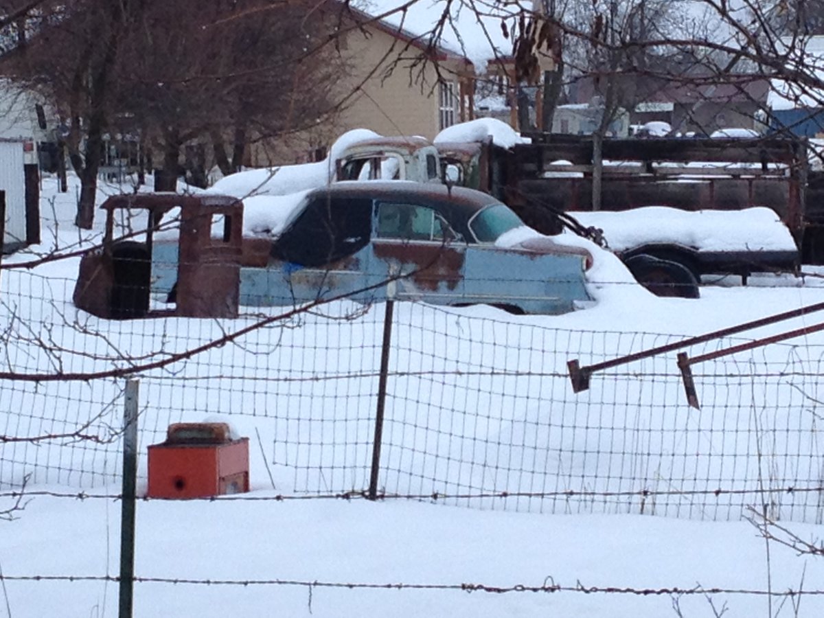

    Now that Im learning a bit about Fords. I see this one daily. Its a four door I think but Im wondering if anything on it rim wise would help? I hear this guy sells nothing, he just collects them in his yard. IMG_6464.JPG

    belair
    They make nice mild customs. I would Chevytize it if it was mine. Looks like a pretty solid and complete car. Good luck.

  27. Slopok
    Joined: Jan 30, 2012
    Posts: 2,955
    Slopok
    Your Dodge rims have the same bolt pattern as Fords.
  28. RUMBLON
    Joined: Feb 8, 2007
    Posts: 82
    RUMBLON
    I knew the newer fords, IE 60s were the same in the muscle car era but I didnt know this would be a 5x4 1/2. I have two sets of rims and tires that are new and would work. Both sets cost more than the car.
