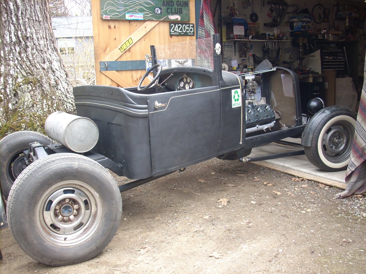

    I'm also doing a T with volvo 544 engine and trans,got engine in a trade it's all rebuilt so what the hell use it...it's going to be a single seat bobtail, it being built from parts I had or got for nothing or trade ,have most everthing for it, now I'm starting to put it all together, cash money investment so far is $30 bucks....[​IMG][​IMG][​IMG][​IMG]

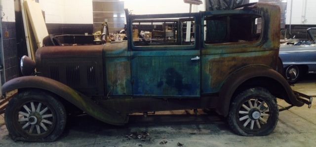

    I found a 1930 Willys sedan on E-bay about 2 years ago. Got it for 415.00, no ***le,just Bill of Sale.
    Cost me more to drive from NC to PA and return than it did to buy it.
    Bonded ***le is not extremely difficult, but it may test your patience, cost me $100.00.
    300 ford six-$150.00,Tremec 3650 5 speed-$300.00, 8.8/3.55 out of explorer-$100.00.Roof from Ford Aerostar-$75.00
    I have sold about $500.00 worth of parts off the Willys so far. Engine/wheels/lights/guages/etc.
    Stay away from custom ****. Do it yourself with junkyard parts. It helps to have welding and machining skills.

    Well the frame is a 14 T ,front cross member is flipped, old dirt track trick I read about, Z'd the frame about 9"or so ,used a section of T rail for the kick so that the shape stays uniform front to rear, model A axle ,suicided,up front model A in the rear, T springs both ends,40 Willys radiator, the body panels are some ideas I'm playing with, 29?murray cowl that's been narrowed and pulled together to form the hump ,radiator shell cut down chevy, engine is 63? Volvo pv 544 duel carbs trans from same it will be a single seater ,I'm just getting going on it again, it's a filler project I work on when I'm in between on my other builds I will post more as I go....thanks
    Terry
    AKA RudeStude aka Terry T-bucket

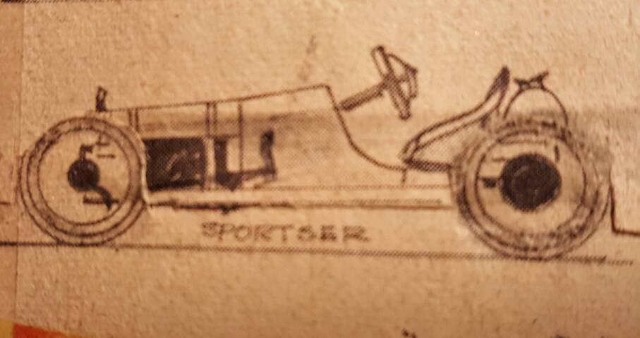

    Found this picture a few years ago when I first started kicking around the idea of putting a T together, did a little paper slicing and came up with this, it's the look I'm going for....
