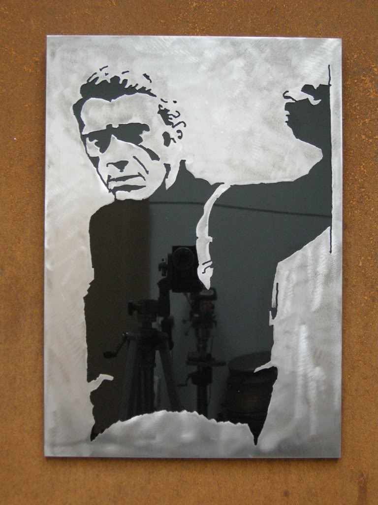

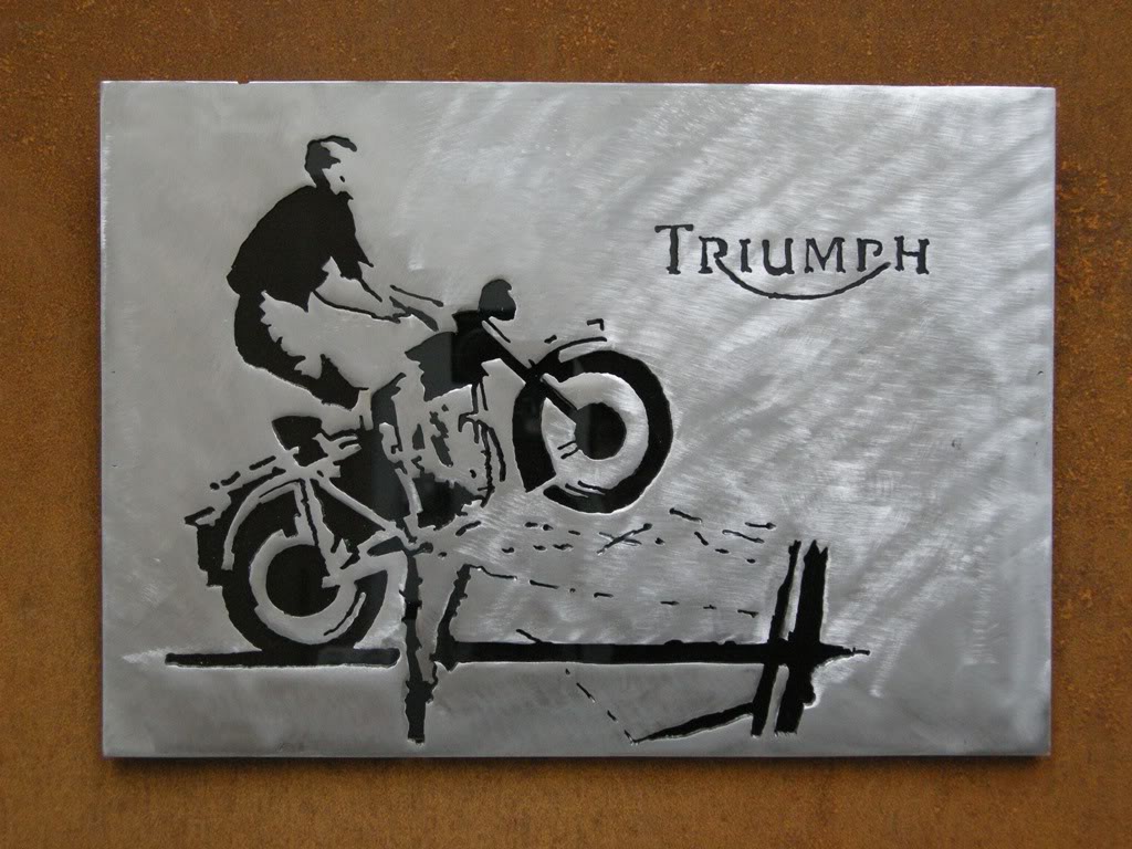

  23. I use my plasma all the time, given the cost of a good unit I would suggest they are a luxury as a garage tool and there is no point buying a cheap unit!
    I get bored easily and find myself doodling with mine, only when there's no proper work to do mind.......
  24. ^^^^^^^WOW, very cool!!
