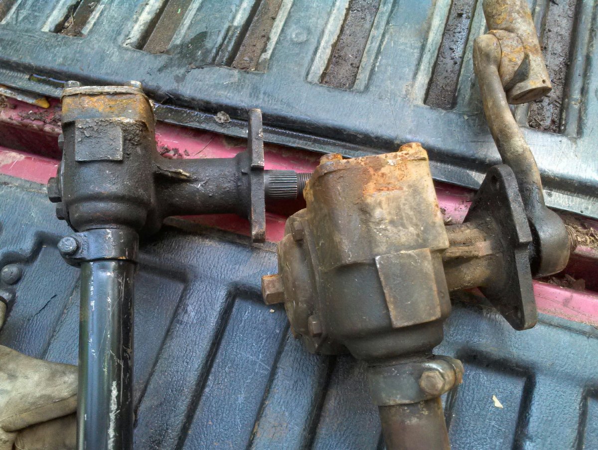

    I think the F-2 box is bigger. Here's a side-by-side pic that was posted in the parts for sale section a few weeks ago; according to the seller, the F-1 box is on the left (painted) the box on the right is F-2 (rusty).
    I saved the image because--presuming the seller's data is correct--the supposed F-1 box I bought at the Monroe swap meet a few months ago turns out to be F-2. But at $25 for box, column and wheel, I really can't complain.
    Here's a link to the ad--there's more pix: http://www.jalopyjournal.com/forum/threads/1948-1952-ford-truck-steering-box.987095/

    That box is not a F2! It's a F4 or larger. F1- F3 are the same. I,m the one bought that box. I wanted the larger for my modified. It takes a larger Pittman arm.
    ClarkH, 1928Fordman and bct like this.

    Thanks HD Driver, that is good to know. After seeing the parts info posted by fordfitrucknut, I was wondering if there wasn't something wrong with the description in that ad. Sorry, all, for bringing misinformation to the thread.
