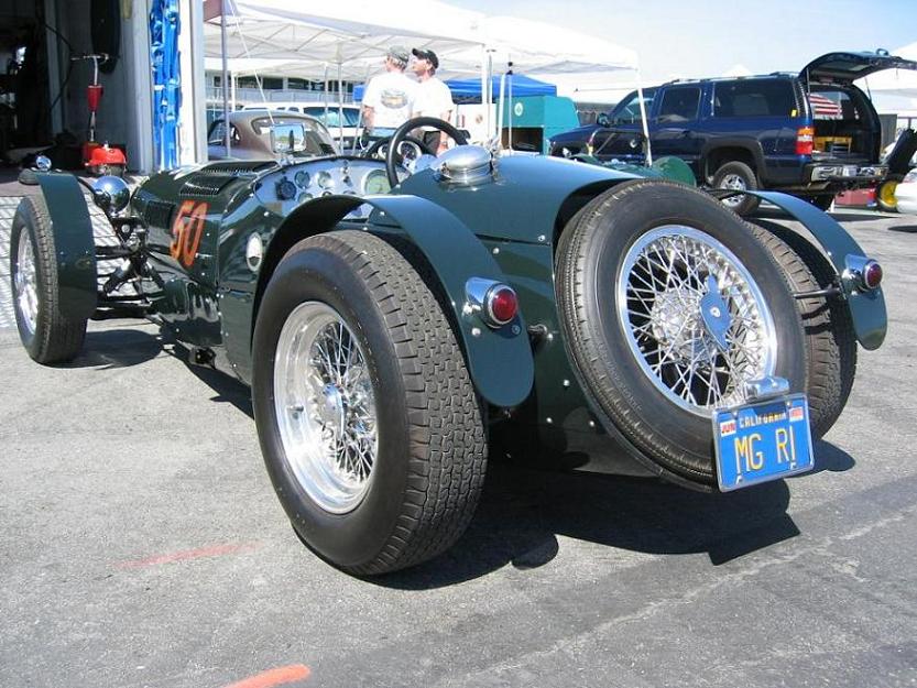

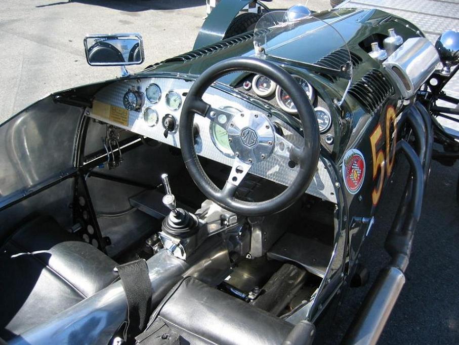

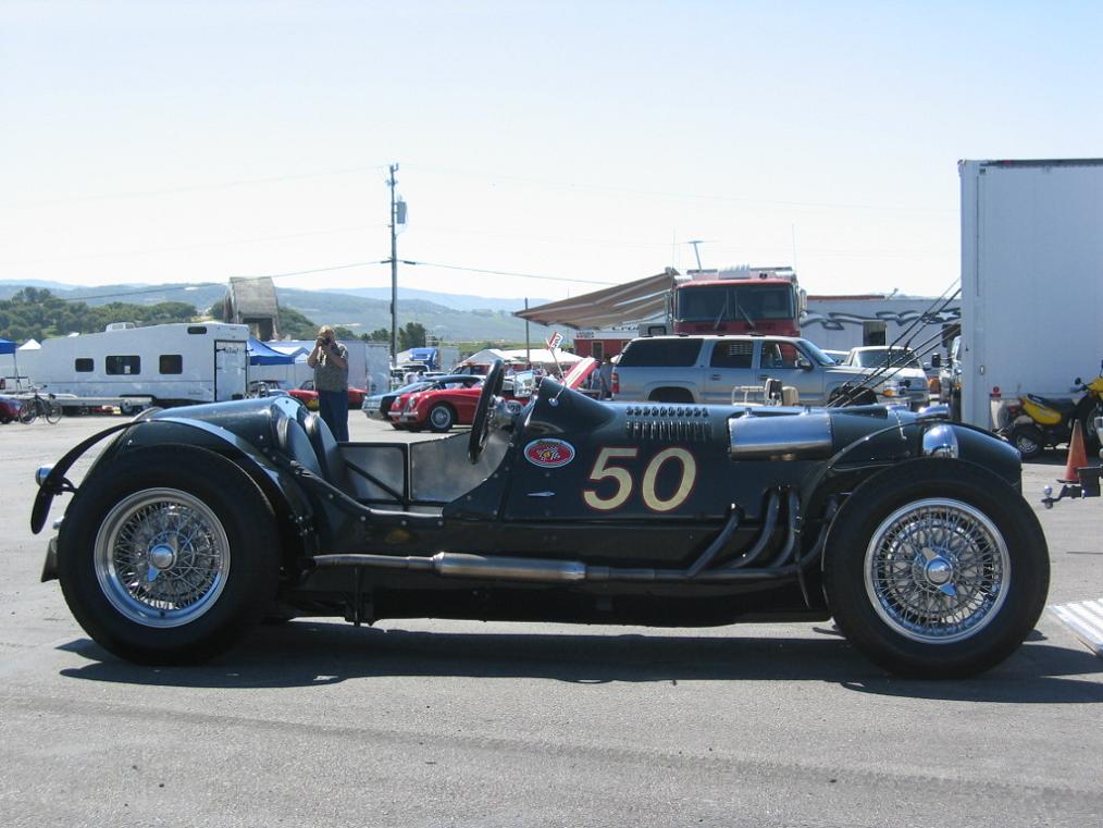

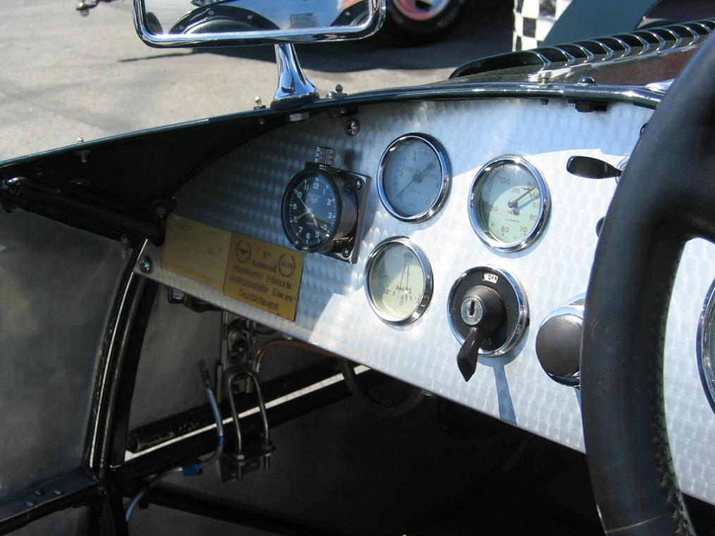

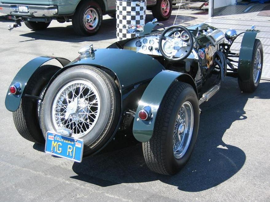

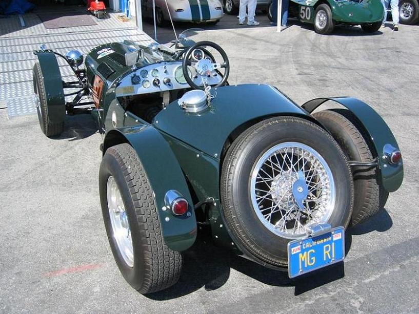

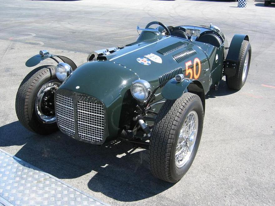

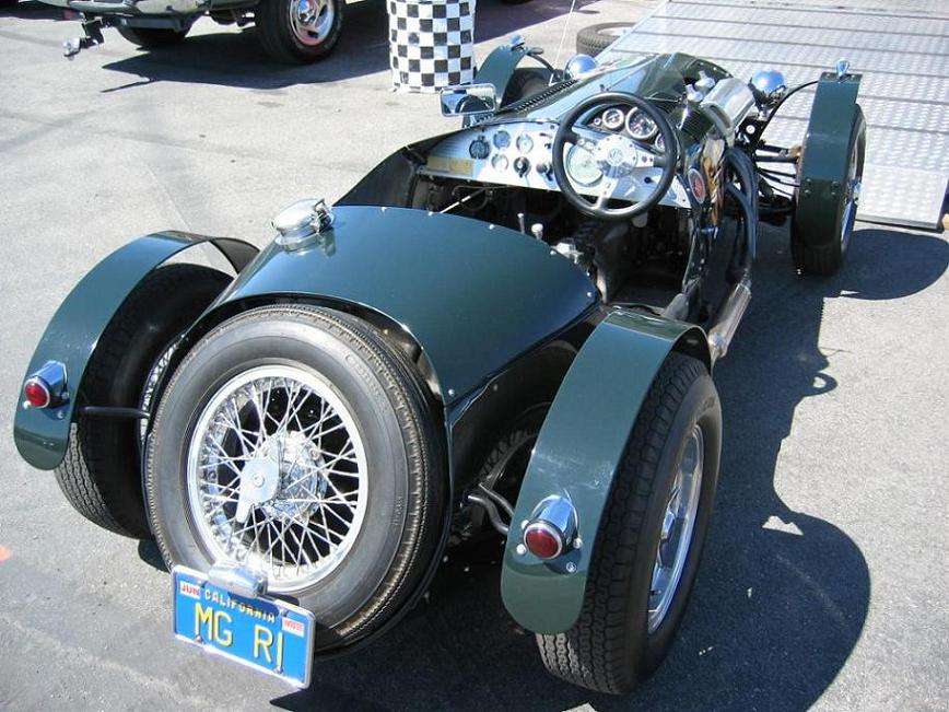

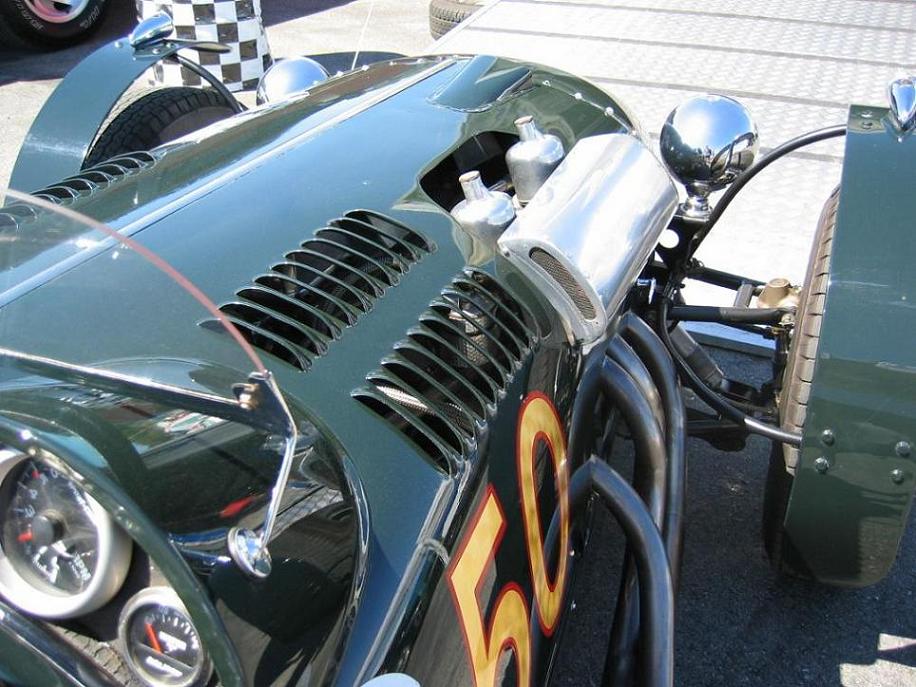

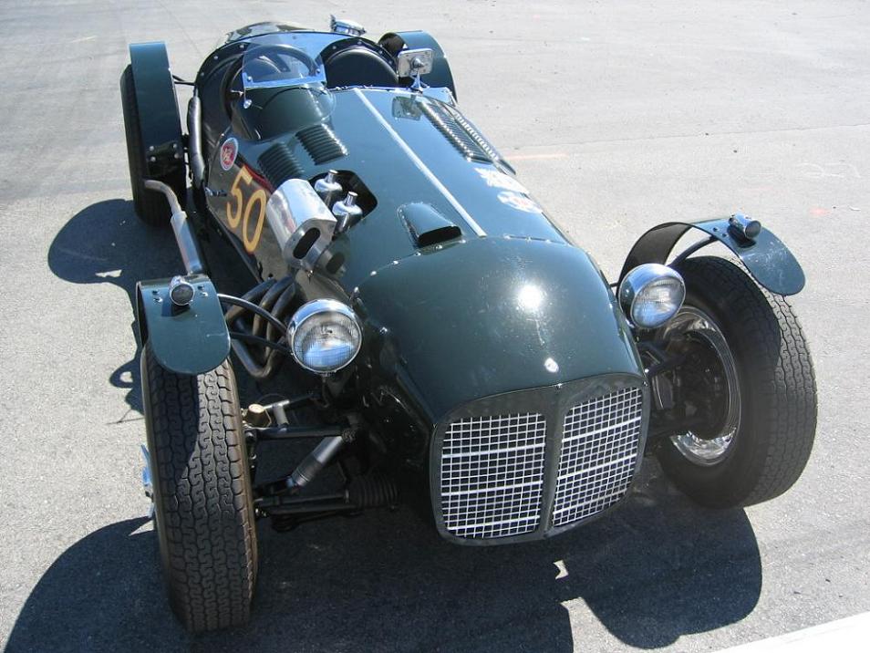

    The Ken Miles MG R1,...built in the early 50's and was a hot ticket in California sports car races of the day. Scratch built ch***is and body and used a TD engine, TC rear axle and Morris Minor front suspension,...a Hot Rod!
  15. torsion bars on a hot rod, never! here is his "flying shingle" (R2) great pictures, thanks for posting 'em. I see the R2 in the backround, any pictures of it?

  21. some specs etc...
    Ken Miles life came to a tragic end on August 17th, 1966 while driving a <NOBR>Ford[​IMG]</NOBR> J-car prototype. The car was traveling at 175 mph on a back-strech. Ken began preparing for a corner, slowing the vehicle down, but it went out of control and over an embankment. Ken was thrown from the car as it spun and went end-over-end. This tragedy brought an end to a brilliant career that began during the very early 1950s.
    Ken was born on November 1st of 1918 in Sutton Coldfield, England. During his early life he apprenticed at a British car manufacturer. During World War II, he worked in various duties that dealt with machinery and utilized his mechanical skills. He began motorcycle racing while in the service and this would continue after his tour. After World War II, he returned to the automobile industry and to automotive racing. He acquired a Frazer-Nash racer and installed a Ford V8-60 engine. It had mile success in local and club compe***ion.
    In 1952 he came to the United States where he accepted a position as service manager for an MG distributor in California. Later, he would became involved with a wide range of teams and races and have a profound influence on early American road racing. His skills as a driver and fabricator quickly evolved and he became legendary on the West Coast with his compe***ive Specials.
    Miles first racer that he constructed was in 1953, while working for Gough Industries. He had been racing MG TD's for Gough, but they were often outcl***ed by the compe***ion. Gough helped Miles with creating a racer, though he was unable to provide cash. What Gough did provide was use of any MG or Morris and any stock spare part.
    Miles began work on the R-1. The frame was created from mild steel tubing and attached to MG Series Y independent front suspension. The rear was comprised of a live axle. Alfin aluminum drum brakes with two-wheel cylinders were used to provide the stopping power while a Morris Minor rack-and-pinion kept the vehicle in the drivers control.
    Under the hood was an experimental racing engine that had a 1466cc displacement size. The engine would later be used by MG for their MG TF 1500. The engine had twin SU carburetors and a 10.5:1 initial compression ratio. The compression ratio was later increased to 11.6:1. The 83 <NOBR>horsepower[​IMG]</NOBR> engine was mated to a stock MG TD transmission which sent the power to the rear wheels.
    The car was clothed in a hand-formed aluminum body. The overall weight of the vehicle was less than 1,230 pounds.
    The car made its inaugural appearance in 1953 at a rainy Pebble Beach. The car had not been tested but this did not seem to matter, as it emerged victorious. Throughout the next year, the car would win all of the races it was entered, except for two. Its racing career came to an end in 1954 at Pebble Beach, when it suffered mechanical difficulties and failed to finish the race. The flywheel bolts fractures which allowed the flywheel to come loose. This resulted in the engine over-revving and it threw a rod. The R-1 Miles Special's racing career had come to an end.
