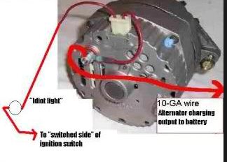

    get one of these altternators

    That IS NOT a one-wire alternator pictured. "One-wire" alternators have one connector where wire to battery is shown in pic and a black plug to close off the hole where the other two wires are shown in this pic. There are no connections for or wires to ignition or light. One 10 ga. (minimum) wire runs from that one pole (which is always hot)to starter lug or to battery positive. Charging begins above a certain RPM.
    This IS an alternator with an internal regulator.
