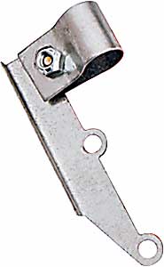

  14. Hitch, those pick-up tubes are meant to be used once and once only.
    The gizmo in the pic is a excellent alternative to welding. Be sure to Loc-Tite.
    Yes it is strongly recommended to use one of the 2 methods for securing the p/u.
    3/8" of an inch from bottom of pick-up screen to pan, TR
