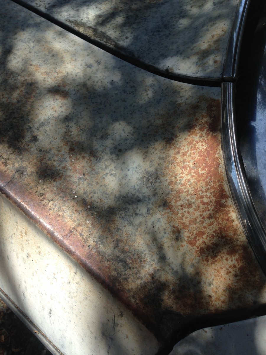

    speaking of rust in peace... ( my non hamb friendly 68.)
    time for some paint.
