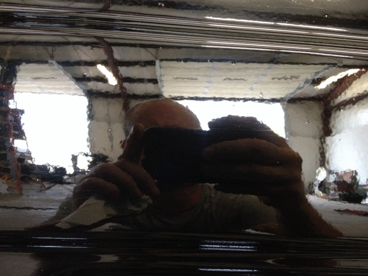

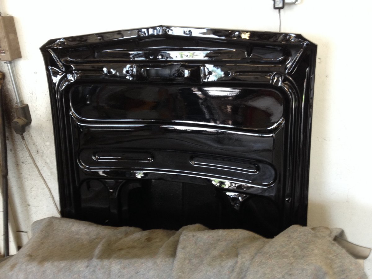

  15. Flyinhillbilly
    Joined: Jul 8, 2016
    Posts: 27
    Flyinhillbilly
    image.jpg image.jpg You guys are right on point.
    This is the bottom of the mustang hood that I was talking about, SS urethane, it has some peel, and dust, but most that see it in person are blown away. I could sand and polish that to a flawless finish, but since it's on the underside of a drag car hood I won't bother. It's "good enough"
  16. F&J
    Joined: Apr 5, 2007
    Posts: 13,291
    F&J
    You have shown what I was referring to on what a muscle car looked like when new, versus the way "some" people do things today.
    we all get sick of those "my friend did.." stories but :) ...a friend has a 67 Chevelle SS396 marina blue coupe. He wanted a new one back then, but had to wait 30 years. He bought two exceptional matching 67 marina blue survivors to pick the best one for a show restore. That was just before the Marque-Specific national shows started to clamp down on over-restored.
    He only goes to a random cruise, and refused to bring it to a national Chevelle event on the year it was held somewhat in our area. He explained it just looks so wrong under the hood and even in the rear wheel wells, and didn't want to face the critics. A wet look everywhere, to the point of looking gaudy. Looks fantasic to most onlookers, though...

  17. 0NE BAD 51 MERC
    Joined: Nov 12, 2010
    Posts: 1,810
    0NE BAD 51 MERC
    Even I won't buff the under side of a hood! If its that bad its sand, clean and refinish time! Had a friend do the frame and bottom side of a 51 Merc once, Insane! That's Riddler award country and I don't go there! But again as far as the OP, acrylic enamel is a good paint, especially if your looking for the original look. Using the right speed reducers and hardner's will give you a smooth as a baby's **** finish and if you do not get a bunch of environmental fall out in it ,you do not need to buff. But when you charge people for it they expect perfect ! Even if they say they do not! Larry
