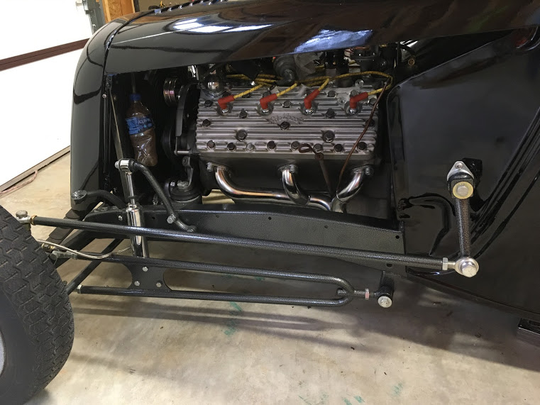

    So now we are sideways, and now I am debating the way forward. I dont have much clearance between the 5" channel and the headers.
    So the three options I can see that might fit are
    1) keep the side steering design, but will have to cut out part of the fully boxed frame, may have issues with clearance. F1 box? I like it would look more traditional, and the lease redesign of the existing setup.
    2) vega box, less intrusive frame mods, looks like easier steering shaft route, have to add a panhard rod with cross steer.
    3) uni-steer "half rack" kit. Most room, shaft similar to vega box, least traditional looking but likly drive the best. Also require panhard rod, and new steering spindle mount.
    https://www.unisteer.com/products/1928-32-ford-cross-steer®-retro-fit-w-no-mounting-holes-in-bracket
    Open for ideas, pictures a plus.

    The top of the pitman arm that tensions the collar looks brazed on, and has some pits/imperfections in it when you look at the closeup. It's highly questionable not only from a materials perspective, but also the transfer of all of that force through a single keyway. Every cowl steering setup I've seen uses a splined shaft attached the corresponding pitman arm, transferring that force around the whole shaft, not just concentrating the load in one spot.
    Most of the Hilton cars are cowl steering, and are driven all over the country without issue. I'm pretty sure they use a Schroeder box of some variety. I'm sure someone here can elaborate. But they seem to have a solid formula in terms of parts selection and ch***is setup that is both safe and reliable.

    I wouldn't trust the 'spacers' on the drag link arms either. On the top arm too. Just because you can do things to join A to B, doesn't make it a good idea.

    Not to beat a dead horse, I think you're already set to redesign the steering, but after seeing this larger view photo this only emphasizes the need to redo things. The added scrub radius on that front end with the finned drums and offset wheels will add even more leverage against that pitman arm. So yeah, time to rethink things.
    I'm a fan of side steering for a couple of reasons, first it just seems more traditional looking to me. Beyond that, if you go with a Vega box and cross steering you should add a panhard bar up front, or a dead (or deadman) perch, because the cross steer setup is going to put sideway forces on the axle that are not there with side steering. Location of the box can be a puzzle. The W engine doesn't leave a lot of room to work with.
    You could retain the cowl steering, acknowledging the potential for bump steer, but the problem you have besides the pitman arm is the non-splined pitman shaft. That smooth keyed shaft has got to go.
    Something that might help you locate the box, whether side steer of cross steer, is the Steer Clear steering box drop.
