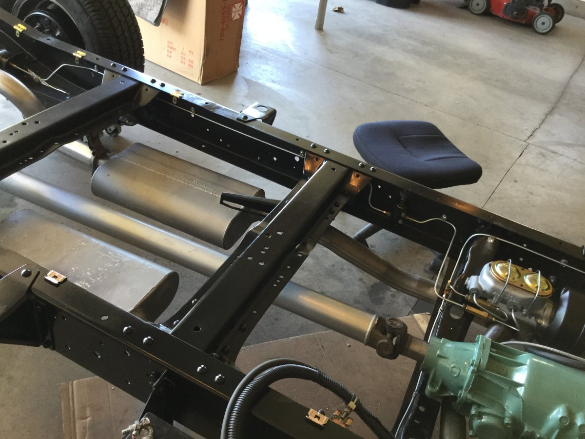

  13. iwanaflattie
    Joined: May 14, 2011
    Posts: 4,330
    iwanaflattie
    Anymore pics of your frame?
    That is beautiful
