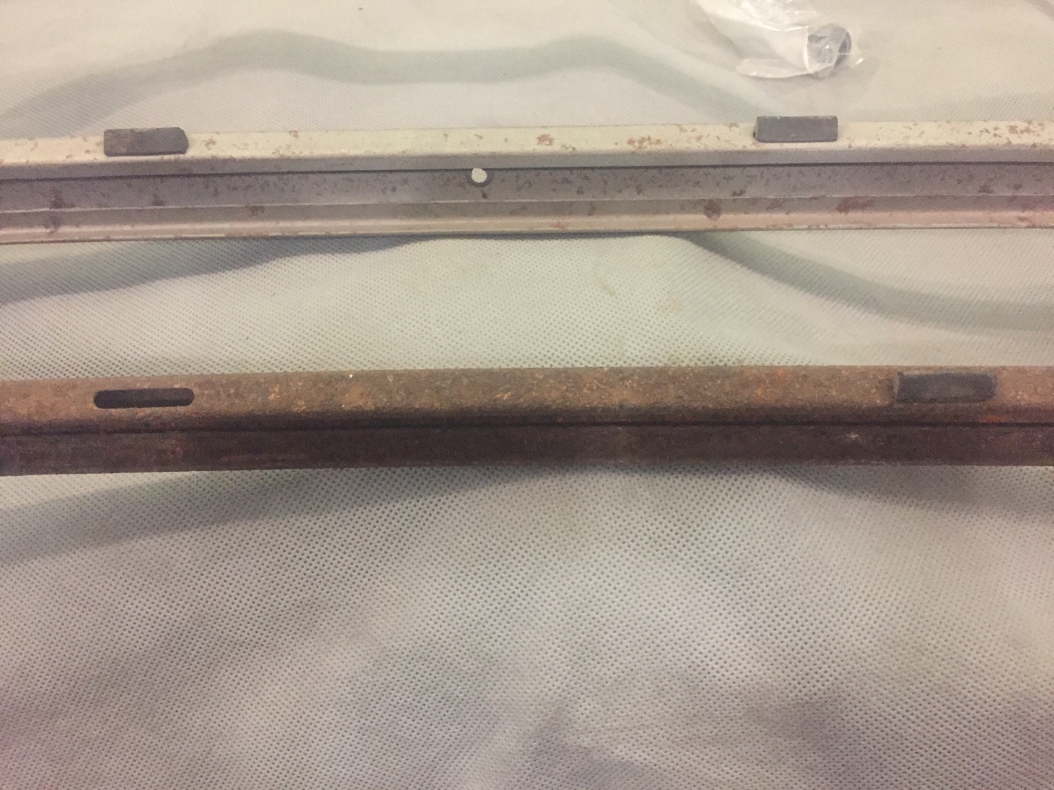

    Due to the roll down window; coupe moldings have slots for rubber bumpers; easy way to be sure the guy at the swap ain't pulling your leg.

    [​IMG][​IMG]
    These are what Rich is talking about and on the bottom to each side of the center screw hole
  16. there are some 35/36coupes without a roll down rear window...would it have the bumper slots too?
    i have seen two coupes with fixed rear windows , one belonged to a friend
  17. RICH B
    Joined: Feb 7, 2007
    Posts: 5,957
    RICH B
    One of the 35-36 experts on the Ford Barn said the fixed window coupes also had the slots; only one listed part number for a coupe rear molding.
