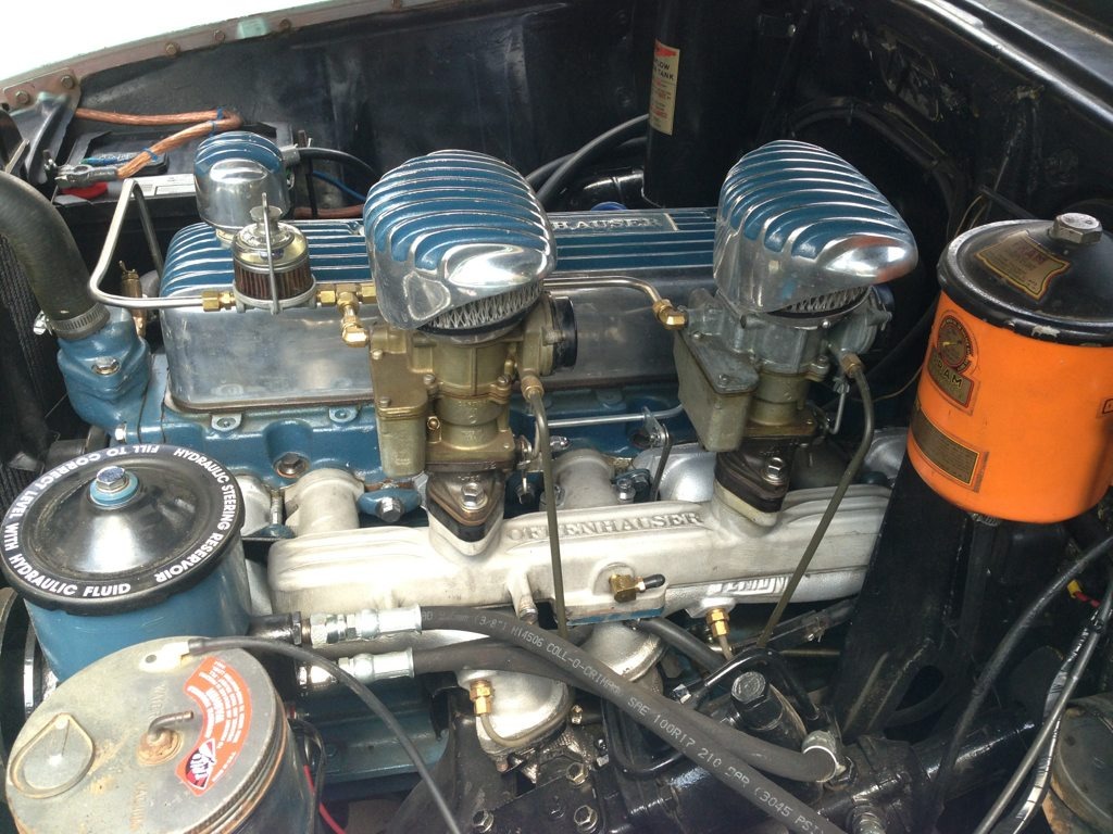

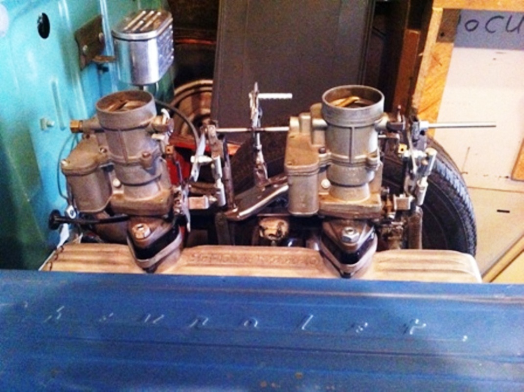

    ImageUploadedByH.A.M.B.1378063994.478247.jpg ImageUploadedByH.A.M.B.1378064018.566942.jpg ImageUploadedByH.A.M.B.1378064034.950160.jpg
    Carter yf's
