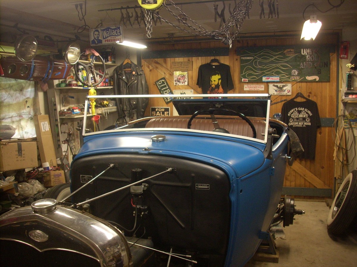

    bangerbob
    Not chopped--just laid back. A 2 inch chop would have been to much. ModA 531.jpg

    My "old" roadster ( sold) stock height and 4" chopped WS. I loved the way the lowered one looked, but the seat needed to be dropped too.
    I mocked up the chopped one with 3/4" aluminum angle iron to see how it looked
    EVL401 likes this.

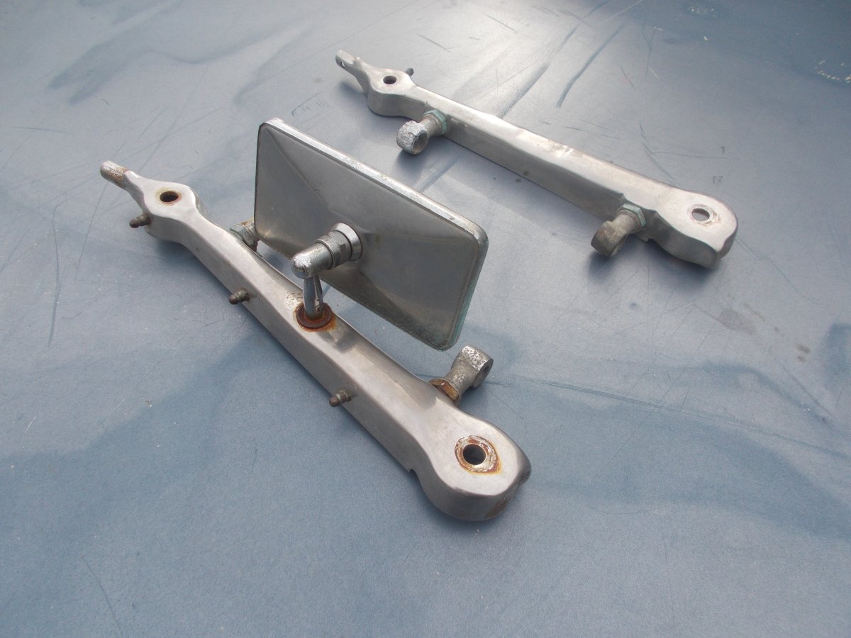

    Might have missed it's post,
    But a deluxe '30 '31 roadster's windshield is chopped over an inch compared to a standard roadster's W/S from the factory...
    Got a pair of deluxe stantions today at the Topsham, Me. swap meet... $75 pr.... and a couple of new 16" inner tubes for a fin each...
    Neat how a frugal tiquer cut and threaded a mirror's shaft and screwed it into the stantion ... DSCN0569.JPG
