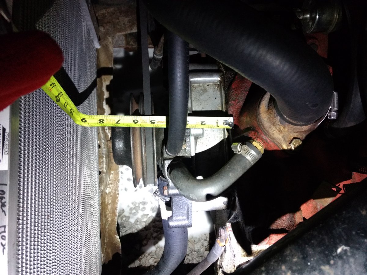

  9. Burkedore
    Joined: Nov 9, 2013
    Posts: 146
    Burkedore
    Darn it squirrel, I forgot that part. Anyway, from the block to fan mounting surface is 7-1/2".
    Budget36 likes this.

  12. Burkedore
    Joined: Nov 9, 2013
    Posts: 146
    Burkedore
    Yes my engine is a 66

  14. Burkedore
    Joined: Nov 9, 2013
    Posts: 146
    Burkedore
    Squirrel, you have gotten my engine, (66 poly pictured above) confused with the op Budget36s' 1970s era 318.
    Mixup non withstanding your information is spot on.
    Budget36 and squirrel like this.
