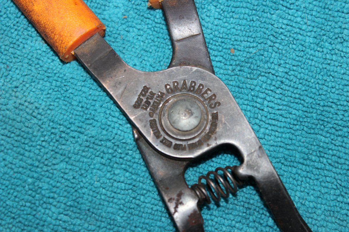

  15. I still managed to destroy a plug boot on a OT GM even with one of those types of plug wire tools and it was a good quality tool. The plug wires were OEM too. There's not much room between the headers and heat shields on a SBC to get anything to get those boots off the plugs if they're stuck.
  16. HellsHotRods
    Joined: Jul 24, 2009
    Posts: 1,425
    HellsHotRods
  17. Blues4U
    Joined: Oct 1, 2015
    Posts: 8,058
    Blues4U
    from So Cal
    It shouldn't be that difficult.

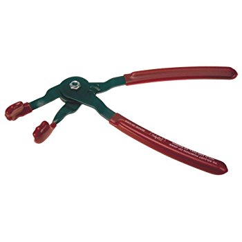

  18. That tool doesn't have ahold of the part that's stuck. It's all the way out to the end of the boot...where the heat is.
    They make a tool that kinda works. I had one when I was doing tune ups on 454 trucks.
    It's shaped like a two fingered fork at a 90 that goes all the way down in to where it is stuck. Still , I had to shave it down so it could clear the heat shield collars. Still have to pull like hell.

    These work and work as Mark Yak suggested in post 18. I can't remember where I found them but snagged the when I saw them. Looking at the handle they are Matco

  21. X 2 on post #19. They pull from under the stuck on rubber boot to take a lot of stress off the crimped terminal. Very nice tool to have especially if you're planning to reuse the plug wires.
