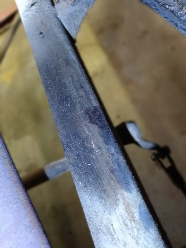

    also stamped on the frame rail, pass side, visible when you remove the floorboard. This is a 27. Not sure what year they started doing this

    #'s on the frame started in late 25 if I remember correct.

    A DMV professional told me, as he was looking in his VIN bible, that Ford started stamping the serial number on the frame as well as engine sometime during the 1926 year. He could not find the number on my frame though.

    I find that late '26 with the rear crossmember that has the lower reinforcement "lips" is about when they got numbers stamped on frame. If the rear crossmember is a simple channel, then probably doesn't have numbers on frame.
