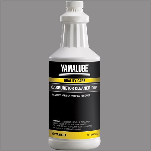

    I usually just use aerosol Carb and Choke cleaner (whatever brand is on sale), trimmed acid brushes and lots of patience. Most of the currently available EPA certified dips have been a waste of $$. Gonna look into that Yama - dip though.
