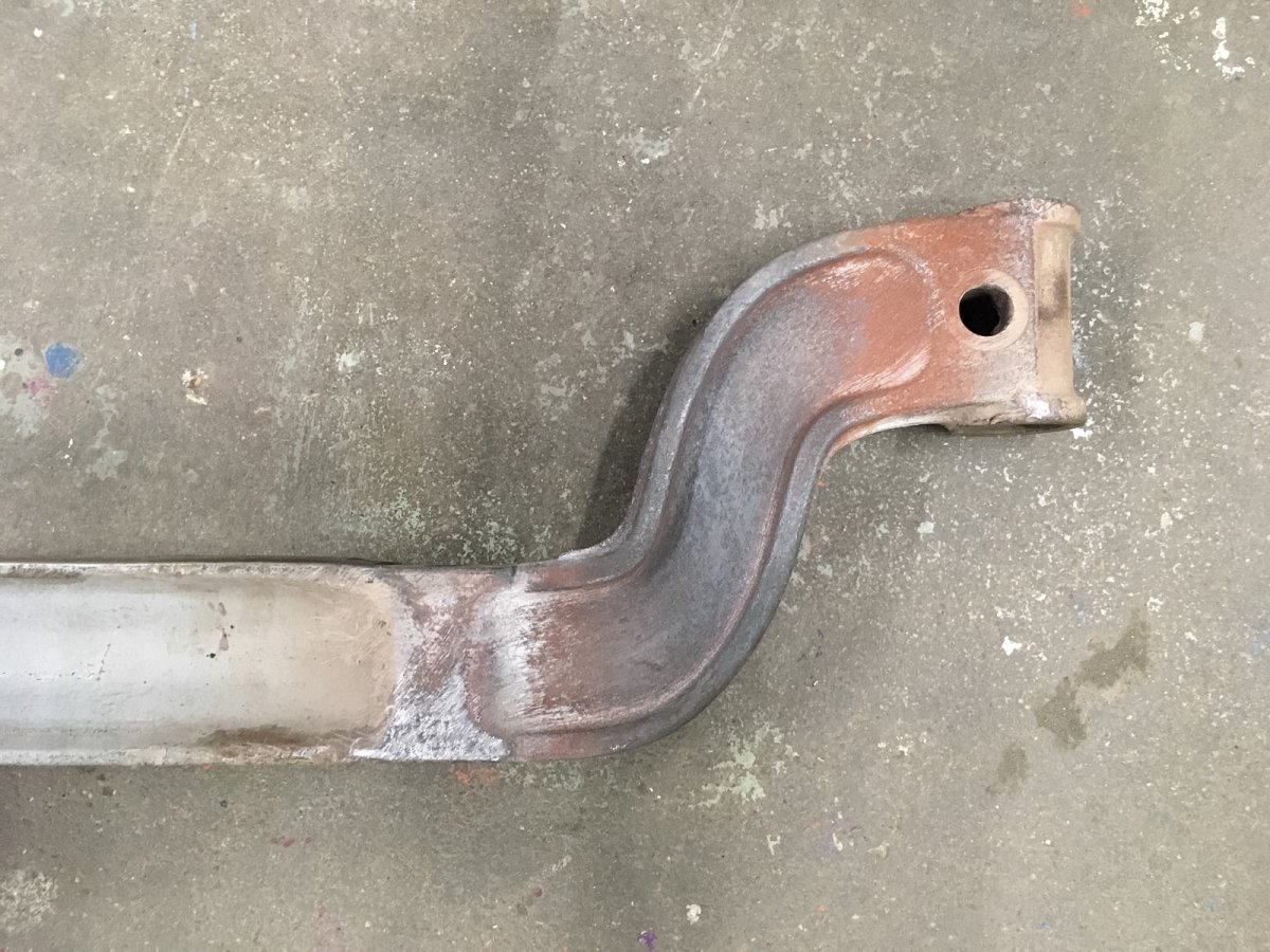

  20. Just Gary
    Joined: Oct 9, 2002
    Posts: 5,813
    Just Gary
    Jack did a beautiful job on my '33-'36 axle. See how smooth the curves are?:cool:
    Afterwards, I drilled and chromed it.
