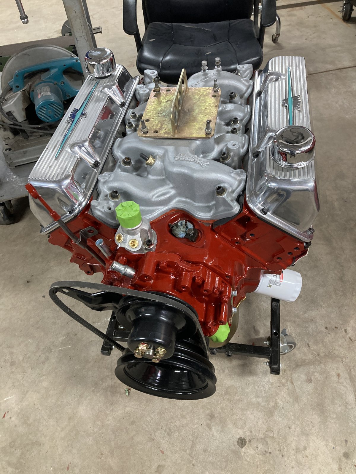

  13. klawockvet
    Joined: May 1, 2012
    Posts: 620
    klawockvet
    IMG_0662.JPG I used Eastwood's engine paint on my 351. I brushed it on and it flowed together nicely.
    I liked the way it looked with the red so I tried the aluminum on the manifold to make it easier to keep clean as it was really rough. The paint smoothed out the roughness and it's easy to clean.
    Its not like polished aluminum but I'm satisfied with the results.

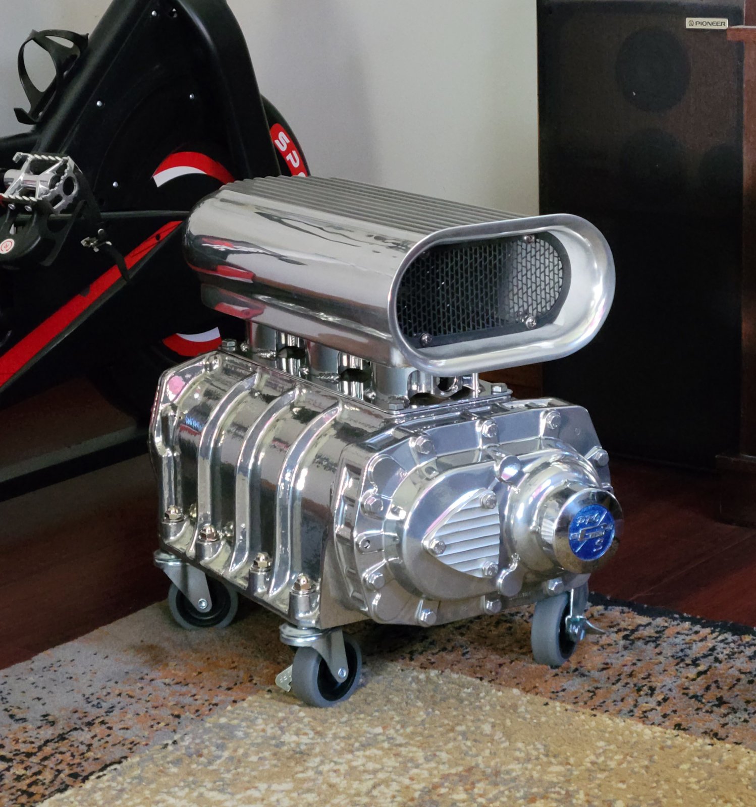

  17. swade41
    Joined: Apr 6, 2004
    Posts: 14,507
    swade41
    from Buffalo,NY
    Blower is non cleared chrome powdercoat, the scoop is polished aluminum, I'm happy with it.

  22. jimmy six
    Joined: Mar 21, 2006
    Posts: 17,098
    jimmy six
    Hard to believe that’s brushed on engine paint on the intake. Looks great. I did one Edelbrock intake removing it and the part number and reblasting where it was removed. Looked like raw as manufactured but would have been nice to coat/paint.
    Budget36 likes this.
  23. Bandit Billy
    Joined: Sep 16, 2014
    Posts: 16,060
    Bandit Billy
    Moi? I have to be finger printed every couple of years for my licensing and they can have a devil of a time using the scanner bed, usually have to the ink pad thing and all due to polish-lust.
    An intake with the heat cross over blocked doesn't get that hot. Mopars and Pontiacs with a valley pan, they stay even cooler. I chromed an air gap for a camaro 396 I built that looked perfect when I sold the car 10 years later. I have polished several manifolds myself, it takes a couple days and a lot of materials to make it look decent. Plus the annual maintenance with mother's or Flitz.
    That blower case looks sick! You sure those casters will hold up to the HP? Maybe cost $200? Maybe less? $1000 to polish it, depending on the finish going in. $600 or so to chrome it, my price from a buddy. I'd powder it for those results and the price.

  28. As mentioned above, I would shy away from it on an intake because of the heat factor. That blower case looks amazing & will probably last a long time being a little higher with air flowing across it.
