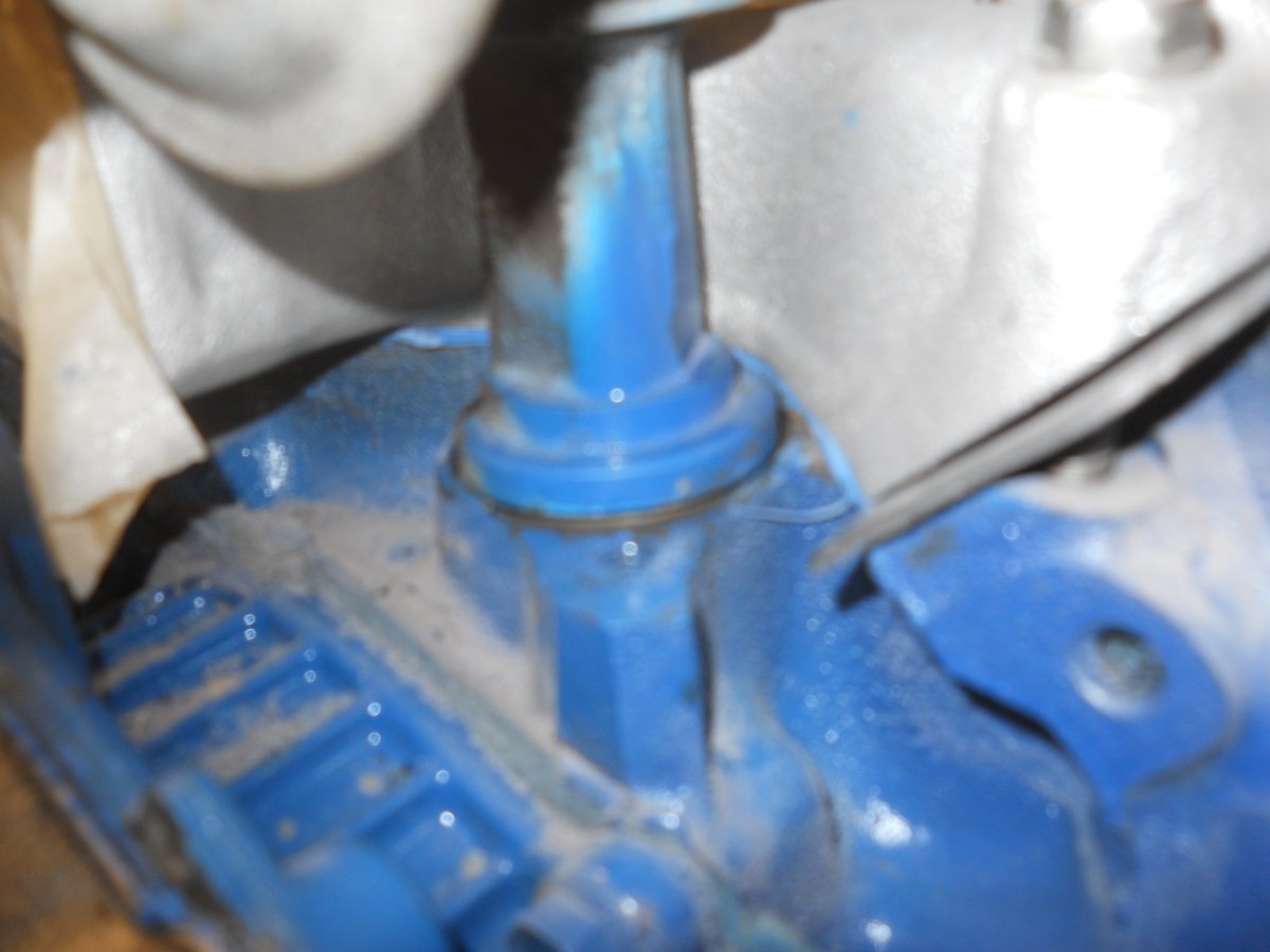

    OK, here's a pic. I wasn't paying attention when I took the dizzy out, so I don't know if the gap was there all along or not. The gear is engaged, and so is the drive hex., but the machined surface on the bottom of the distributor will not contact the block. I'm pretty sure it should, or when I tighten down the clamp it may put a bind on sumpin' There is an o ring on the distributor body so I'm not really worried about it shooting out oil.

    Is that the original distributor? Ford changed the length of the distributor shaft in 1987 and if you use a 87-95 dist with the early oil pump drive it is too long.
  11. Don is correct.
    Yes you should have a gasket but your distributer should still set down even without the gasket.

    Thanks for all the input. I'm pretty sure that's the original distributor, but I bought the engine used. I measured the length, and it is 4 inches as squirrel indicated. I'll go screw with it some more and see if I can get it down. It just doesn't seem right.

    The 289 doesn't use a gasket under the distributor. The o-ring on the housing seals the base of the distributor to the block. The distributor seal shown above is used on Fords where the distributor goes through the intake. The small block distributor goes directly in the block and does not use that seal.
    The hex inside the distributor shaft could be ******ed up a bit or the shaft itself could even be twisted and not let the distributor go down all the way.

    hotroddon
    Yep, the only place I've seen the big tapered one used is in manifold or Valley pan applications as well. Definitely not on any 221-302 that I've worked on in the past 45 years!
