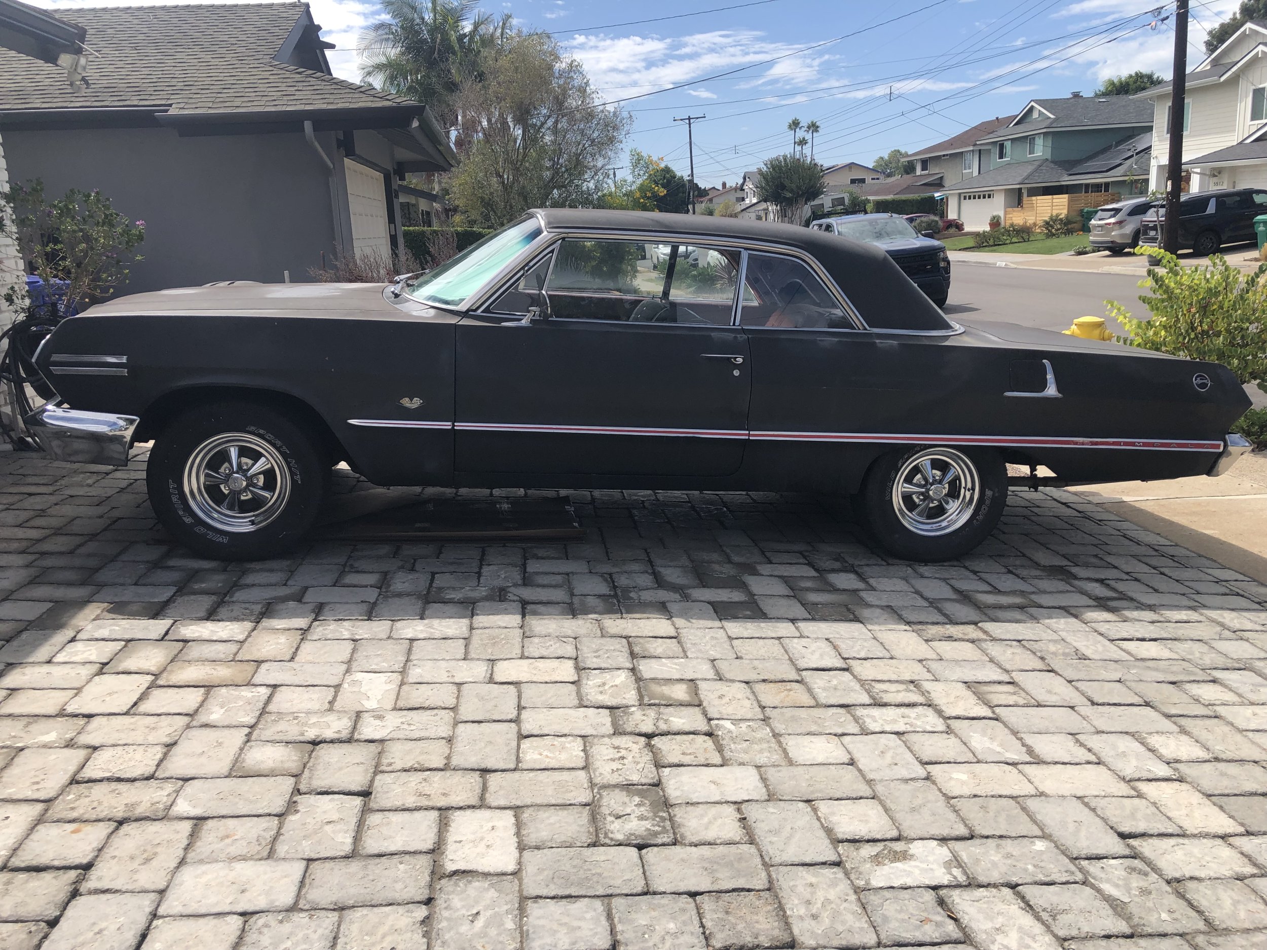

    IMG_8538.jpeg IMG_8537.jpeg Hey guys I just put a new front suspension and bushings, tie rods, etc.. I took it to get it aligned and the shop said the coils were too tall. I said just do the alignment the way it is.
    From these photos do you guys think it’s too high? I’m thinking of cutting off 1 coil.
    Thanks

    Yes, too high. But let it settle for awhile, then take another look.

    That would be a YES!

    Yes it is if the engine is still under the hood. I think it has the wrong coil springs.

    If it just had the front end worked on, I'd say it was tightened up before being set on the ground and the rubber is all bound up.

    It has the engine. It was tightened on the ground. I bought the coils off rock auto for this year and model. They’re moog spring coils. I compared them to the stock ones and they were the same height. It did sit high before so I don’t know. I’m not spend more money for springs since I’ve got a cut off wheel and can remove a coil for a 2” drop.
