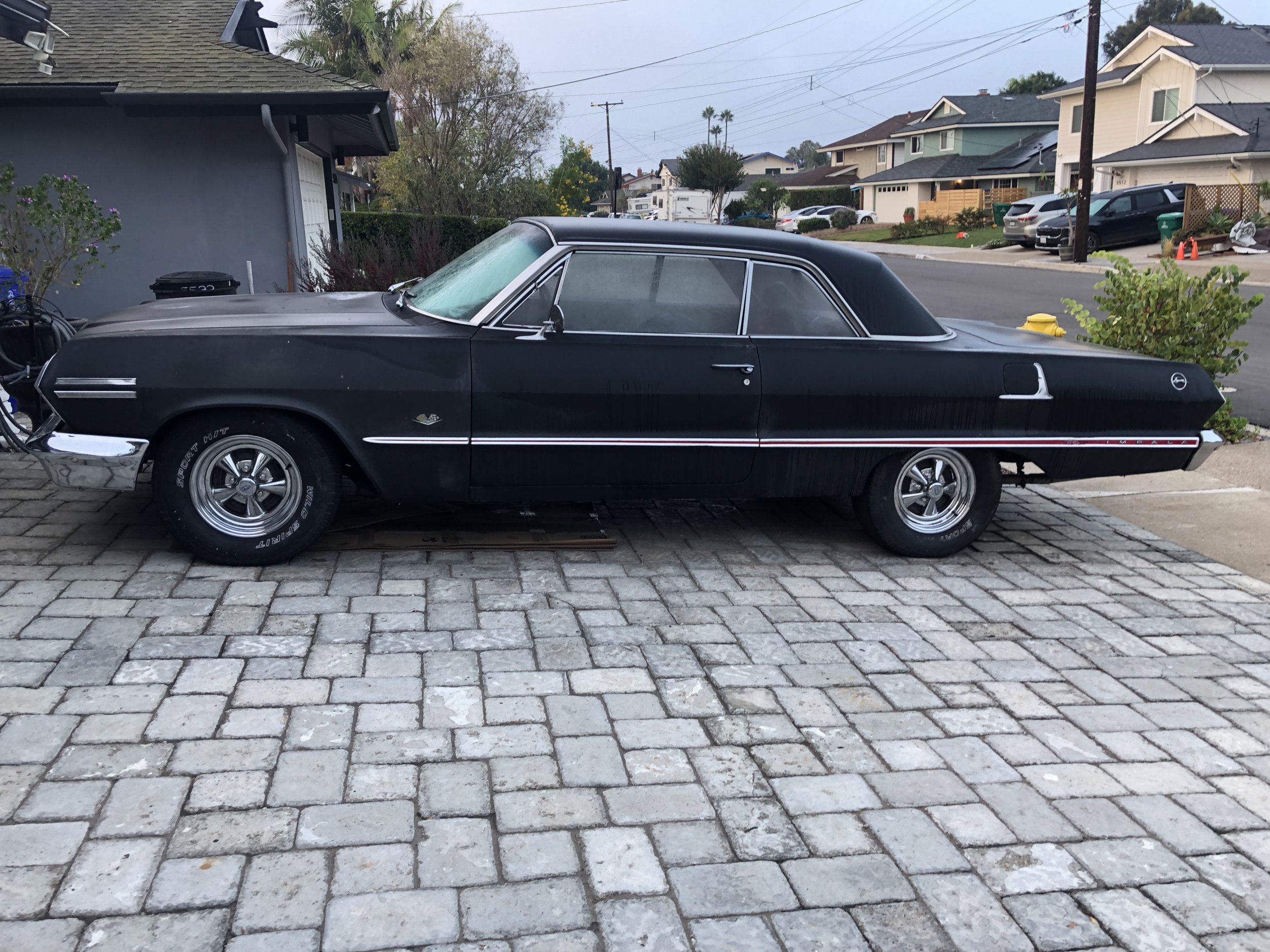

Technical Is this ‘63 Impala too high

    If you cut the springs in half it might sit right… of course the rear would need to come down ~10”.

    So I ditched those moog springs are cut one coil off the original springs. Looks normal and rides better. Yeah stay away from moog springs. Post pics tomorrow

    I took 2 coils out of my '66 Belair springs. I got them from Rock Auto, name brand.
    The wire diameter was a little bigger than the stock ones, that could do it. 20250608_093817.jpg We tried one side. It was way too high.

    Those MOOG springs were the right part number from what I recall when you were installing them. People here warned you that something was wrong at the time of initial install by your description that you were struggling to get them in with the car otherwise at full weight. It's always easier to sort out bad parts the first time.
    Now that you've changed springs and ride height it needs an alignment again.
    Did they ride stiff too? I've got a set of Moog springs waiting to go in my 62 Chevy. Generally, Moog stuff is very good. Maybe a mistake was made on that batch or part number.

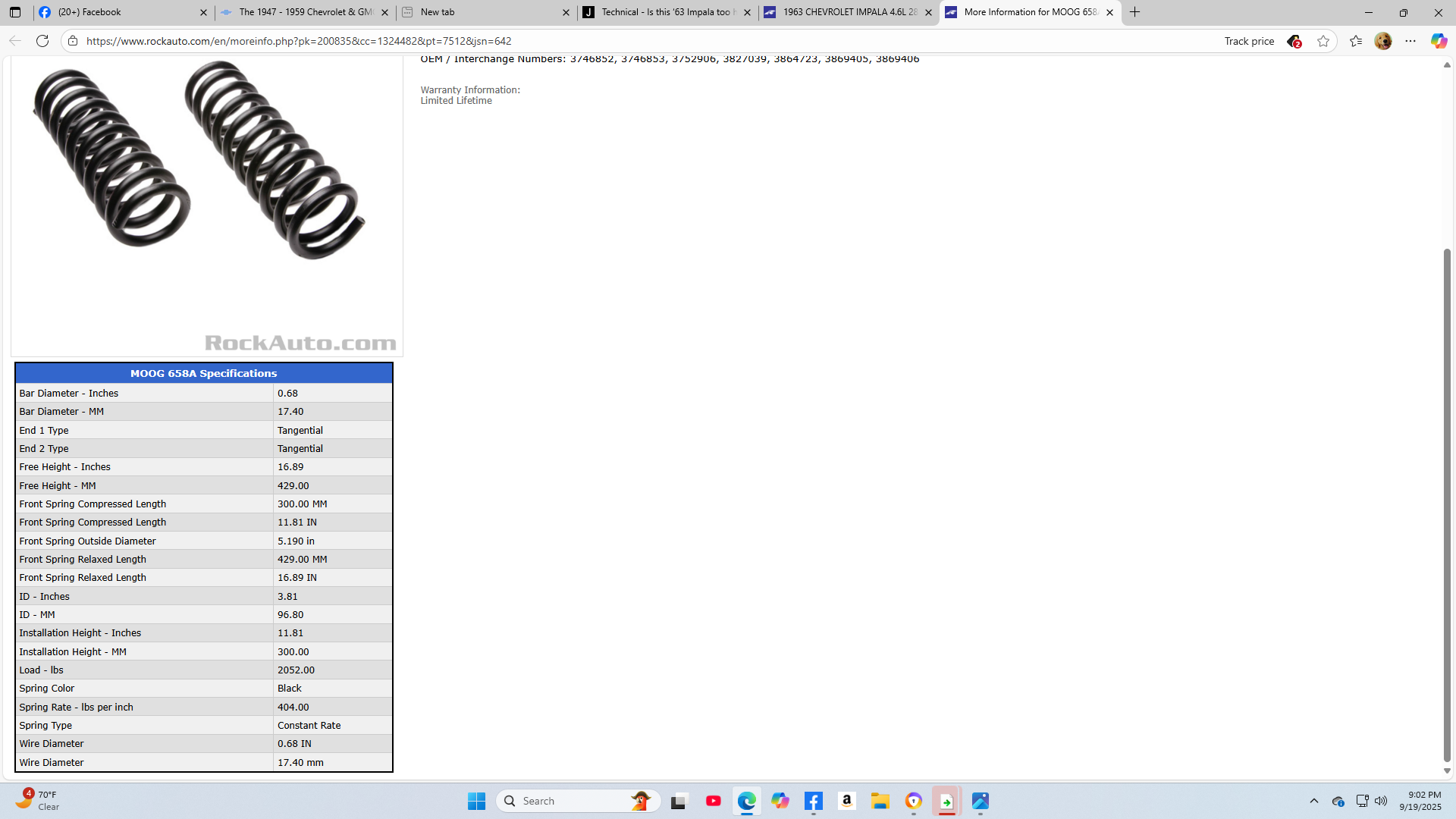

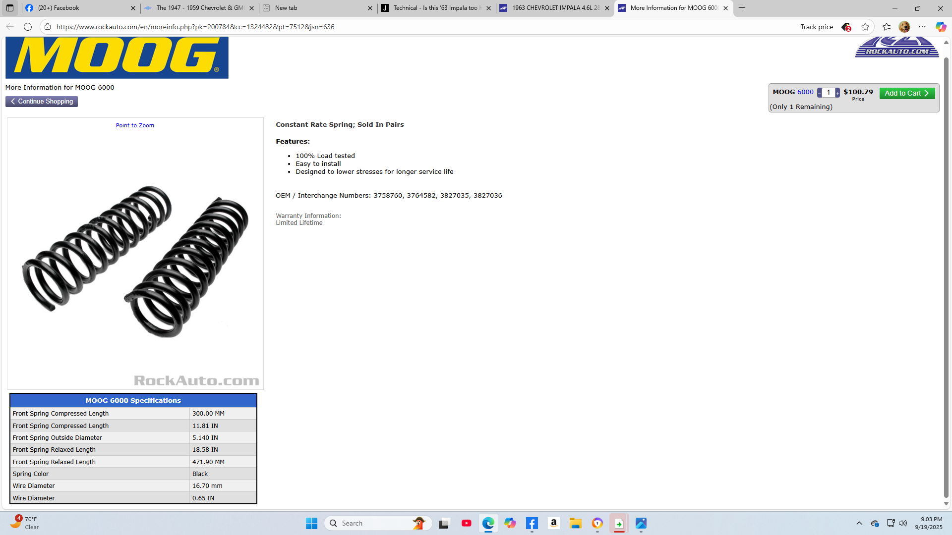

    Which part number did you use?
    6000, 6084, or 658A?
    Measure the free height of the spring as well as the wire diameter.

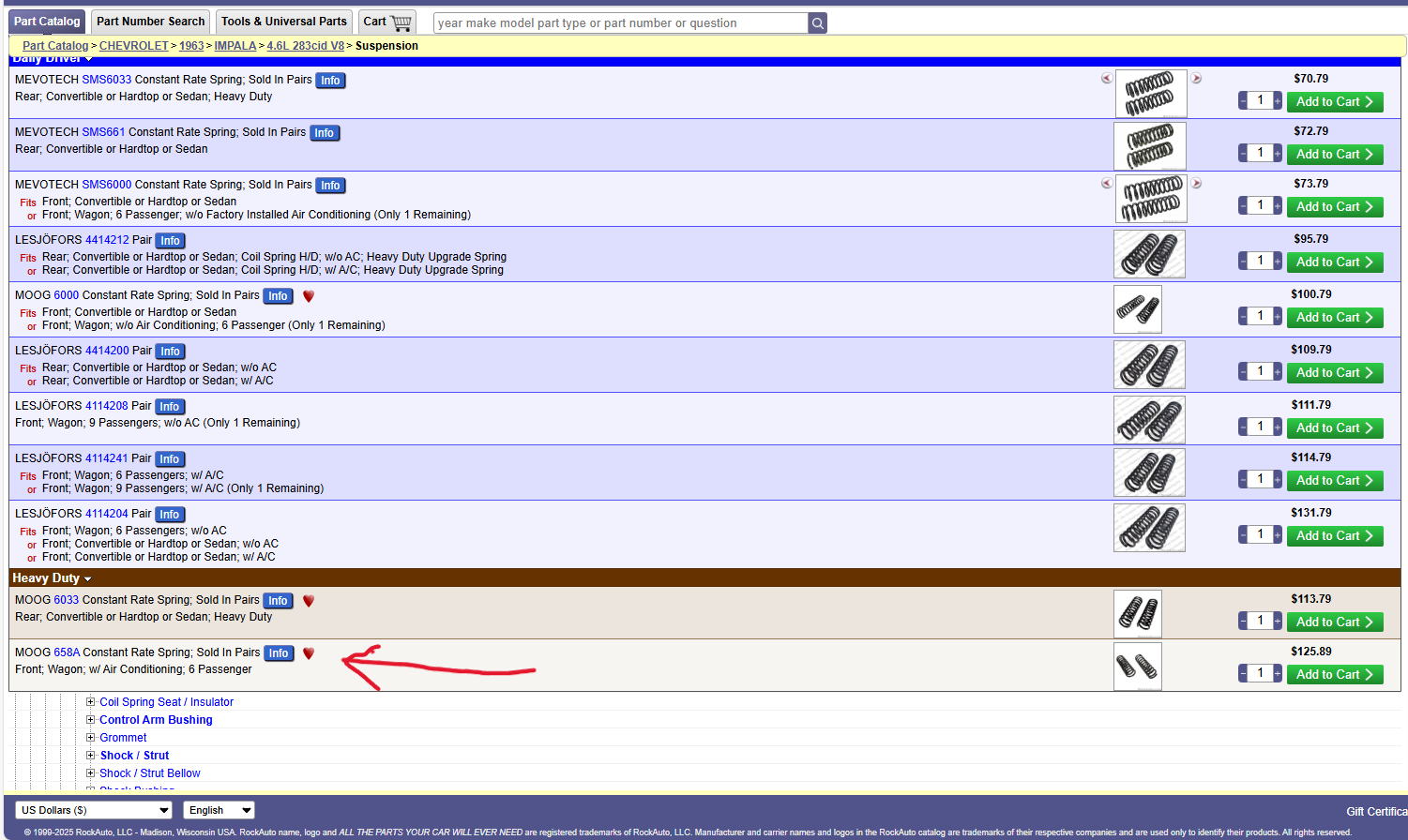

    Rock Auto shows a couple of choices for Moog springs for 63 small block Impalas A 658A in the heavy duty side for 9 p***enger wagons with air. or a 6000 for converts, hardtops or sedans without air .
    Are you sure that you don't have the station wagon springs?
    Back in the 60's when the jacked up in the front look was the hot lick it was common for guys with those Chevys to install a set of station wagon springs to lift the front end up but not use spacers or other nonsense. Screenshot (968).png Screenshot (969).png Screenshot (970).png

  26. I am sure I am late to the party I see you replaced the rebuilt the front end and replaced the springs did you do replace or rebuild any part of the rear suspension?
    If not, the front end may not be high the rear end might be low (sagged)

    In my opinion the question should be "is this too low?" And the answer is always no.
    Even after you cut a coil, it sits too high for my preference. Cut another coil.
