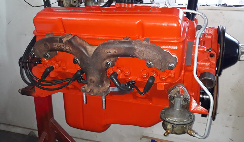

    Here’s some pics

    That block number is a 56-67 283. No side mounts make it early. CE stamping means Counter Engine, CE8**** means 1968. Kinda odd to me that a replacement engine sold in 68 wouldn’t have used the later side mount casting. But that’s what I come up with. Those heads won’t make much low rpm power.
    Edit: now that you’ve added pics, it has side mounts, just not machined. So yeah, 68 Counter Engine

    What are these? [they are side mount bosses]
    1957 Blocks have the casting number 3731548 and can be either 265 or 283 [they were bored extra at the factory]
    Here is a correct 3731548 block , there is no bosses to drill for side mounts
    57's had "Banana Shields" for the plug wires that went behind the Ramshorn exhaust , and do not fit onto blocks with side mounts.

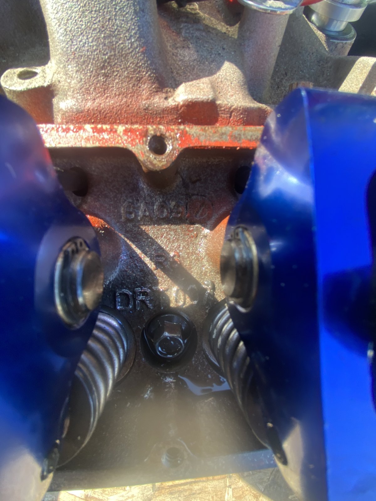

    That’s not his casting number. His is 3932338

    Man there is a ton of miss information on the web. Several sites indicate that 3932338 casting number is 56-67 283. On the bell housing flange just right of that casting number is? a casting date 4 digit code. Might shed some light. Side mount casting detail, not drilled, maybe middle of those years?
    Stamped 3 letter suffix is a more specific indicator, but with that missing on this block with the CE prefix gives credence to the previously stated over the counter or replacement type origin. With the rocker covers off, a degree wheel and dial indicator you can get pretty accurate cam specs. Billet rockers, while not definitive do indicate the intensions of the builder. With a wrench on the lifter nuts you can tell if the lifters are hydraulic or solid. If they are solid you will want to gap them properly. A bore scope in the spark plug hole will get a good look at the piston face, domed = high compression. Dart heads are another indicator of builder intensions.

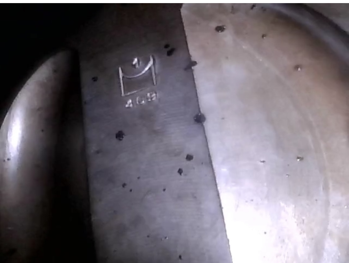

    Pulled the plugs and rotated it. Looks to be flat top pistons with reliefs. When I get more time, I’ll see if I can’t get a rough idea of the cam and kind of see if I can get a ballpark idea of what is going on. Didn’t really want to tear it apart, but if I have to, I guess I’ll be out a gasket set worst case. Maybe I can recoup the loss selling the power glide? Like Mr48Chev said, the pre-previous owner put some money into it. Hate to think the or-previous owner was just throwing parts at it just to throw parts at or for the kewl factor

    The engine was just ***embled and painted
    If you can come up with a better way to mask the plug holes please feel free to post a "How-To" in the tech section
    Even the fuel pump in the photo was incorrect , it was a 65 model used to trial fit the hard fuel lines
    Spray painting everything in sight , is more "historically correct" than the pedantic period correct restorations on "Show Queens"
    He is a photo of some 57 engines taken at GM [note no side mounts]
    These Engines are "F" Code 283's [2 Barrel Auto Trans] upload_2023-5-28_12-15-9.png
    57 Chevy's with 265 Engines [same 3731548 casting] were painted in calf-**** yellow [Chartreuse]
    And were only available with 2 Barrel with manual trans [with O/D and H/D clutch options]
    @badshifter The 265 codes were C , CD , and CE [CE was 265 2 Barrel with H/D Clutch, not "counter engine"]
    But Folklore and Legend can distort this on Craigslist [CE now means "Corvette Engine" ]
    The 3932338 Casting number should be 1962 - 67 283 These engines have a "scalloped lower bore" that can accept a 327 crank without crank clearance issues. [early 283's cannot]

    @$500 I’m not upset about the purchase by any means. The cam is very mild, I ***ume, but I’ll look into that. The numbers and lack of drilled side mounts were of some concern but the date code confirms 68’ like bad shifter had pointed out. I was just surprised such large heads were put on a 283 and was a little worried considering. I’ll get it up on a stand an start playing with it a bit.

  28. That piston number pulls up enginetech 283
    Should be a stamping for std or oversize on it somewhere
