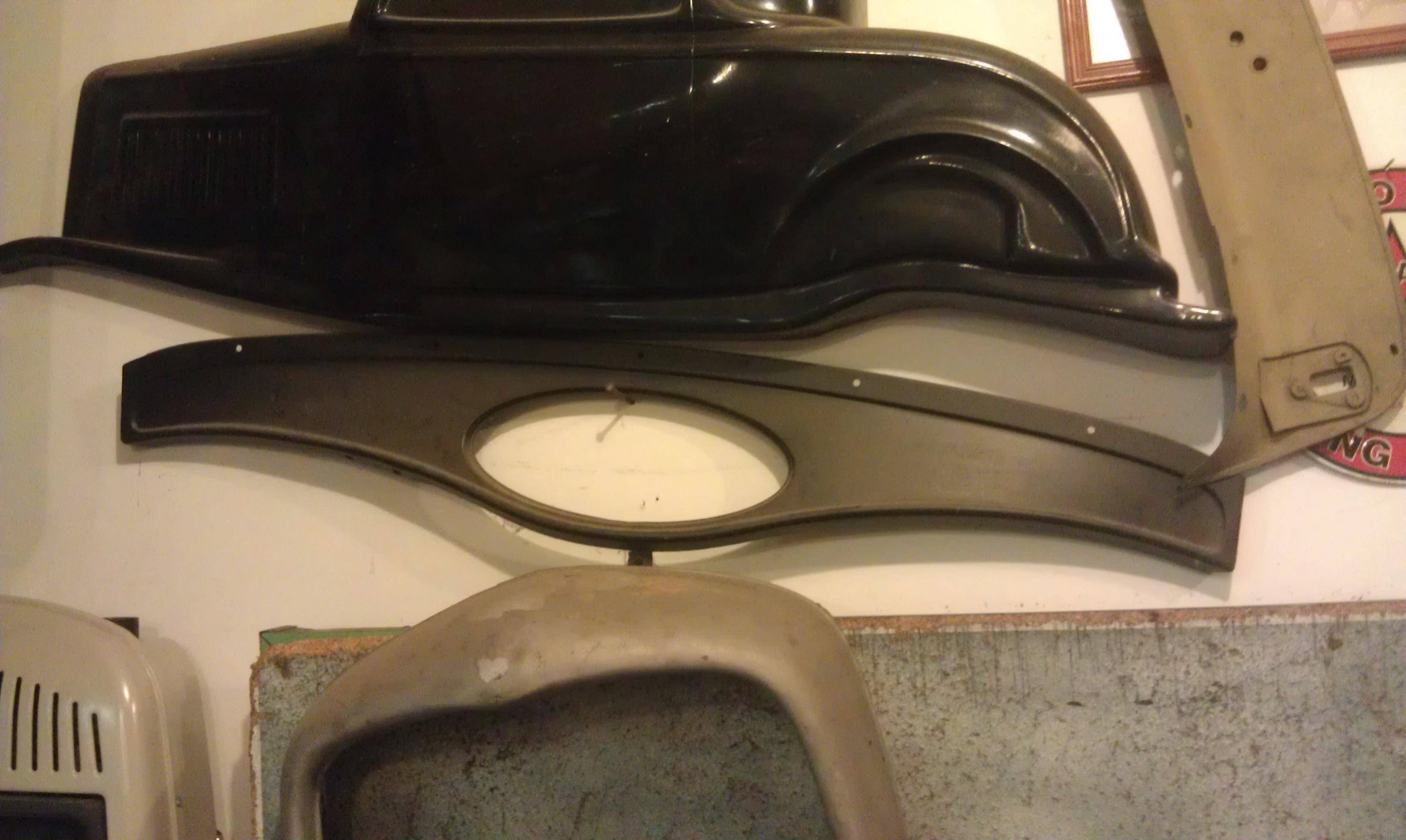

    I bought a bunch of 32 stuff this weekend and this cowl was included. I believe it is a 32 roadster pickup cowl, but wanted to verify it. Also, I will probably sell it to recoup some money, so any rough idea of value?

    Yes and no...they used the same cowl on firetrucks and other commercial vehicles. Although it is the same yours doesn't look like it has the windshield post holes.

    Clark is the man. Dash looks like a pickup, it was also in buses, ambulances.
    I have had a couple of dashes and it looks the same, just cut out center.
    No windshield mounting holes for a roadster pickup.

    That is a 32 roadster pickup dash with the center cut out. I've got one hanging on my wall. They also used that dash on some commercial cowls as well.

    1932 Roadster dash is not the same as rpu dash. I have owned two real 1932 rpus. Nothing interchanges between 1932 roadster and rpu bodies. Gauge cluster is smaller on rpu....

    Hi , Yes its a 1932 Commercial Cowl for a custom made vehicle -- truck , bus or other type . The small tabs at the lower front opening where the firewall fits are there . No other Ford model has these . Thanks -- Joe

    The only thing keeping that cowl from becoming an RPU cowl is a well placed drill bit
    .... and finding a bunch of hens-teeth-rare body and windshield parts.

    EVERY other '32 Ford has those tabs. Nomatterwhat body style.

    Im crying foul see no windshield mounting holes

    It sounds like the only thing that would drive the price of the cowl up is if you had the hard to find rpu. windshield and trim parts with it. As is it's just a '32 comm. cowl.

    The cowl is the part that is easiest to find, with or without holes. The doors, winshield and posts, dash are all special. Although the windshield frame are similar to the 31 Std roadster.

    The commercial cowl was most often used on BB big truck chassis being sold as cowl and chassis units, the basis for buses, ambulances, bookmobiles, moving vans, and other fully custom bodied commercial vehicles. Cowl and chassis units were sold from the Model TT trucks through at least the 70s and perhaps today.
    I think most of the RPU bodies likely sat on BB chassis with flatbeds in southern and western orchards and truck farm situations.
  25. I think he just forgot the word "pickup". The photo he posted is of a commercial open cab dash.
