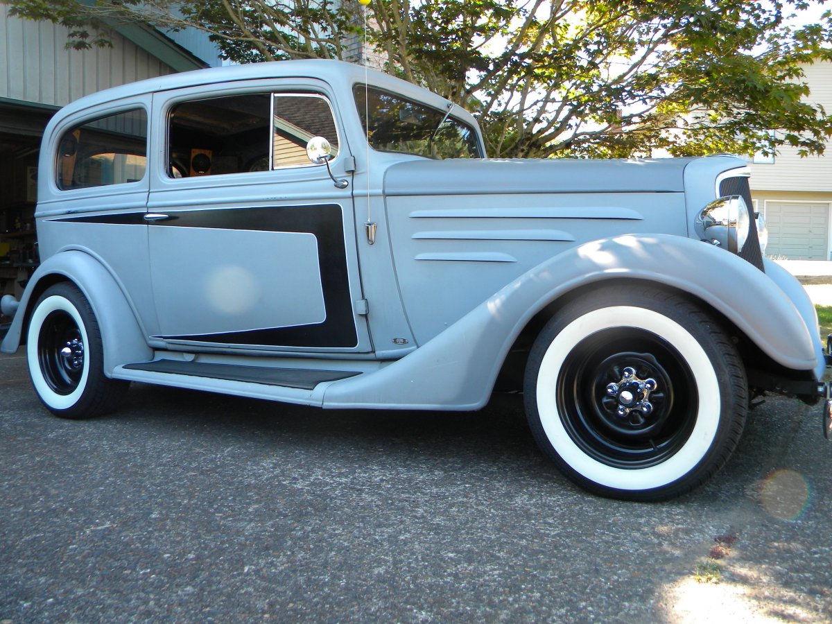

    IMG_0215.JPG DSCN4809.JPG Yep, could look like this when t it done. Oh, and you can swap in a '34 Master dash if you want the gauges in front of you and a glove box. Direct bolt in swap.

    ^^^^^^^wow^^^^^^^
