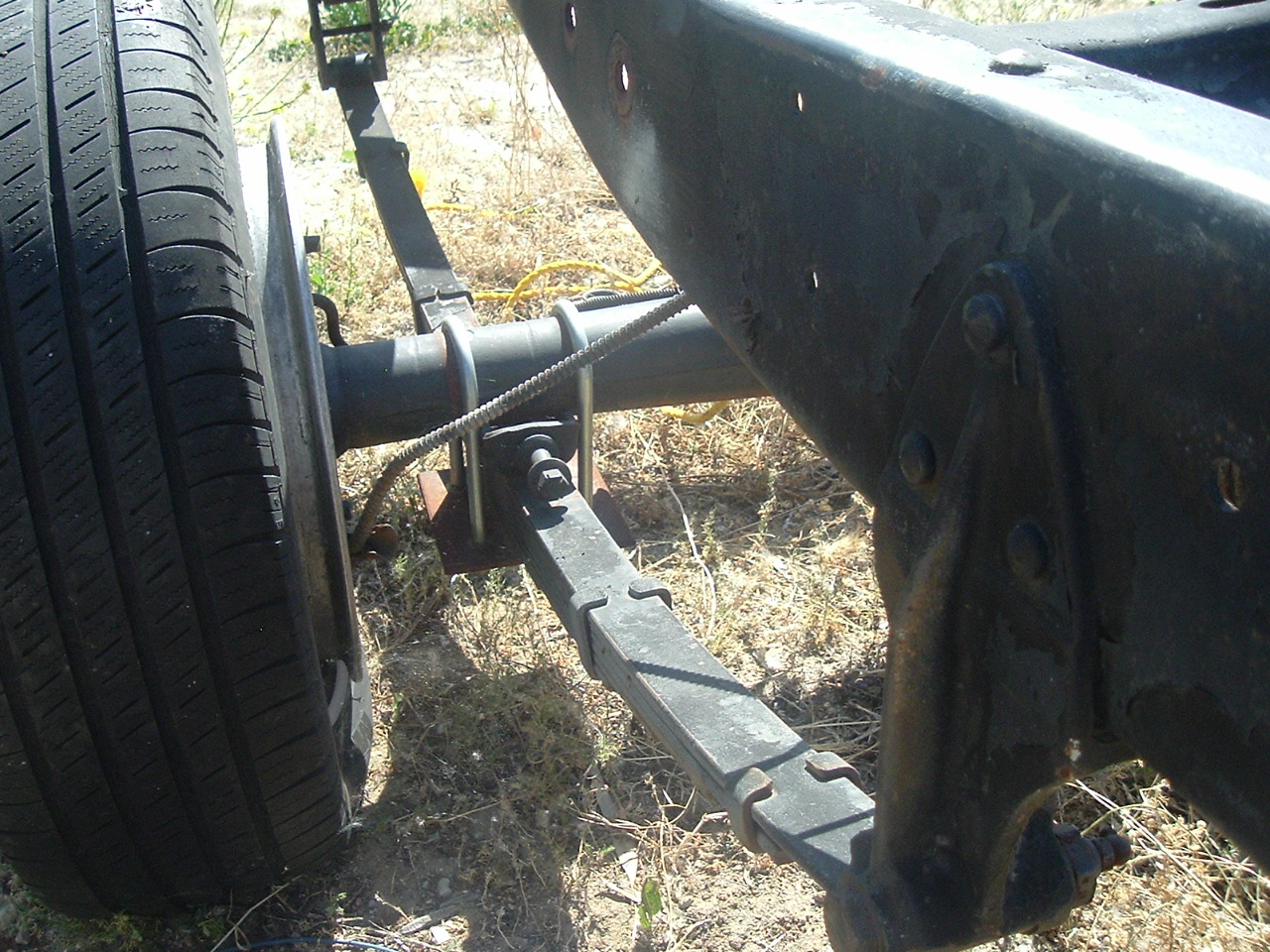

Is this a 9 inch?

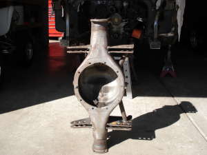

    My 56 Fairlane had a 9 3/8" rear end in it and it was 28 spline with 5 3/4" bolt pattern. i was told it came out of a 77 LTD, which makes sense since the front clip was 77 LTD

    Looks like an early Olds to me.
  7. 1rustyhighcab
    Joined: Mar 22, 2008
    Posts: 118
    1rustyhighcab

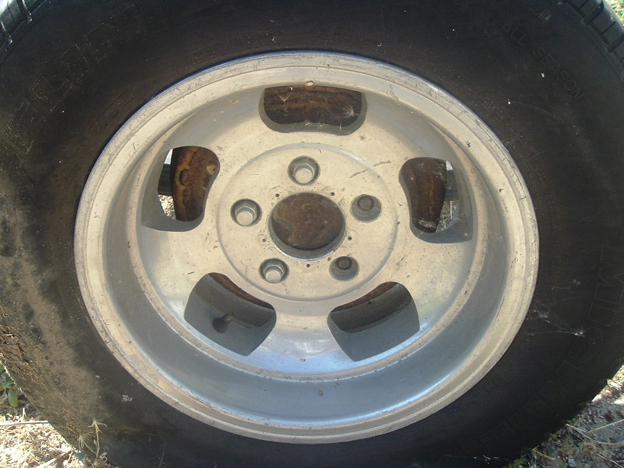

    that looks like a 50's chevy pickup frame. if its a 55 first series, it could be stock
    on second look though it looks like it's five lug, It looks just like a 55 chevy car axle

  12. Truckedup
    Joined: Jul 25, 2006
    Posts: 4,660
    Truckedup
    Looks like late 30's -40's Chevy truck frame,modified 58 Chevy rear axle.

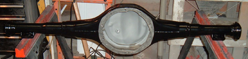

  14. HOT40ROD
    Joined: Jun 16, 2006
    Posts: 961
    HOT40ROD
    from Easton, Pa
    The ford 9 3/8 Rears came in some 1966 - 70 Fords, Merc, and Lincoln. They were all 31 splice axle. Gear ratios were 2:80, 3:00, 3:25 and 3:50.
    The house was the same as the 9 inches and only difference was the the mounting flange was notched out right of center on both the top and bottom so that the rear would clear the housing.
    9 inch will slip right in a 9 3/8 housing . but you would need to notch the 9 inch housing for the 9 3/8 center.
    The housing set on end is a 9 inch. The other one the horses is the 9 3/8 housing.

    The seller finally sent more pictures.
    I expect a positive I.D. now.:)
    Thanks again for all the input.
  16. chop32
    Joined: Oct 13, 2002
    Posts: 1,077
    chop32
    Judging by the bolts attaching the 3rd member (instead of studs with nuts), the flat pinion yoke and the way the e-brake cables attach to the backing plates, Id say you have one of the smaller pre '57 Olds rear ends. Looks just like the one I have laying in my yard.
  17. jerry
    Joined: Mar 2, 2001
    Posts: 3,469
    jerry
    +1 on the Olds ID. I've still got a couple of them around here.
    jerry
  18. DualQuad55
    Joined: Mar 5, 2005
    Posts: 1,385
    DualQuad55
    from NH
    Not early olds, the big rib on the left side would indicate later olds perhaps 57-59 or so. don't remember the exact years there.
  19. chop32
    Posts: 1,077
    chop32
    It would help to know the diameter of the bolt circle. '57-'64 Olds is 13" dbc, whereas the earlier rears are smaller. I can post the diameter later unless someone beats me to it.
  20. chop32
    Posts: 1,077
    chop32
    My early Olds (pre '57) has the big rib, my '57-'64 has a smaller rib on the left side.
    Well I blew that one...the pumpkin bolt circle on a '57-'64 Olds is 11".
    As far as I could see thru the weeds, the pre '57 Olds rear bolt circle is between 9" and 10".
