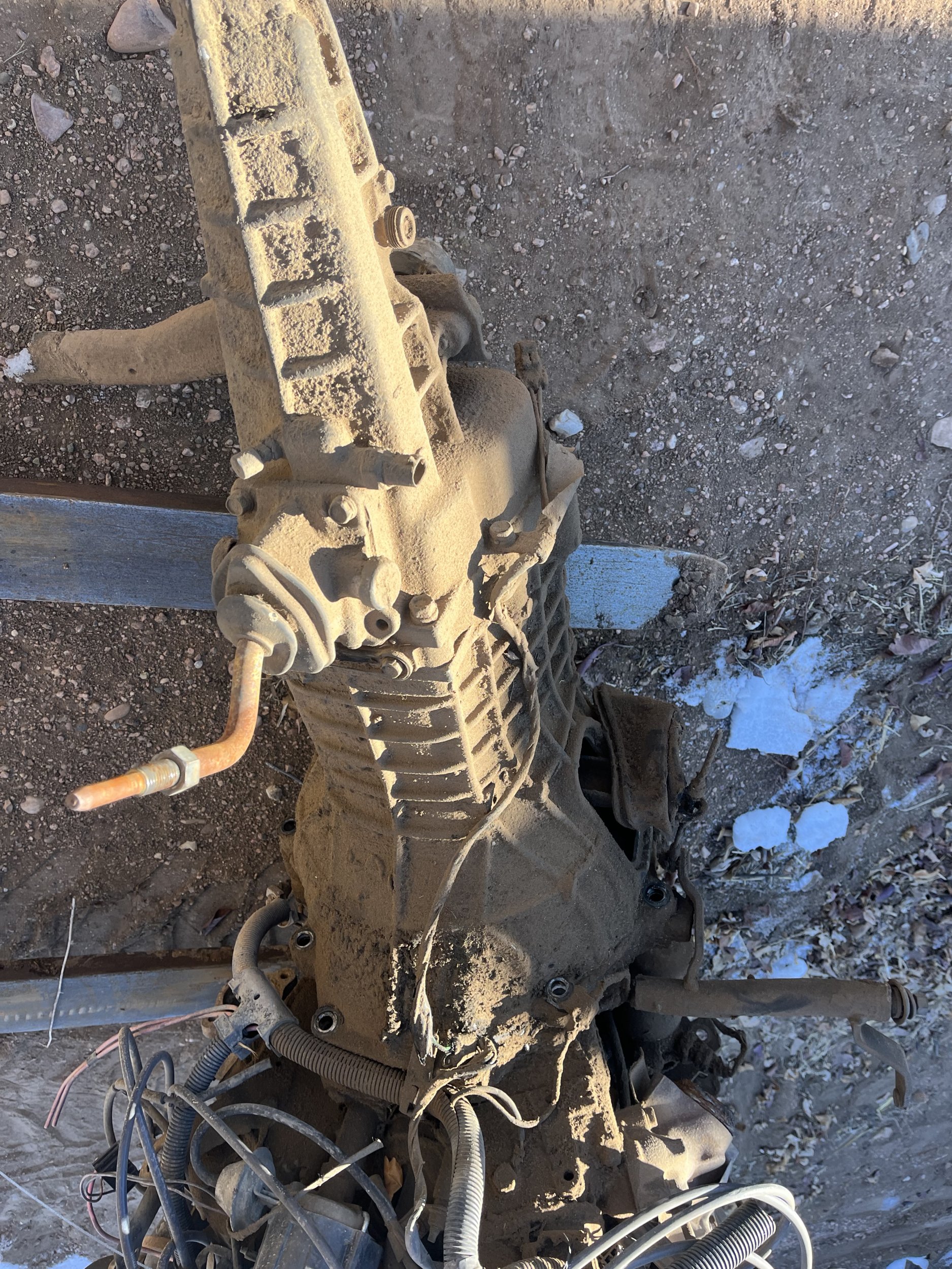

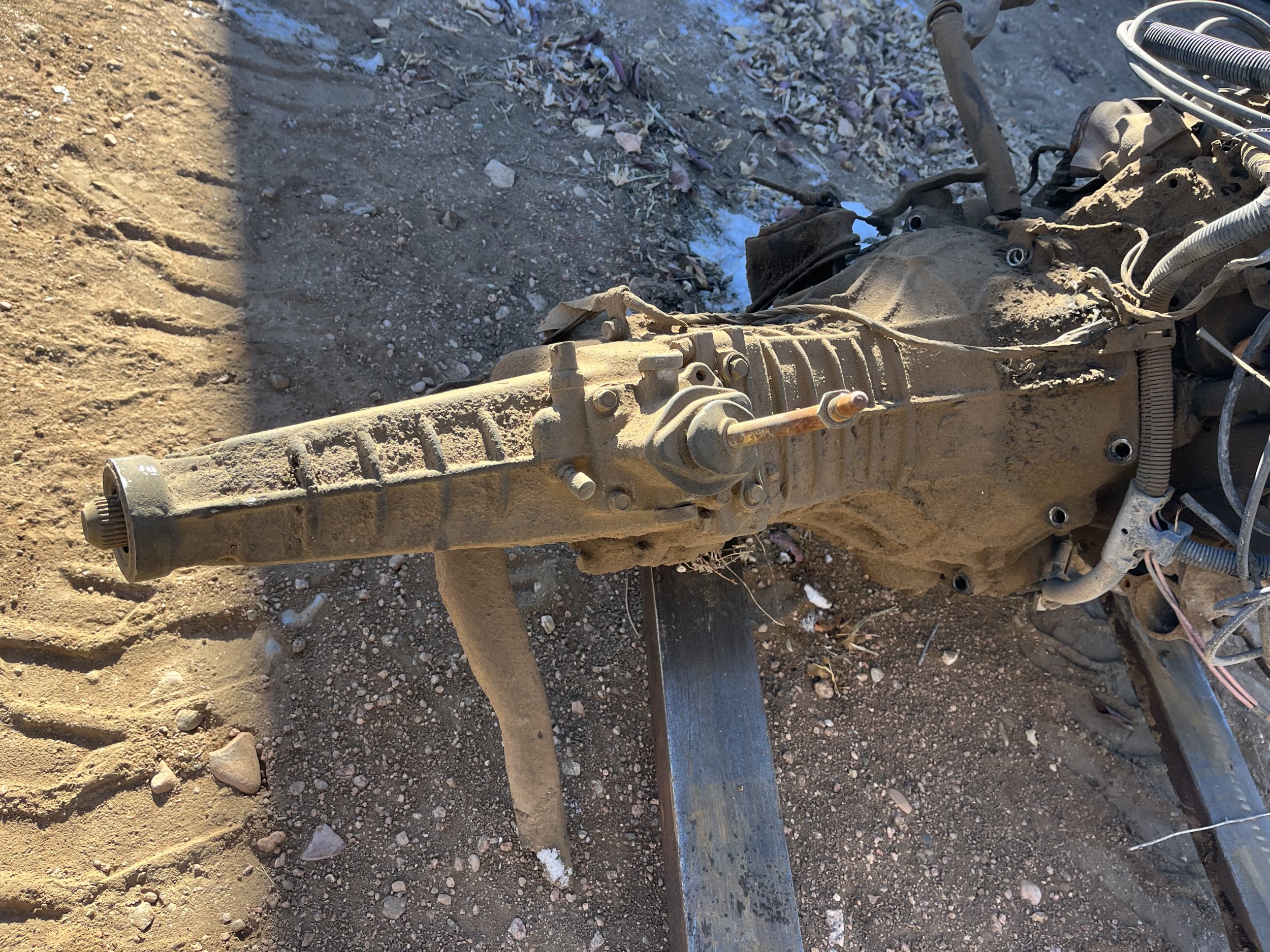

    I have been on the hunt for a T5 transmission to possibly convert my 40 Ford. I found one and the guy says it is out of an 83 S-10. However I am not so sure it is actually a T5. The bell housing is part of the transmission. Before I shell out $300 ( is that a good deal?) I want to make sure it is actually an T5. My inexperience says it’s not. See photos.
    oh, and the guy was kind of pressed for time so I could not find any numbers or tag identifying it.

    Definitely not a T5. That looks like the light duty 4 speed built by Isuzu.

    oh, yeah, I was going to mention I could only find four gears when shifting it.

    NV3500 or HM290 - both outdated junk

    is it v6 chevy?
  7. Busmania
    Joined: Oct 16, 2022
    Posts: 197
    Busmania
    from Denver
    It’s a v6 something. I didn’t look at the motor close enough to even try to identify it.
  8. HEATHEN
    Joined: Nov 22, 2005
    Posts: 9,252
    HEATHEN
    from SIDNEY, NY
    From the look of the distributor on the back of the engine, I'd say yes. An early 2.8.

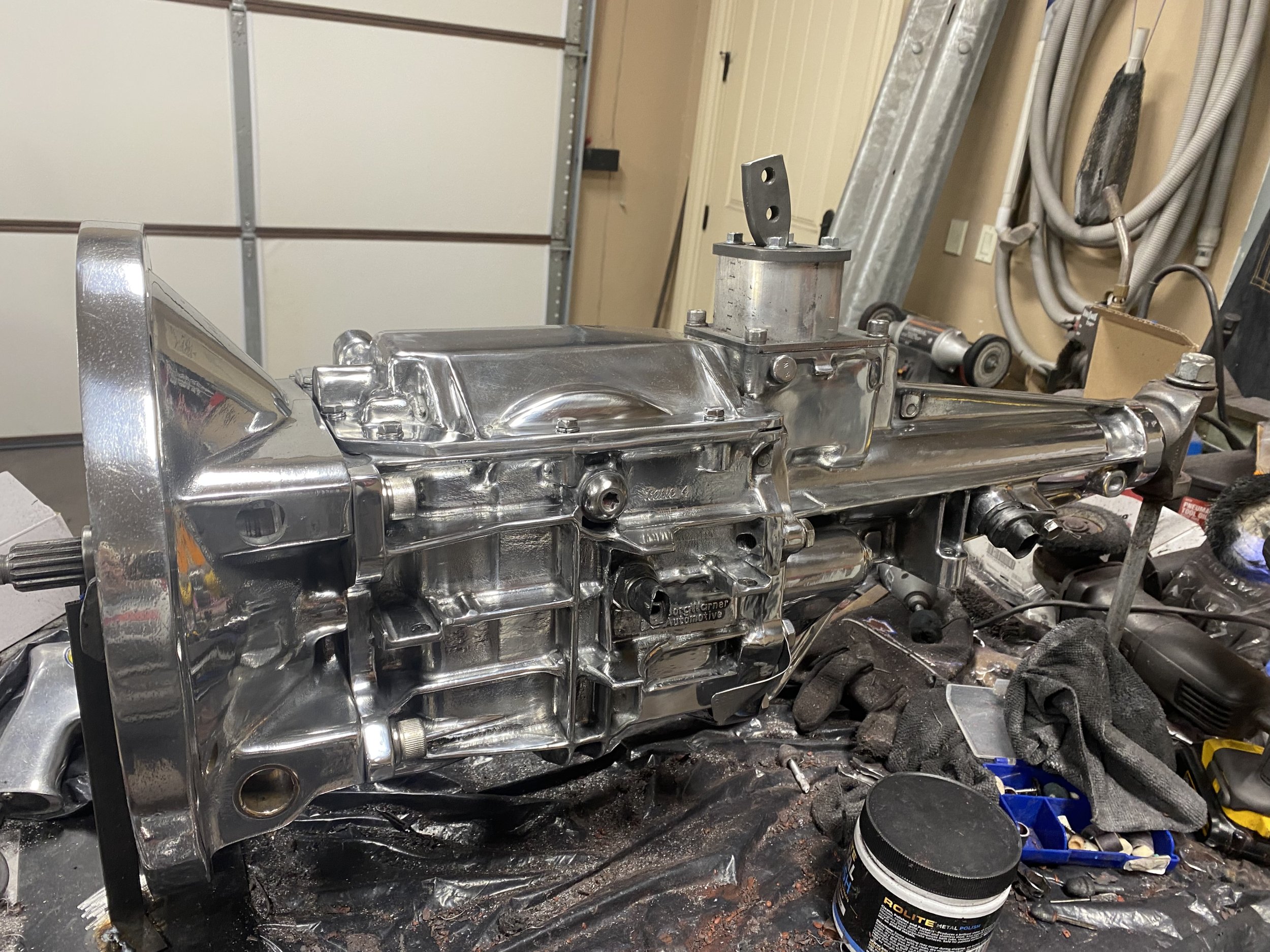

    In my best Crocodile Dundee voice;
    "that's not a T-5, this is a T-5"

    Integral bellhousing = never a T5. P*** on it.

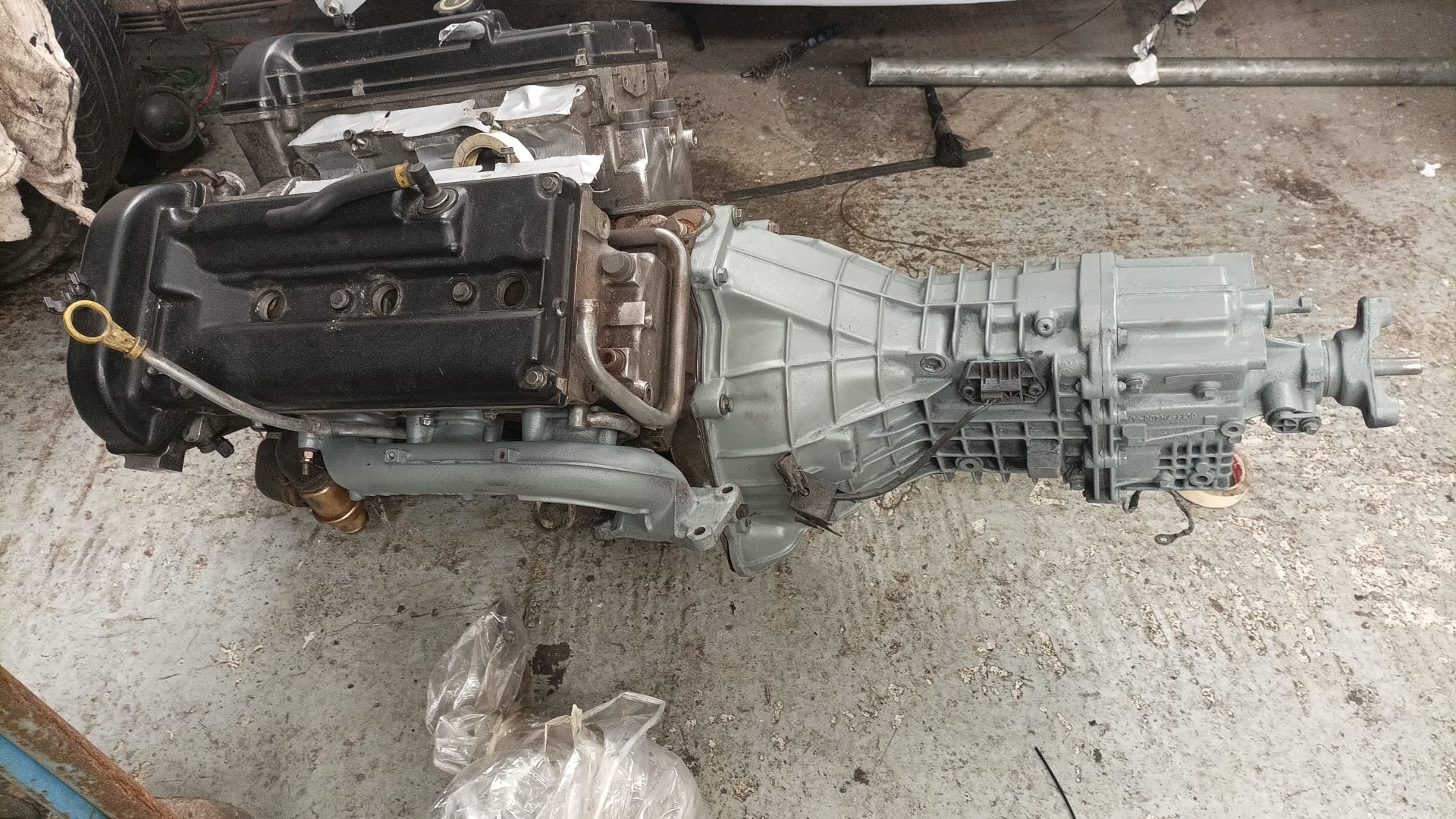

    that is a 1983 up 4 speed transmission, rare and fitted to 2wd blazers
    it would be the same front case with a 4wd tail for 4wd.
    It has only half peaked my interest as it looks like a European ford mt75 V6 transmission, that goes behind a ford v6 cologne engine.

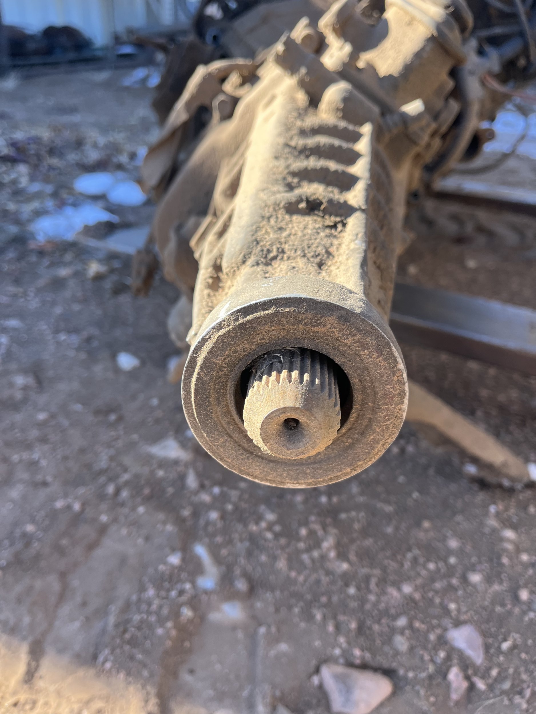

    So I’m looking at a 86 S-10. Engine bad. Guy says it shifted fine before he had engine issues (like ****er, his words) but has a blown engine. Won’t sell just the trans. $400 for the full car. Is this the right trans (***uming it’s stock)? I’m waiting on photos from him but it looks like it’s a 4x4 truck. Does that kill my deal?
    edit. Got some photos. Numbers are 13 52 066 907 and it says borg warner. Looks like a t5 to me?

    the #s 13 52 above identify it as a T-5. An '85 would have a mechanical output for the speedo since digital dashes weren't an option toll 89 and standard in 90 (electronic speedo outputs on the tail shaft. Most of the pre 89 ******s were 4.03 first gear. The more desirable 3.78 first gear was found in the WC and the non WC after '89.
