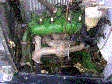

    A quick search turned up this picture of a W-O Whippet engine. It does look similar.

    Looks like they may have used the fuel va*** tank from the Whippet too. Bob

    Whippet really looks like to one in my little car, Thanks for the tip.

    tn.jpg tn.jpg tn.jpg I received this Email a few days ago.
    Your fellow HAMBers might be interested to know that the engine in the cute -Is this a Willys?- mystery vehicle [ http://www.jalopyjournal.com/forum/threads/is-this-a-willys.995053/ ] is indeed a Whippet engine, a Model 96.
    The Model 96 engine was first introduced during 1926 with 134 cubes and was stroked into the 145 cube Model 96A version in 1929.
    The Model 96 used a water pump that could be rotated to adjust fan belt tension and the exhaust header pipe connected at mid point along the manifold.
    The Model 96A apart from the longer stroke had a conventional type of bolt on water pump (with adjustable pulley for belt tensioning) and an exhaust manifold with an exit at the forward end.
    I mention the exhaust manifold because at first glance the mystery engine appears to be a Model 96A with the header pipe attachment at the forward end of the exhaust manifold. Looks can be deceiving and in this case certainly are because the mystery engine has the earlier Model 96 style of water pump and water outlet. These two parts are not interchangeable with the later Model 96A engine because the engine block casting is a different shape at the front end for these components.
    The 96A exhaust manifold, as fitted to the mystery engine, isn't interchangeable with the Model 96 manifold either but in the case of the mystery engine a hot rodder has been at play changing the pattern of the two centre manifold attachment bolts in the side of the engine block to adapt the later more efficient exhaust manifold.
    The Model 96A exhaust and inlet manifolds can be reworked to accept a downdraft carburettor and the underneath mounting flange for the updraft carby converted to function as a second exhaust header pipe outlet if the owner is looking to hop it up a bit.
    BTW in case the owner is interested the only major part from the later 1933 to 1938 Willys 77 engines that will bolt directly on is the cylinder head. This head swap is commonly done to boost the Model 96 compression.
    1939 and later Willys and Jeep engines had an altered head bolt pattern so the later heads will not bolt directly on unless prepared to weld an insert into the head and machine it to suit the changed centre bolt position.
    To show what can be done I've attached photos of a Model 96 engine block fitted with both a modified post war Jeep cylinder head and the later improved Model 96A manifold ***embly that has been converted to mount a downdraft Stromberg carby and dual exhaust header pipes.

    Late to the party again, what a great little car with cool proportions. As a Willys guy I can also say its a Whippet engine, its the same as the 1929 96A I had.

    Thanks to Rich and Ted for identifying the engine.
