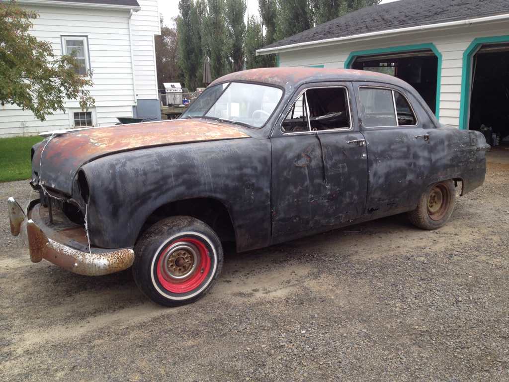

    I've seen people build worse. I've been told to give up on things I've drug home. Don't give up. Tack in some bracing once your sure the body is square. Keep posting pics. Keep asking questions. Indiana cars take a whooping. Best of luck.

    The floors shouldn't be that bad as you can find or make patch panels. On the ledge under the window I think I'd hunt down a donor that had that section in good shape and maybe not much else going for it. Somewhere within decent driving distance there is a stripped hulk with the pieces that would make a car out of that one.

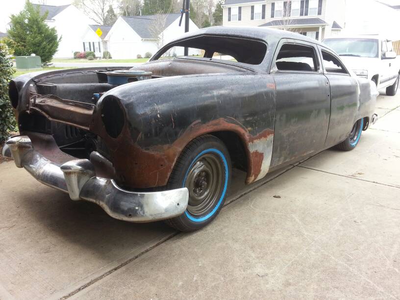

    I built a plywood hammerform for the window ledge, and my first attempt came out ok but I have an idea or two that I will try to make them a little smoother on my next attempt (sorry no pics yet).
    The drivers side front quarter had at least a half a gallon of filler smeared pretty much throughout the whole panel covering up a brazed on patch at the lower corner. I started making a patch panel but had to fly down to Georgia on business so that will have to hold till I get back. That front qtr is pretty beat on so I'm going to try to straighten it but will probably be in the market for a replacement at some point.
    I picked up a HF english wheel last week and have been playing with it some. Would you guys recommend a bead roller? I need to see what else they can do besides the obvious...rolling beads :)

  6. The HF bead roller is pretty chintzy, but if you beef it up so it doesn't flex it's fine for the home garage guy like me. I used one to make my floors, had new dies made to replicate the originals.

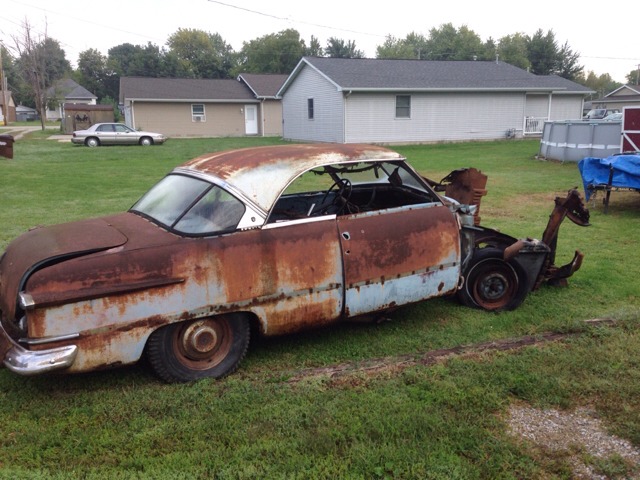

    Dude! That's a Victoria; totally different deal!
