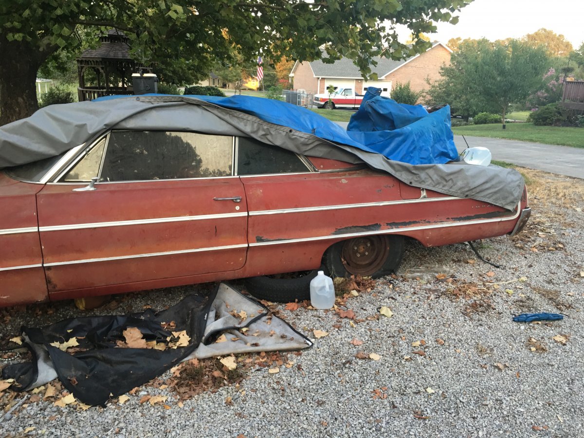

    How’s it going it’s been awhile since I’ve posted on here. I just acquired a 1964 impala non SS from the original owner which is my neighbor. car has sat since 1985 and has been started once to be moved in 2005. The motor (283)spins over freely with the starter and builds oil pressure, the fuel pump has leaked and contaminated the oil. The carb leaks at the base gasket but I was able to free the linkage up even though it is still pretty stiff. The car doesn’t have spark even with a new coil so I was going to drop a new billet hei I’ve got laying around to get it running, the radiator has white buildup inside of it so I’m ***uming it needs to be cleaned along with the tank. The brake master cylinder is gummed up but I heard you can put denatured alcohol in it with the bleeders opens and let gravity drain it out then replace the soft lines and wheel cylinders. Now we get to the fun stuff upon removing the carpet I found a few places with rust which I’ll include in pics I have zero welding experience but am willing to learn and I bought a cheap 100 dollar mig welder from harbor freight to try and replace a small hole in my nova trunk pan. Are these holes bad enough to warrant full pans and also is the car worth enough to get it running and driving I’ve not got much in it as it sits. The car has had power steering power brakes an underdash a/c unit and power windows SS door panels and center console with floor shifter added in the 70s by the original owner so with all that said is the car worth saving and what is a ballpark on the floor pans and overall Resto if it’s done on the conservative side and with me doing the mechanical work? Thanks for all the help guys

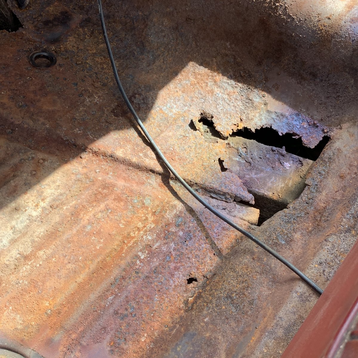

    Driver side and both rear floor pans

    Some of the pics are from a few months ago before I was able to get him to sell it. I’ve only had it about 4 days All the quarters feel solid minus an outer skin about the size of a quarter on each lower front

    You bet it's worth saving! HRP

    nothing scary about that
    all those floor pieces are available and not difficult to install

    looks like it will need a lot of the floor replaced, even though the holes aren't that big right now.
    It's a swell car, put a new fuel pump on it, redo the brakes (not very expensive on those to replace the master and wheel cylinders and the rubber hoses, and maybe the metal lines if they're questionable). Drive it around, have fun, then take your time getting ready to fix the floors. You can cover the holes up temporarily, you don't need to tear the car apart right away.

  9. I'd get in there with a wire wheel and clean those floor pans to see just how solid they are. If they're no worse than what you're showing, I'd just patch them. But if you start finding thin spots or very many pinholes, full replacement will be a better choice.
    And you're going to want inert gas with that wirefeed welder; flux-core tends to burn holes in sheetmetal, besides leaving a ****py-looking weld.

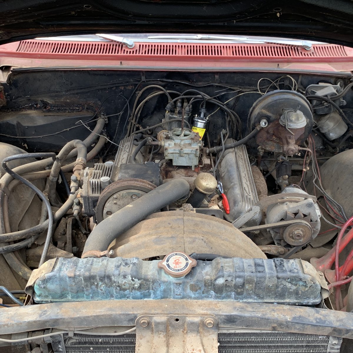

    1. Get a good shop manual. The Chiltons big book (all models) is good with a lot of basic tips but the factory shop manual is more detailed. A book helps tremendously. ...It's a must have.
    2. Get it to roll and stop.
    3. Count on fuel pump, gas tank , all the fuel lines and the carburetor being history in need of rebuild and replacement.
    4. Points are simple to fix and are easier to troubleshoot. Adding HEI does nothing. If it does not have spark to the points, it will not have spark to the HEI. Get it running on points, (You might actually like it) then upgrade if you wish.
    5. You have 100s of little tasks to do to get it driving. Tackle each individually. It's like eating an elephant....one bite at a time. We can be more help with these smaller steps rather than bouncing around.
    Example....
    Fuel system inspection and repair is a big topic.
    Ignition system is another big topic.
    Brakes....Again, another big topic.
    Advice on the whole project all at once is hard to give. It's best to do one system at a time.
    To answer your basic question, Yes this is a good car worth the the work but it will take a lot of it. Fortunately for you it's fairly simple but it is quite a lot of simple tasks.

    The reason I said I was going to switch to the hei is to save the money of a new coil because I think the one I’ve got is bad because I have power to it and ground but it’s not sparking and it doesn’t appear the points are opening and closing and I have that other dizzy new in box. I will look for a chiltons book thanks for the info.

    Those floors are scaly rust like we have in the Northeast. You will go crazy trying to put small patches on those now-thin floors with a flux welder. You won't learn anything except wishing you had gas mig.
    then, there is rot going on with lower door, rear of front fender, so you should look at the frame and also body mounts...from sitting all covered up to trap moisture

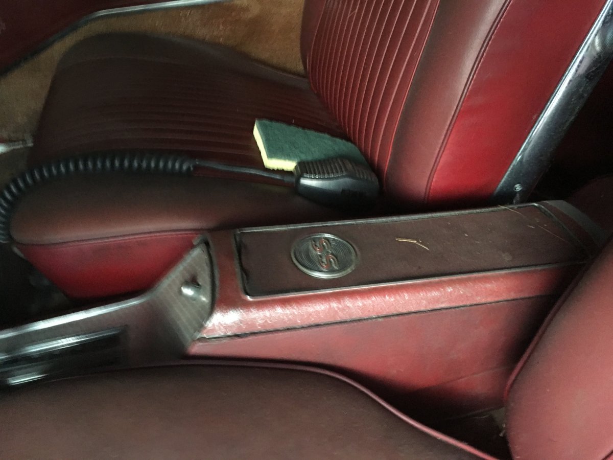

    Put a chome chain link steering wheel in it and you can sell it for big bucks. At least that's what a buddy of mine did with his no body mounts rusty frame 64 SS.

    I'm going to ask the SOB question. Is this a car you're going to keep or flip? Because that will make a ****load of difference in what things are going to cost versus what you're going to recoup on a fake SS. If you're going to keep it, consider everything you do on it as education. So, learn as much as you can. Do as much as you can for yourself and continue to ask questions and for guidance. If you're going to flip it, get it running and driveable and move it on. Save your motivation for the drag car in that case.

    I would rather have the impala over my 63 Catalina so I would probably sell it but my Catalina doesn’t have any rust because I had everything cut out and replaced. I just wasn’t sure if the floor boards being like that if it was worth trying to fix it

    Worth every penny.... It has one of the very rare Corvette 2bbl motors in it!!
