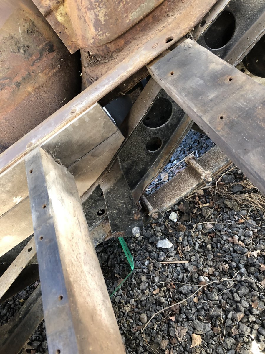

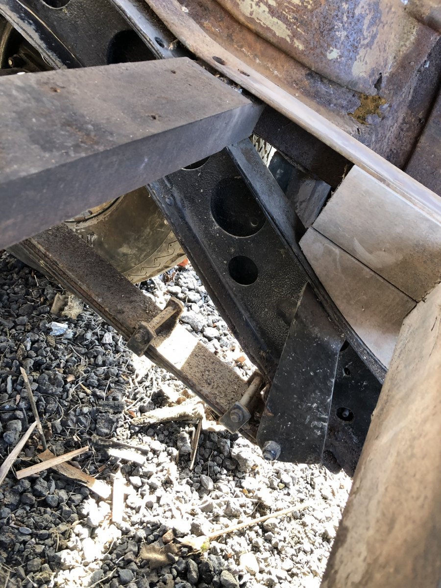

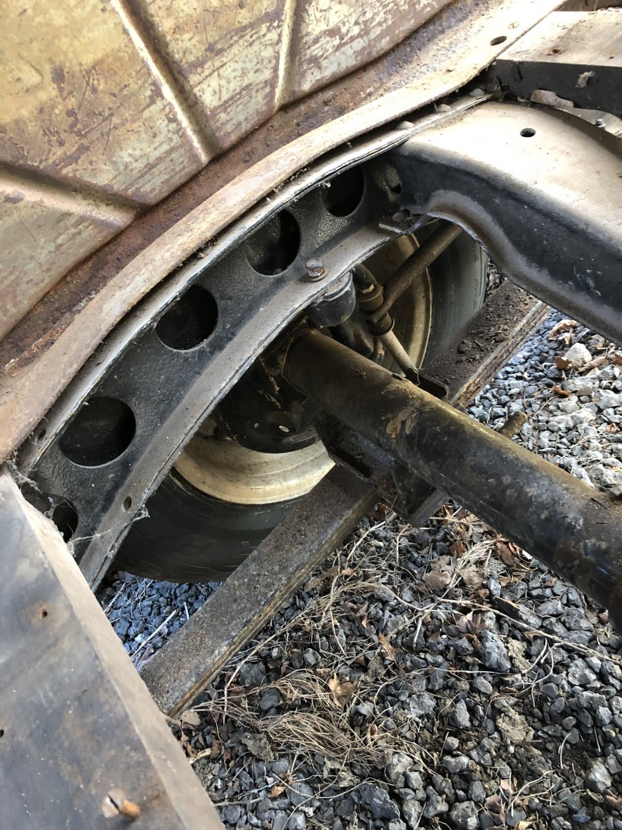

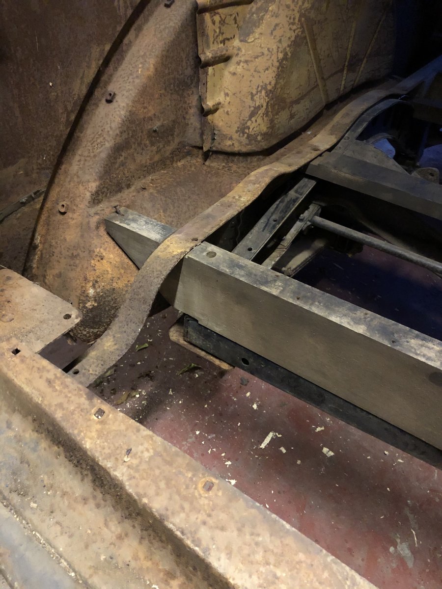

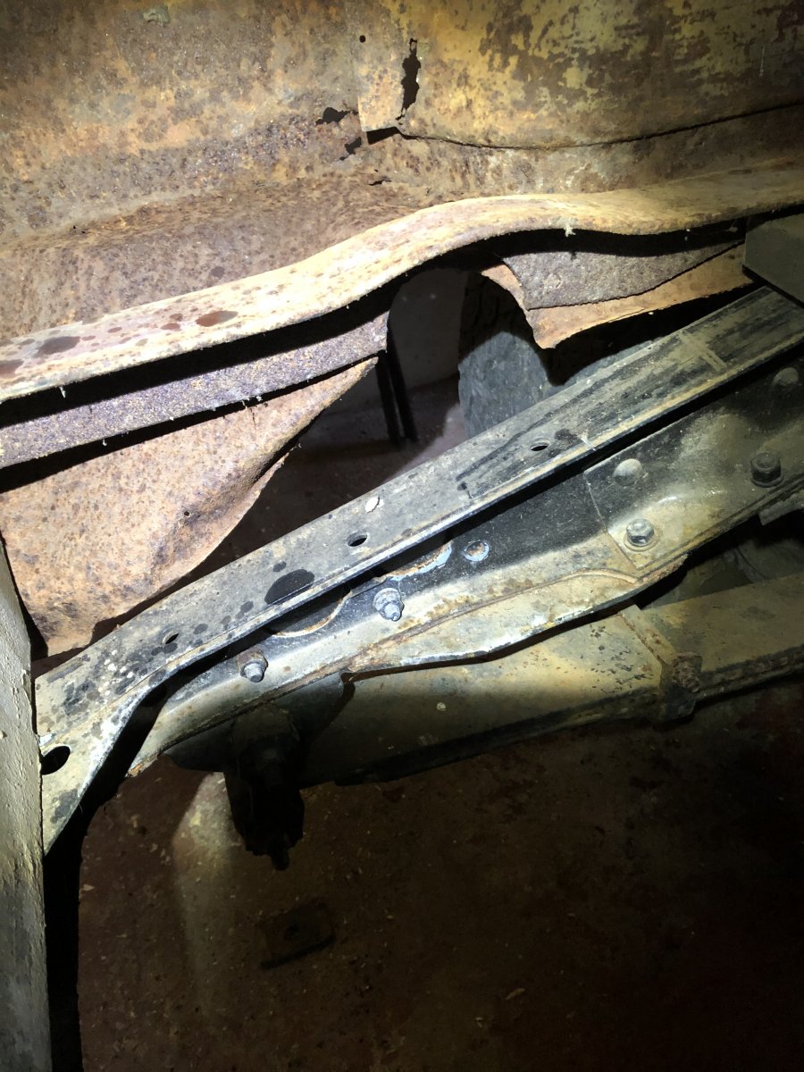

    Hi anyone who reads this . I’m in the process of taking apart my panel truck to fully see how much work is needed on the body and tonight came across this ...
    On one side of the body the metal work runs on top of the wooden cross member at the back and on the other side it runs below. Is this meant to be like this please ? The body sits well on the ch***is and the wooden bed that was inside the panel truck also sat well .

    Never seen that, wish I could help.... someone knows and hopefully reads this.. good luck. BigO

    The right side looks correct...the left looks bent. Maybe it was replaced at some time?

    So you think it should be sitting underneath the timber ?

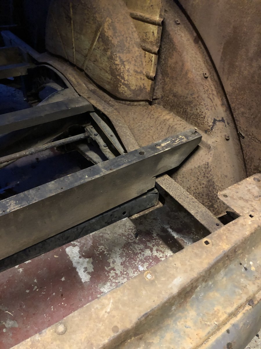

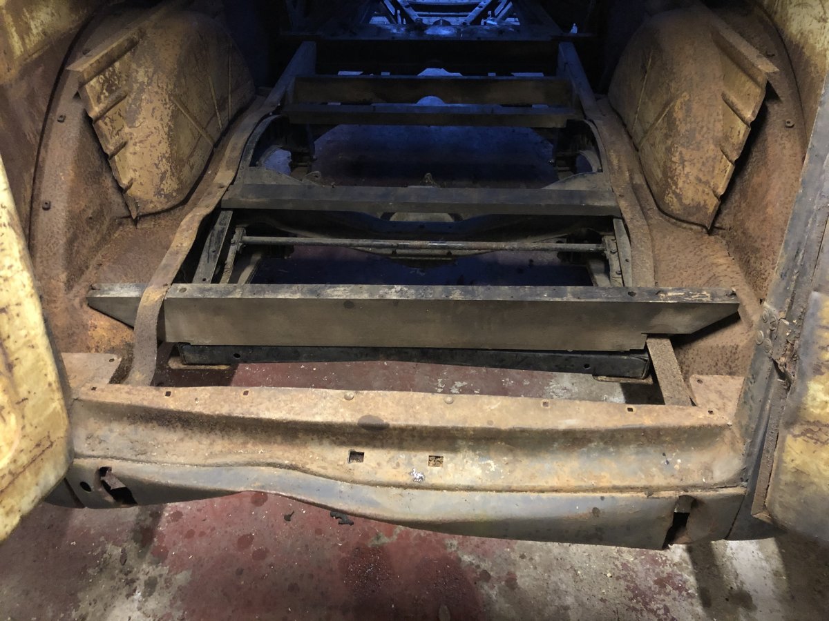

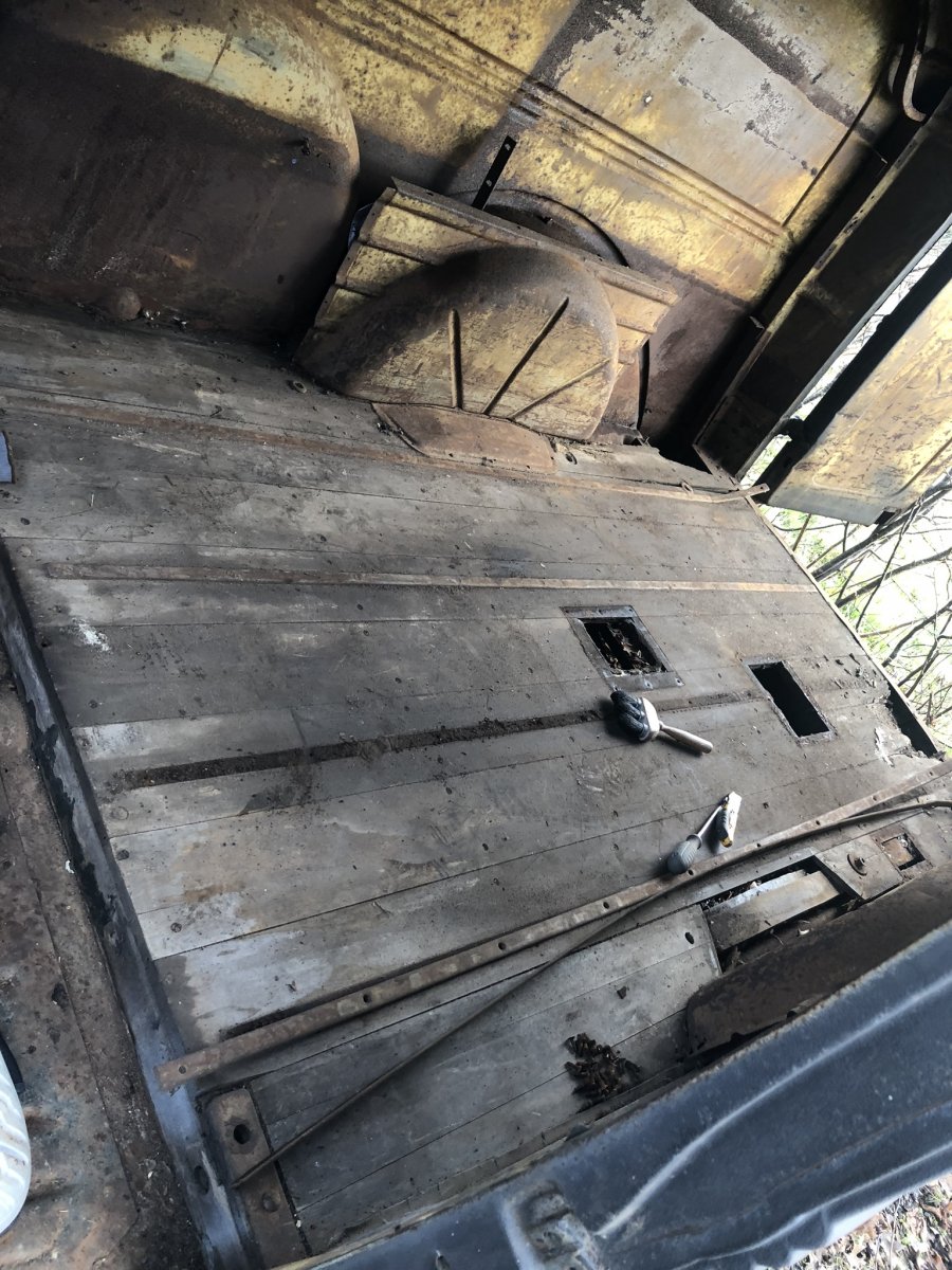

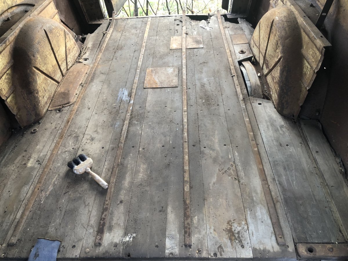

    A2455F4C-D85D-438B-9ED7-0824ECE0DFAD.jpeg 29016185-D4A5-4193-84DF-1184E07C33E8.jpeg 41B12596-0365-4095-86F5-D6A90217C54D.jpeg
    This is the bed before I took it out , was very rotten and weak , but was the original bed as it had the bed strips , 2 access plates in the center and also by the wheel arches

    I'm thinking this through with the eyes of 40+ years in restoration. 1st thing I'd look for is a commercial ch***is of some kind like a pickup or flat bed. How does that frame look? If they too have that extra kick to the left for something (like fuel tank, or other production needs) there's no other way possible to build a level bed back there except with that over/under wood approach. My search would be for Ford Commercial frame pics. This tickled my curious single nerve enough to look for myself. Clever those dadgum Ford guys...;)
    I looked at your pics a lot closer and that is indeed the body subrails, yes? I'm ***uming that's so and the next question is where does the petrol tank normally go?

    The ch***is for these are the same as the 35- 40 car ch***is . But slowly taking this apart I’m absolutely amazed with the way the wood is used on the bed , it’s such a shame I couldn’t save it F94B031D-231B-4D5C-A099-41F6054C5D89.jpeg D8BB0EDF-6049-41B1-BD66-DE1F5E643291.jpeg D35DD065-1DFF-4D10-AB05-953FEF1C0429.jpeg

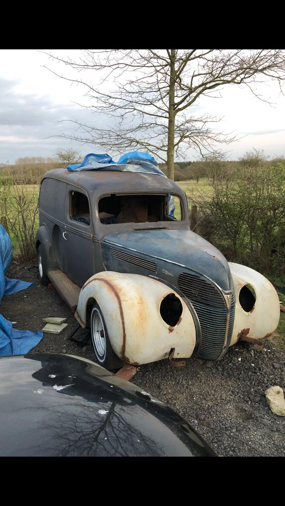

    I did a google image search for 1938 Ford panel truck. It seems the gas tank fills through the fender much like the cars (I have a 39 std sedan). That being the case I'm gonna be in the line that says it's correct. They would need room for the petrol filler pipe and hose, right? Yes, looks like my frame in many ways too and my tank rides back there as well. As to the use of wood you should welcome that. Easier to cut wood than fab steel. You gonna make me search your stuff or post a pic of the whole truck?;)

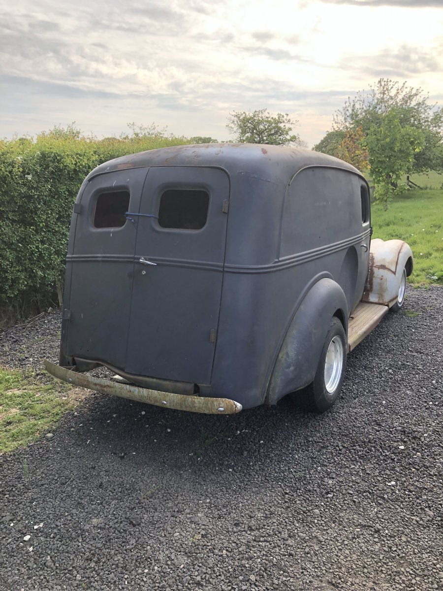

    Thanks for the info . BBEEC52F-DF92-437A-B260-1F4ED0A68FFC.jpeg 08AE3B2E-AD7D-404C-B0FE-A2BBAF8A92CE.jpeg

    You have a really nice looking truck there. Good luck with it.

    The car sheet metal on the front is a natural. I've seen it on pickups too and really, REALLY like that look. Way kool...

    well for anyone that wants to know the rails on my truck body are correct and thehighlander was correct it’s shaped this way for the fuel filler neck to go under . BFBC52BF-0E6E-4D5E-812B-1F24A81B8EF7.jpeg

  15. For what it's worth, the gas tank is the same for all '38-'40 Ford car and '38-'41 1/2 ton pickups and panels (112" wheelbase) except sedan delivery. You have a panel truck, not a sedan delivery, so no problem. The filler pipe is different from cars but is the same for all 1/2 ton (112" wheelbase )'38-'41 pickup and panel.

    I would suggest that the strap follows the floor on both sides, the timber supports for the floor would have been bolted to the ch***is through the strap and timber and ch***is, more than likely with blind bolts with a square locator similar to a gutter bolt, I had a 39 Coupe Utility years ago and the wooden floor had a similar arrangement, although worlds apart Ford did use similar manufacturing processes world wide.
