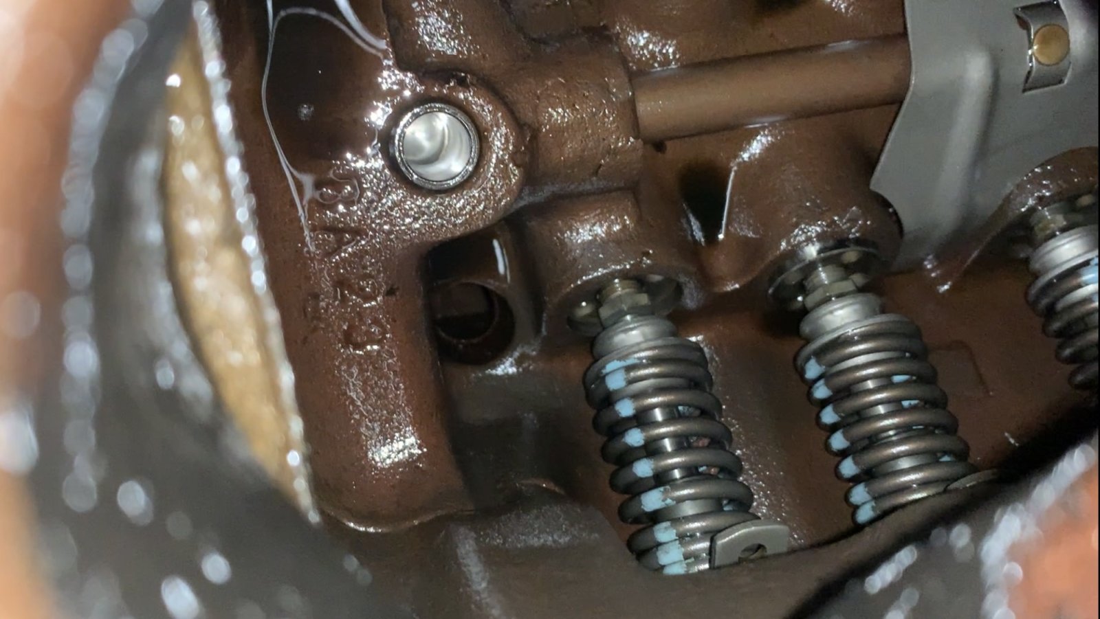

  14. Fennix
    Joined: Jul 1, 2024
    Posts: 27
    Fennix
    I pulled off the blanking plate and DANG it is pristine in there! It does have adjustable lifters too it would seem.

  15. RMR&C
    Joined: Dec 26, 2009
    Posts: 6,466
    RMR&C
    from NW Montana
    Looks really clean! Well worth your time to pull the intake and check the valve lash.

  16. Marty Strode
    Joined: Apr 28, 2011
    Posts: 9,850
    Marty Strode
    Good, now you might get lucky, and find the lifter bores have been cross drilled, to make it easy to hold the lifters during the adjustment process.
