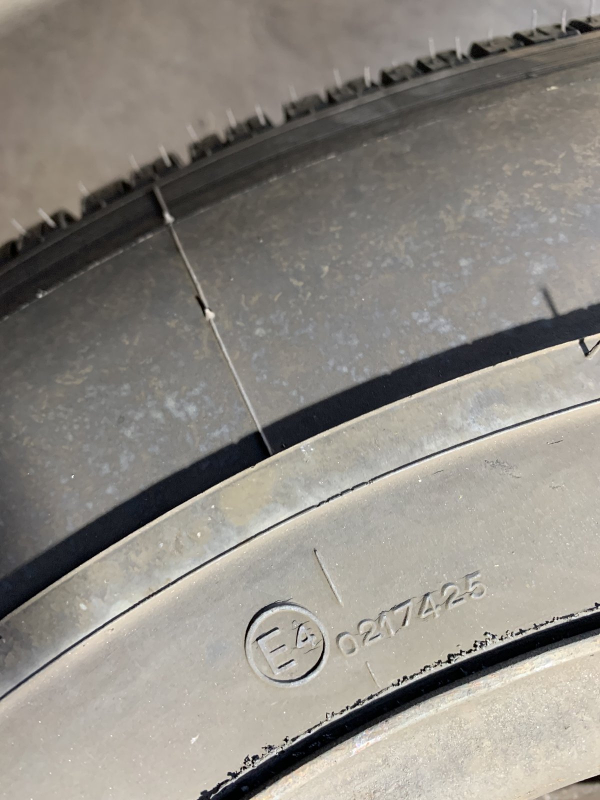

    I’ve looked all over for the date code on my Coker Cl***ics. I couldn’t find anything on the outside of the tire that resembled a 4 digit date code, but I had a wheel off yesterday and noticed some things stamped on the inside of the tire, and was wondering if either of these could be the date code. I believe it’s a 4 digit code- the week and then two digit year.
    There was a post on here a week or two ago discussing date codes and tire age, but now I can’t find it.
    Could either of these be the date code?
  2. twenty8
    Joined: Apr 8, 2021
    Posts: 3,778
    twenty8
    2nd picture, last 4 numbers.
    24th week of 2001.

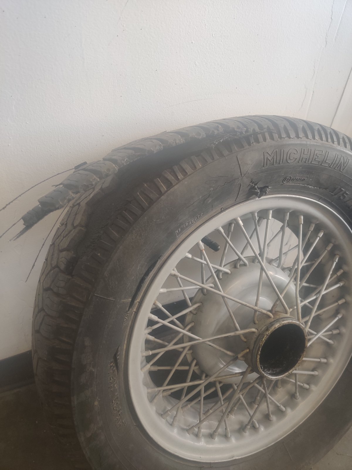

    Please use caution. In the past few years we've had four tires on three different cars delaminate while just sitting here in the shop, simply inflated to normal tire pressure. We've heard of many more from members of local car clubs whose tires shredded apart on routine drives. Nobody got hurt, but in a couple of cases the cars were badly8 damaged by tire debris. You just can't tell by appearance or tread or even the date what's going on inside that tire carc***.
    This is a Michelin with less than 500 miles on it, but it was 25 years old. It blew while sitting in our shop. Please be careful if you decide to drive on those. IMG_20220915_160146.jpg

  9. squirrel
    Joined: Sep 23, 2004
    Posts: 60,079
    squirrel
    Those tires that blew up....were they all steel belted radials? Just curious.

  10. mustangsix
    Joined: Mar 7, 2005
    Posts: 1,550
    mustangsix
    One was steel belted, I know. I think it was from Sears (that sure dates it). The Michelin in the photo isn't, but I'm not sure of the other oddball brand tires that blew. I haven't seen any customers that still have any old bias ply tires on the ground, but several have ancient bias spares that I wouldn't dare use.
    That tire in the photo was from a 1953 MG Arnolt drophead coupe. The car is probably worth in excess of a quarter mil, but the owner was reluctant to spend less than a grand on proper tires....I don't get it sometimes.
