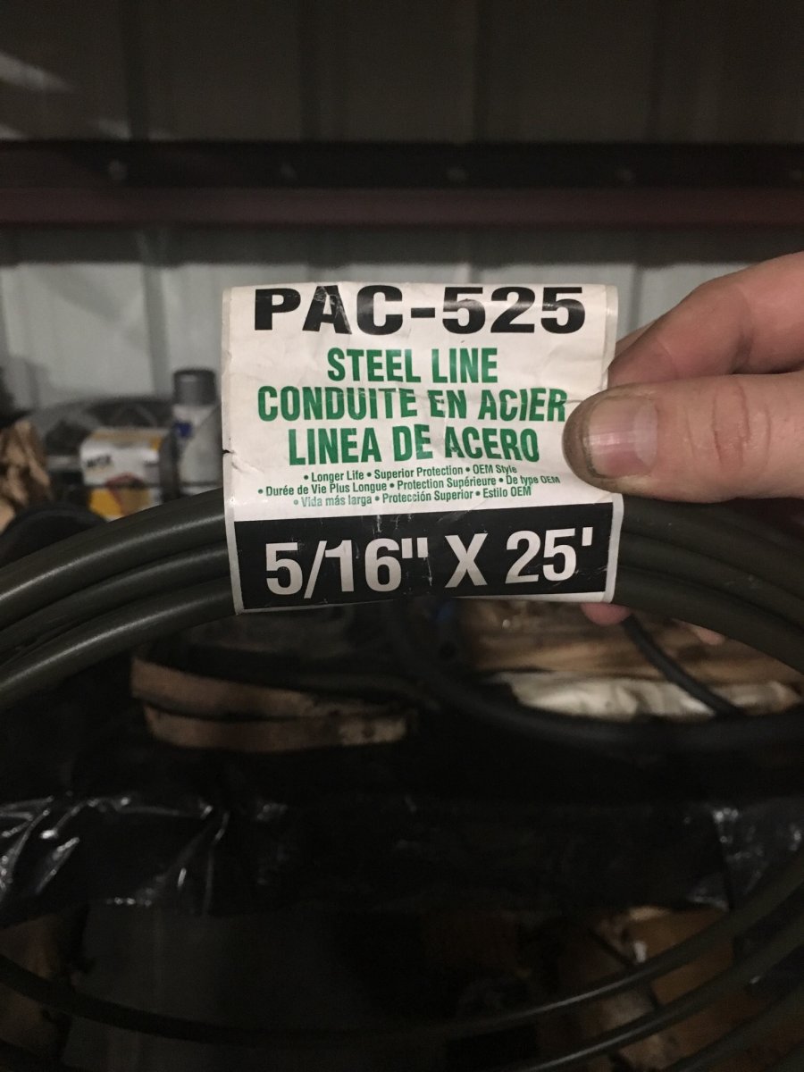

    Just making sure this is safe to use as fuel line??
    Thanks!!!
  2. It should be fine. It's common. They have been making steel gas tanks for a long time, too. But that's not to say there haven't been occasional problems. There are probably better choices for a little more money.

    That should be fine. I would jump up to 3/8 line. Most factory built cars that had engines less than 330 cubes used 5/16, over 330 cubes they used 3/8 line. Not knowing what you are building I would spend the couple extra dollars and get the bigger line.

    I would use the copper-nickel alloy line. It is more expensive, but much easier to bend and shape

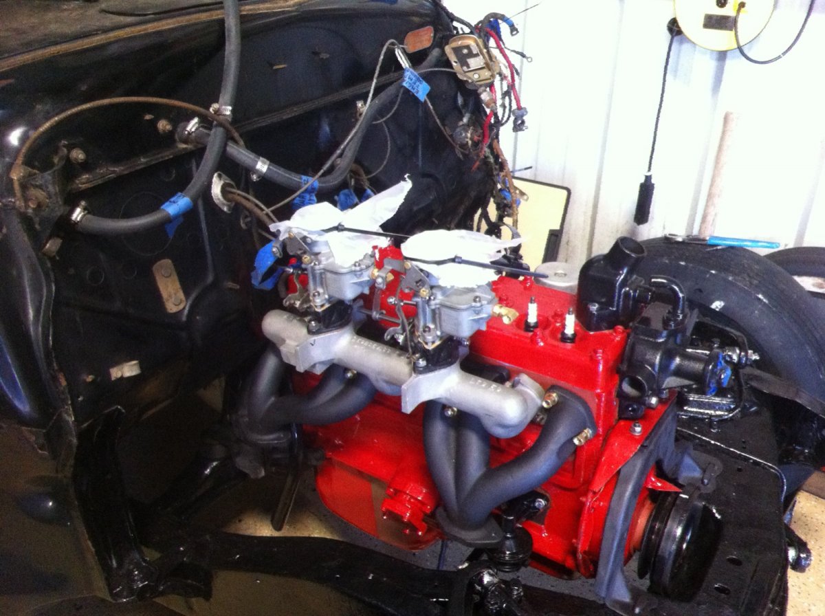

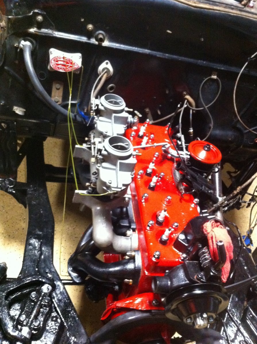

    Sorry HAMB family I got in a hurry posting this, so I should have included what engine & setup I'm using. It's on my 48 Plymouth 218 Flathead & 2 single barrel carbs. Going to fuel pump to 2 port fuel block to the carbs. I have wire hangers as models that I thankfully learned from some of you. So hoping that this 5/16" is good. thought of using copper. & using brass connectors w/ flare connectors. Thanks for all your input!! Mike newest48engine.jpg

    Another question that I didn't think about until the Wife asked... "How are you going to get that that coil of steel tubing straight from the fuel block to the carbs?"
    Crap, so i didn't think of that.... Suggestions??? besides go buy straight 5/16" tube... LOL

    You're going to put some kind of flexible hose between the moving engine and firewall ?

    If not a flexible hose, add two or three loops in the tubing, you need something that will take up engine movement. Direct to firewall will fail at some point!

    Aluminum line flares easily and is easy to form. Just make sure it is supported in Adel clamps on long runs. From the fuel block to the carbs you need something that will flex. I like the Summit twist tite hose and fittings.

    Later... I see this is for the firewall to carbs, DO NOT use a hard line here, use neoprene (rubber). More later.

    O wait you don't use hard line from a firewall fuel block to carbs, you use rubber or rather neoprene. If you want to go real traditional you would use clear plastic, or tinted red or blue (definitely not recommended)
    Go ahead and use neoprene, but be warned these fuel blocks have been illegal in drag racing since 1957. A couple of cars with blown flywheels, chopped the fuel lines resulting in bad fires. Not a big concern in your case.

    Motor looks great...

    Wouldn't use copper. Vibration will work harden and crack it.

    Hadn't plan to because I was trying to go traditional & looks so much better. BUT since everyone is suggesting not to it looks as if I am running neoprene hose. Luckily I can return the steel hose, but stuck with the clear red hose.

  24. Nice air cleaners.
    loudbang and Poh like this.
