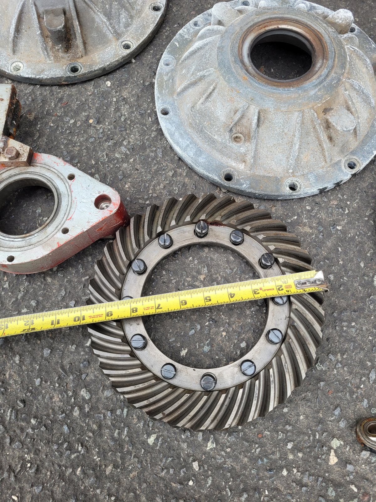

    Keep the center section, the ring gear and ditch the rest. Yours is the big 10 inch ring gear style and will look like this when put together.
    The search will give you lots of info to put it together without too much trouble, they are pretty simple once you get the hang of them.

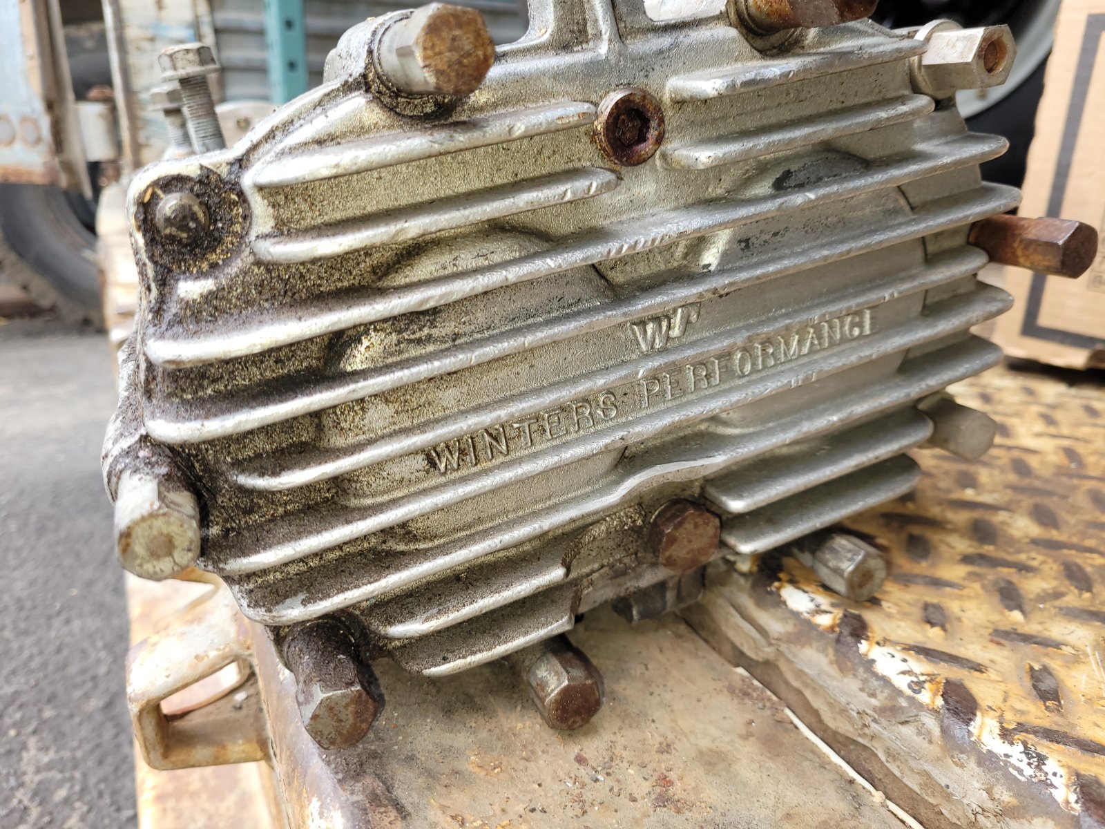

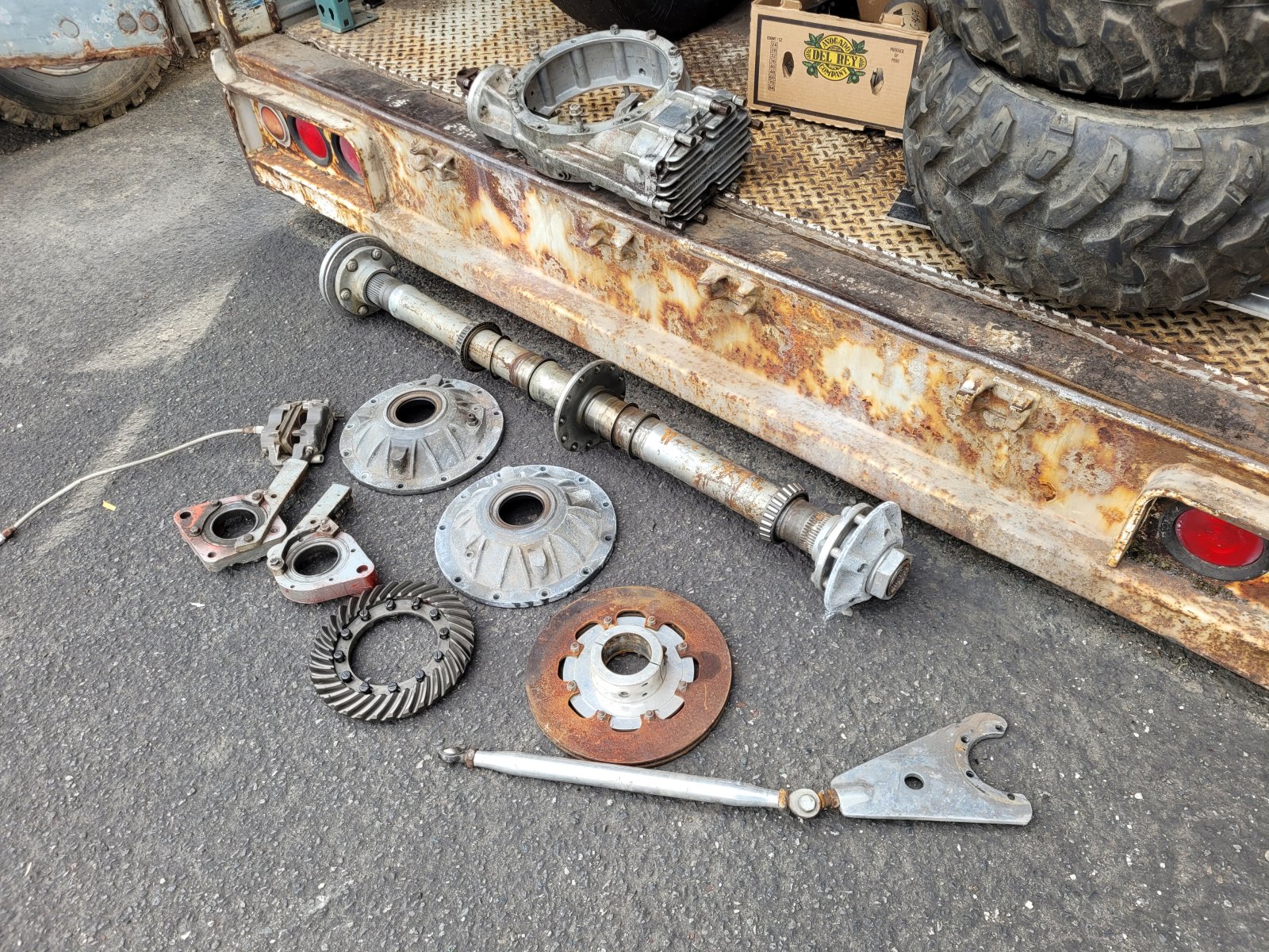

    I picked up one of those Winters live axle quick change years ago and have never done anything with it.
    I also picked up a Franklin quick change with the grand nationals wide 5 hubs, thinking of buying new tubes with the Ford bearing ends and using 9 inch axles.
    My question is, would the Winters axle tubes fit this quick change?
  16. A lot of our parts do interchange with Frankland, but not Halibrand. What's the ID on the bells you have?

    Joined: Aug 14, 2007
    Posts: 13,763
    saltflats
    from Missouri
    I will need to remove one and take a measurement.

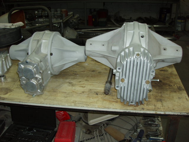

    The question is. Do YOU halibrand-----frankland-----winters 001.jpg really want to use this BIG rear end in your street rod?

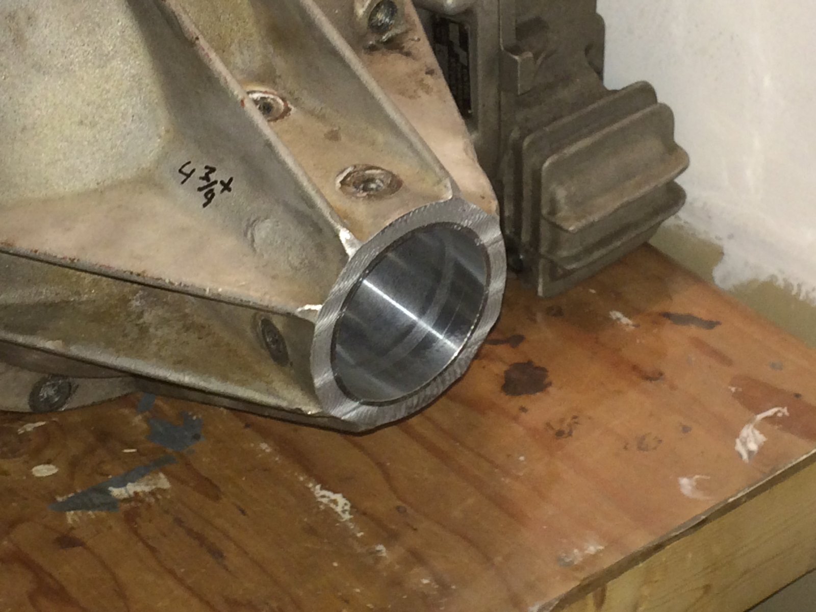

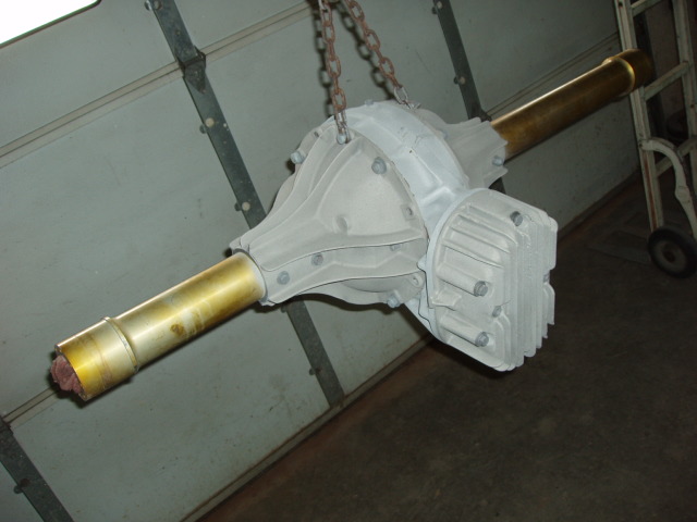

  23. Frames
    Joined: Apr 24, 2012
    Posts: 5,318
    Frames
    Trans sprint 039.jpg I shipped this Halibrand 301 Q C to Long Beach on it's way to Australia. $2,500.00 with 3/4 ton truck steel bells and a locker. About half the price of a Halibrand 201 without a locker. I am looking for Frankland side plates to build another QC like the 2nd picture. Sold it for $1,900.00 40 years ago. Hot rod Frankland.jpg Picture226 301 001.jpg A spacer is needed in the right side.

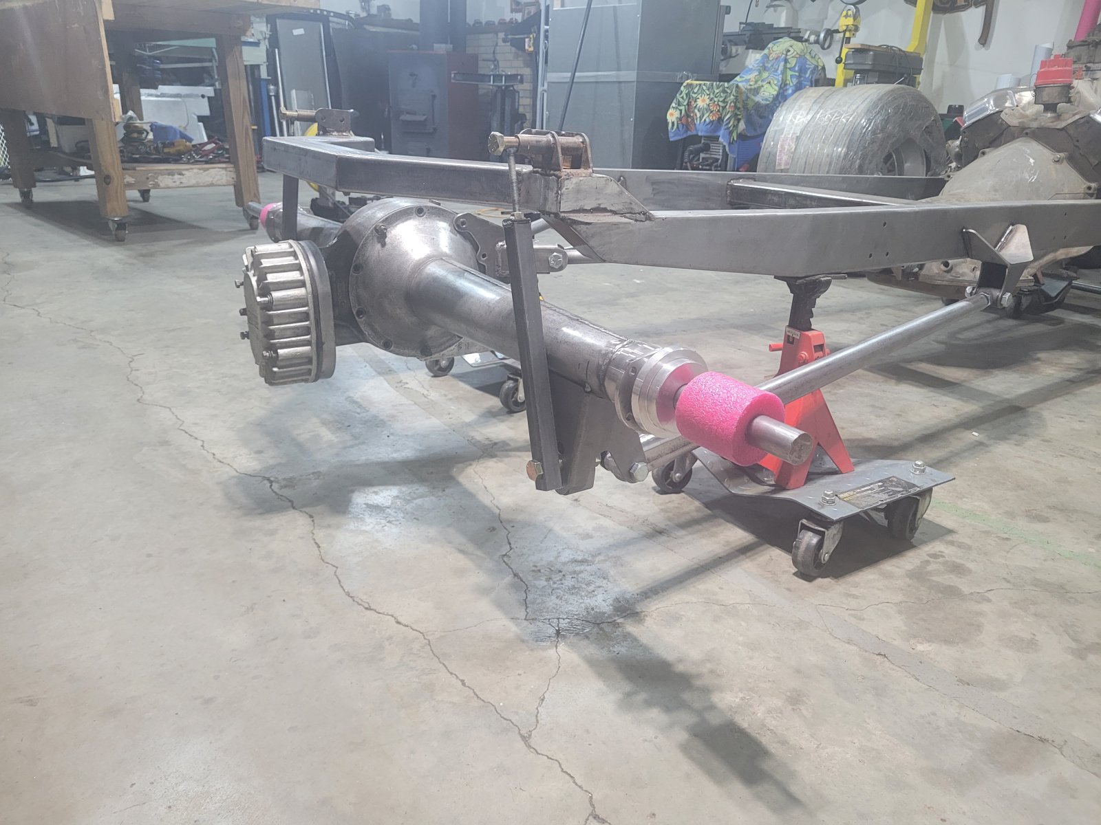

  24. Dave G in Gansevoort
    Joined: Mar 28, 2019
    Posts: 3,929
    from Upstate NY
    Yes! DSCN1059.JPG And I used the 5x5 gn billet hubs as well. To date counting the drill bit to fit new 1/2-20 lug studs I've got just over $550 in it.
  25. Dave G in Gansevoort
    Posts: 3,929
    from Upstate NY
    Oh and one of you guys questioned whether or not I was going to be able to get the cover off. Since this picture I've lengthened the frame by about 10 inches, which solved 3 issues. 1, getting the cover off. 2, fitting in the fuel cell. 3, getting the frame back to the turtle deck.

    Posts: 3,929
    from Upstate NY
    Just found these old pictures from 7 or 8 years ago when I was rebuilding the Winters qc in the Whatever project. IMG_0144 (1).JPG IMG_0143.JPG IMG_0135 (1).JPG The new axle tubes are 1st. Trial ***embled, 2nd one. Close-up of the side bells after I sleeved them to repair the knackered bores. This qc looked like it spent some time in a show car ch***is, but earlier use must have been a little bit rough on the axles.

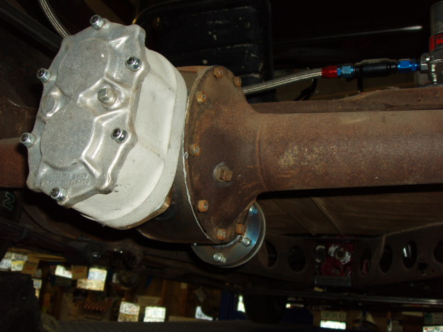

  28. Frames
    Posts: 5,318
    Frames
    I installed a $19.00 Speedway Motors 28 spline 9" mini spool in this vintage 39 Hudson circle track car. Bored the ring gear and carrier same as you do for 28 spline side gears. My own custom built steel converted QC. My cast extension much simpler than Frankland, Bart and others. Eliminates the 7/8" steel spacer and all it's welding. Eliminates the spacer ring and 1/4" plate. Much easier to make the pattern than making the Frankland cover pattern. I built 5 then sold the fixture etc. 3 are in my own cars. 2012-11-13 08.12.18-2.jpg
