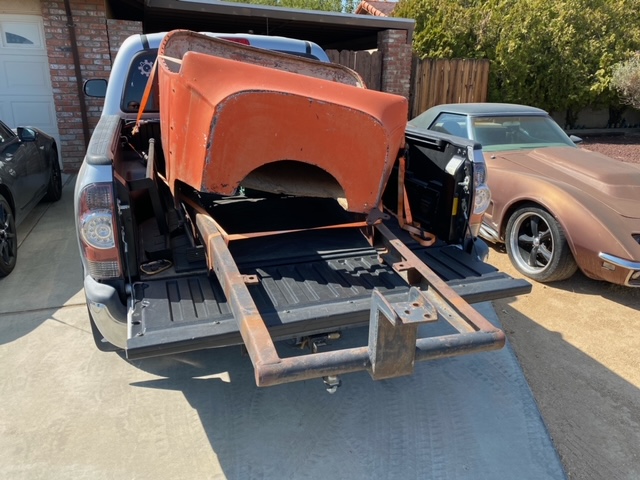

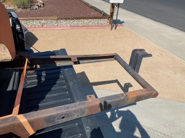

    This is how she looks now. That spring perch (right term?) is TALL. The car previously had a straight model T axle. I plan on using a 4" drop tube, for no other reason than simplicity and I've never had a car with a 4"dropped tube axle. Or for that matter, a front axle.

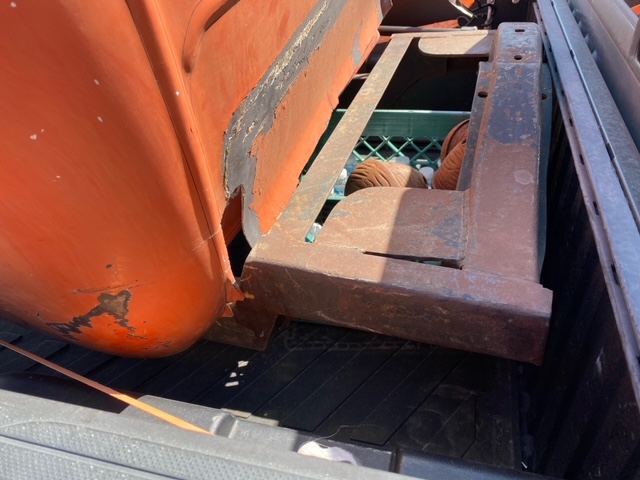

    I believe these are flathead mounts? They're not staying. Front crossmember holes were filled...I believe the front crossmember is centered on the same spot as the original. Frame is not fully boxed. I'm still undecided on front suspension. I've never heard anything good about suicide front ends...I've also never heard tell of an accident involving them; just heard lots of stories about the potential for bad things. If I go suicide, that perch needs removal.
    The rear of the frame has been kicked up and retains the original crossmember...and some really ugly what I guess are possibly coil spring mounts? They're not staying.

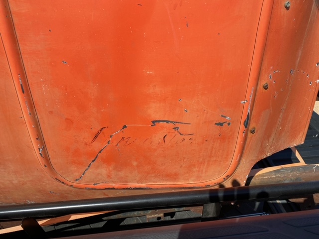

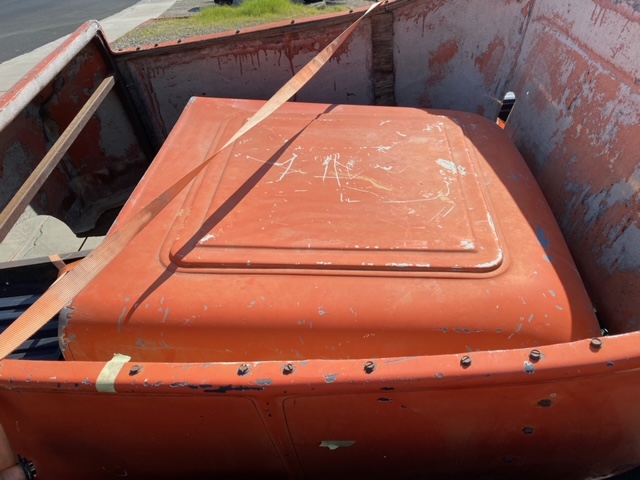

    Turtledeck. It just covers up the business card of the 'gl*** layer that is embedded in the p***enger door ****og. I don't know that I'll be able to read it, but if I can I'll post. Is it normal to use these types of screws to secure the body to the supporting wood? This looks terrible to me.
    It's faint, but this said "Lancaster", which is a couple hours away from me. Maybe somebody in SoCal has seen this car before?

  3. The rear x member is a bonus. Run a trad rear spring.
    Rework that front spring mount and rock on.
    Looks like it was set up to run a stock drop axle and they built the mount that tall.

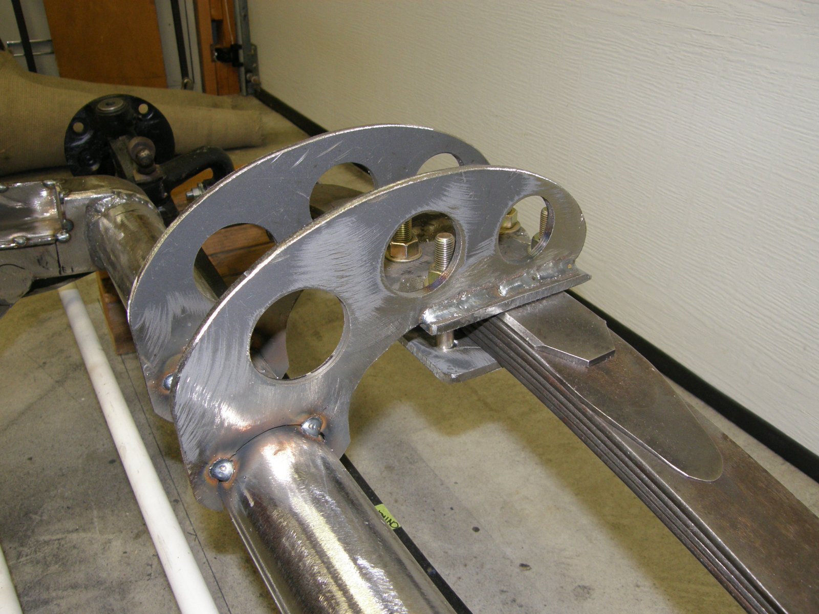

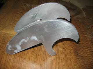

    The only issue with that style of "suicide" front end is the quality of the welds on that spring perch plus having the correct diameter and strength of steel tubing. That setup can't drop any further than than the axle and the perch will catch on the axle on the way down.
    Here is the "suicide" front end that they have been telling you is dangerous. If it is or isn't may depend a lot on on exactly how the perches were mounted as that is usually the issue.
    Note that on the blue T the spring is several inches behind the axle and there is no part of the frame or front perch that will catch on the axle on the way down.
    The bottom two photos are what most of us see as a more standard T bucket suicide perch than what you have now. Note that both wrap almost half way around the axle giving a lot of weld surface. The second one is a do it yourself idea done by a dude who goes by Hot Rod Tod that built his T from scratch I'll post the link for reference because it doesn't show how to do anything wrong that I can see. Hot Rod Todd (t-buckettodd.blogspot.com)
    Taking his style of perch you could design one that came out the exact height that you wanted.

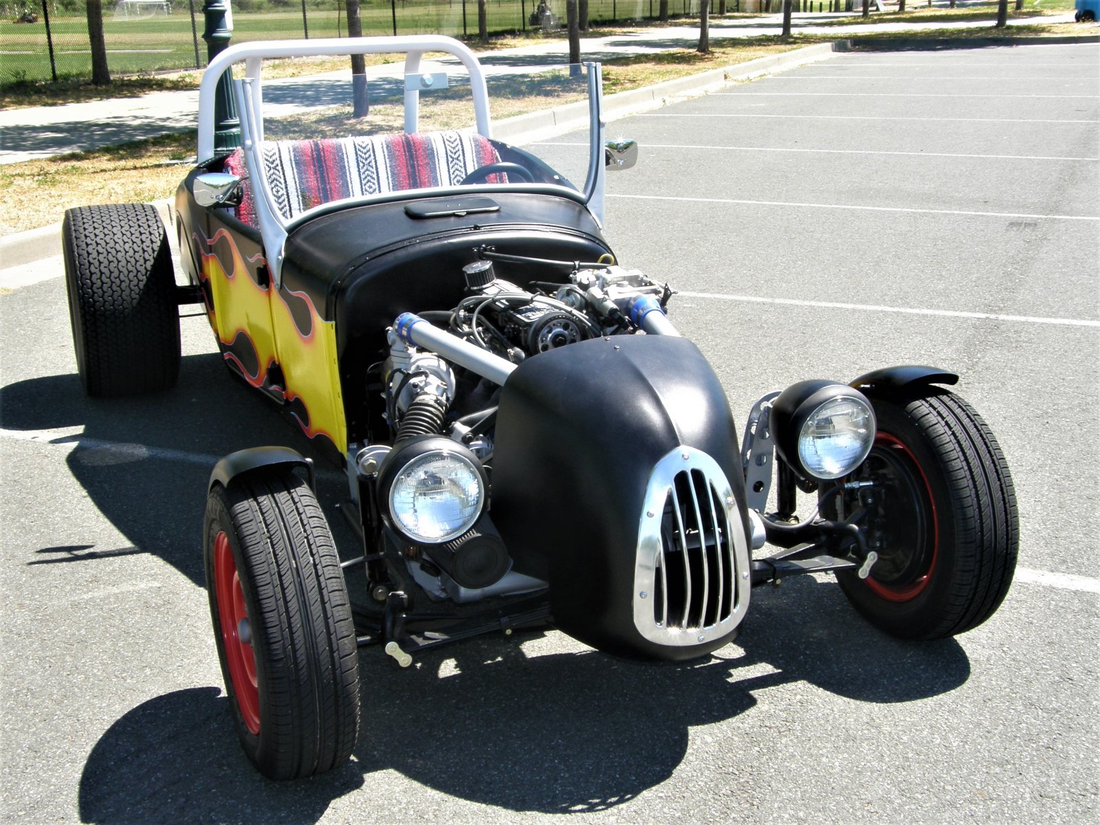

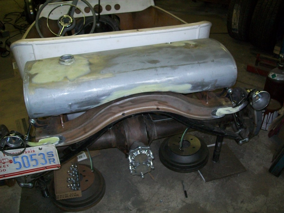

    I run a suicide front end on my '27 roadster with a spring in front :eek: of the axle. Put quite a few miles on it in the last 3 years with nary a problem. Stock '38 ford front end.
    The spring in front looks OK 'cause it's hidden by the track nose.....
