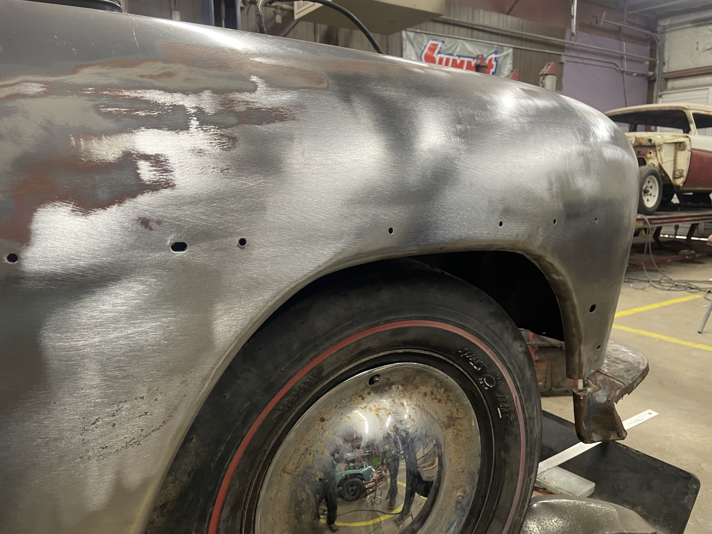

  4. Not all paints are the same. Did a killer job on this fender IMG_6356.jpeg IMG_6354.jpeg
    Toms Dogs likes this.
