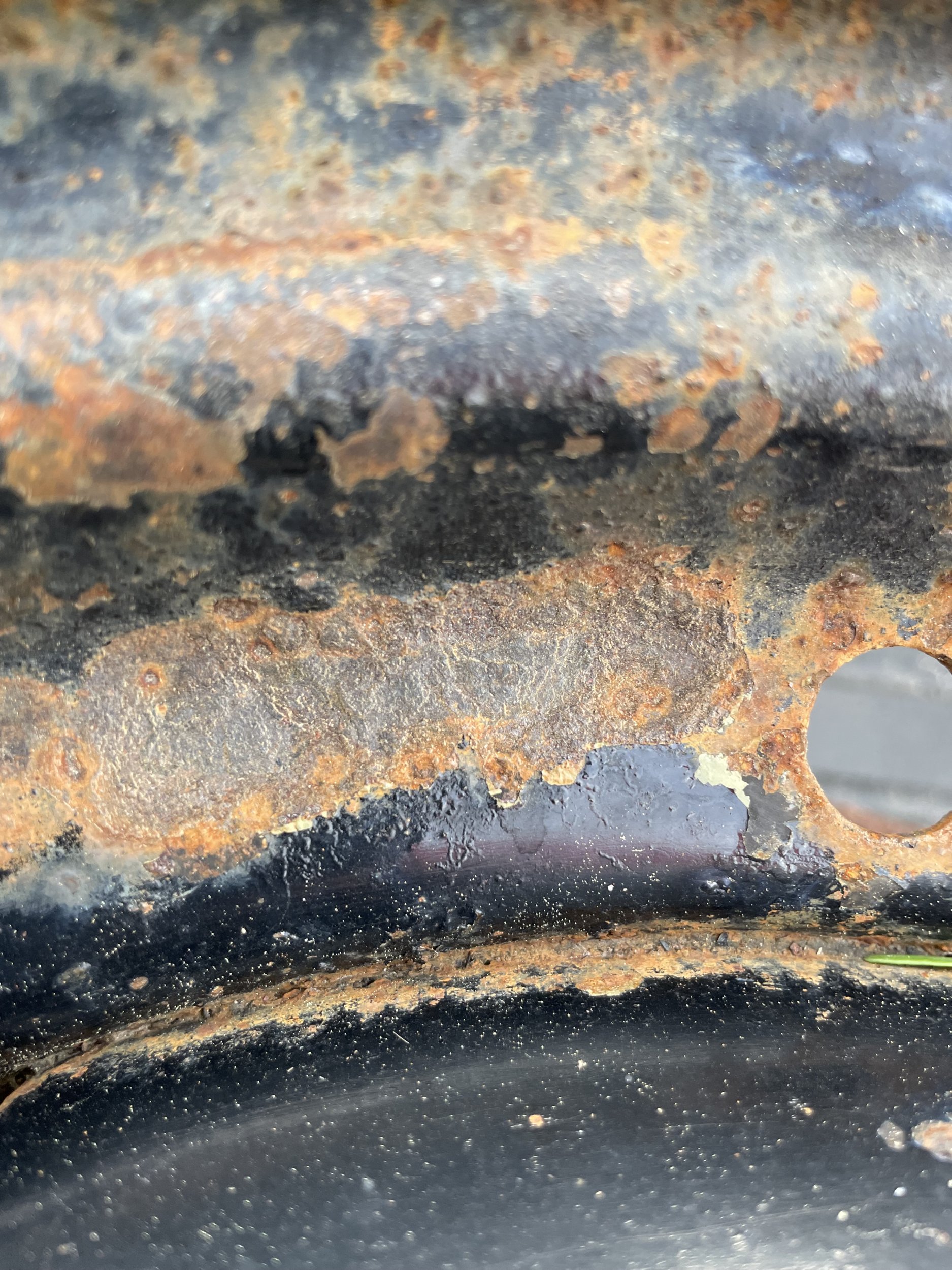

    IMG_4642.jpeg This is rust on a Mercury 16x5. Is this repairable? Tig weld up the low spot? It is very deep. Strange place to rust.
    Thanks

    patsurf
    blast it or dip it and run a tube--and don't road race it!
    hrm2k likes this.

    Welder up, grinder down.

    I’d sandblast the entire wheel and weld what needs welding and polish it up with a grinder.

    The rim was to go in Thursday to get trued up. Do I need to weld before?

    I would do all I mentioned above first then true it up.

    Weiding heat can warp anything.

    you really don't know what you have until its sand blasted. The valve stem hole looks good and often times thats the first sign of a junk wheel.

    I can't make a suggestion any better than that one as you will have to sand blast it to see what you actually have to deal with. I can't remember if those have the center welded to the rim or riveted but if it has rivets I'd ponder knocking the rivets out and popping the center out before I had it blasted.

    That is why I would braze up the weak low spot and dress it down. Less heat distortion with adequate strength.

    Hard to tell how deep that is from a picture, and without blasting first. I've had some stuff look way worse after blasting, and others much better than expected. But I've had a few rims with a handful of deep pits that I just blasted clean and welded/dressed with a grinder and not had any issues. I would definitely do that first before having it trued though. My guess is that with a little careful attention, this wheel will be fine.

    That's the most common place to rust. The air in the tube got low, some water leaked past the valve stem, then sat in there rusting away.

  16. Depending how much you need this particular wheel, IF riveted, knock them out, sandblast both parts separate, tig weld up the erosion, re-***emble using bolts to align the rivet holes, tig weld the back side along the center section ribs along the inside of the rim. Braze back in the now empty rivet holes. Brazing flows into clean cracks or joints like a fluid. If welded center, like the guys say, blast it, braze in the erosion from the front and I personally for safety reasons, tig weld the back side of the rim-hub flange contact.
    If running tubes, you can braze flow in the valve stem hole erosion, then finish off sides with a soft or flexible flap wheel on on a hand grinder and use a rat-tail file to open up or clean up the tube hole. I've done that quite a bit on rusty rims and I have had a lot of rusty rims on trucks and tractors.
    Then have it trued up, last thing. Just my opinion, like a **** crack, we all have one. I think ?

    If it is thin around the valve stem hole, you can always weld it up and drill a new one elsewhere.

    make sure the wobble is actually the wheel, not interference between the wheel and hub..or a high spot...
    I understand your desire to refurbish a 16x5 steel wheel, my search went on for quite a time and I agree with @anthony myrick
    clean it up and run it....I suspect there is something like a 2+x safety factor in the material there...clean it up, treat it cosmetically and don't look back
