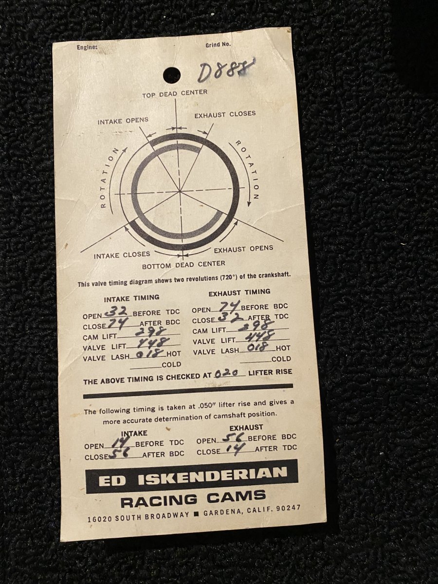

    3A6F7BF2-B93E-4E90-8740-629F49ECA380.jpeg I know I am late in this post, but I just joined. I had one of these engines in the late 60s.

    Close to the Howard 298 I just put in our GMC 6 street engine.

    Any idea what this 392 Hemi cam is?
    thanks
