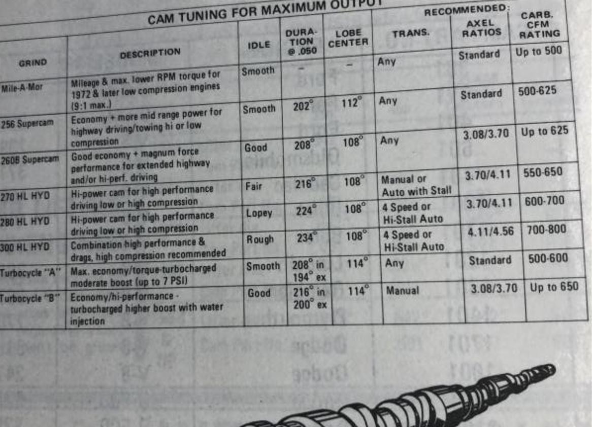

    Hi guys, does anyone have an old Isky catalog and can give me spec's for a SBC 300HL.
    I've tried to no avail to find this info on Isky's website.
    From memory it's 300 deg advertised duration and just shy of .500" lift at the valve.
    I'd like valve lift, and duration @ .050" lift.
    Thanks in advance to anyone who can help out.
    Arnold.
    • Racing Cam
    • Hyd.
    • Single Bolt
    • Valve Lift Int/Ext. 0.485
    • Valve Lash Hot Int/Ext. 0.000
    • ADV Duration Int/Ext. 300
    • 0.050 Duration Int/Ext. 234
    • Lobe Center 108

    Much appreciated @Texas********
