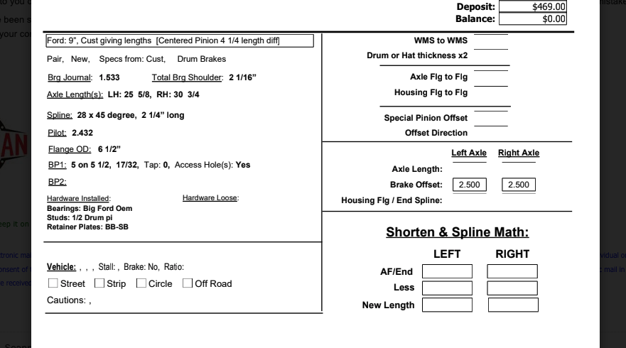

  17. Dutchman axles are the only way to go. You can order anything you want. Here is my order sheet for when I did the axles in my coupe.
    https://dutchmanaxles.com/
