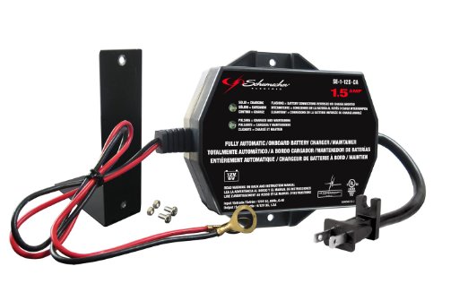

    I also use battery tenders over the winter on all of my stored vehicles. I do one other thing. Several years ago, I had a problem with a tender that went bad and overcharged a boat battery and ruined it. Since then I have used a cheap mechanical timer (available just about anywhere for about $10) that plugs into the wall socket. I then run extensions to the various tenders. I have found that setting the timer to charge the batteries for two 15 minute periods a day keeps them up just fine. I have had no problems of any kind since I started doing this. I leave my 1999 F150 in Minnesota over the winter hooked up this way. I had to install the second battery in it 4 years ago.

    I got tired of having low batteries and not being able to start my cars when i wanted to go for a drive. So bought a bunch of cheap battery maintainers and keep them plugged in. No more low or dead batteries, and easy starts after sitting for a while.
