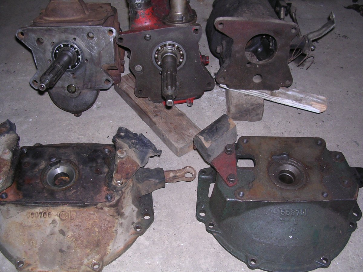

    here is a pic from one of F&J's posts.
    the left bell is a 51+ olds unit. It has the two side mounts attached that go to the crossmember in the Olds configurations. The unit on the right is the hard to find 50 Olds std bell #558701 with only one mount attached. Now, Cads apparently did not use the side mounts on their bells I am told and they are not configured to accept any mounts.. What is the number on your bell casting? From the front of your pic it looks to have the tap holes for the side mounts and it appears that it may in fact be a 50 Olds unit..558701
    So, where are you planning on placing the rear mt(s) for the ****** in your installation? Wonder if you would gain any advantage of using the side supports versus a single mount near the rear of the ****** if that is where it may be planned for. That is with the four bolts attaching the bell would you be better off supporting near the bell rather than at the rear of the ******?

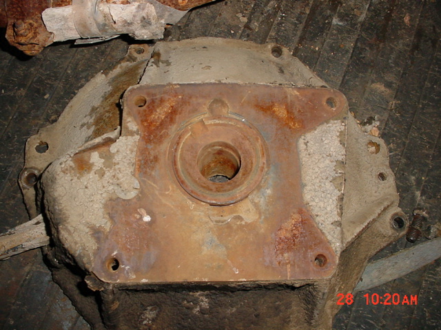

    Just for grins here is a pic of a cad engine with the factory bell
    and a close up of that same bell. Looks darn similar to your bolt config on your bell. FWIW.
