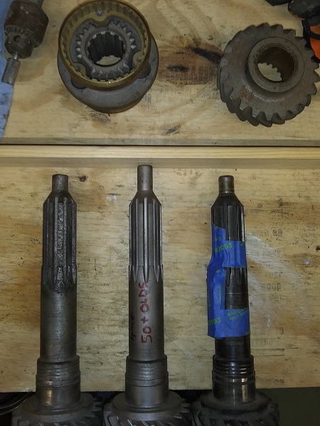

    Went out in the shop and pulled some pieces for a look. I have a 41 and a 51 Cad input shaft and they measure (from the front of the C clip groove to the end of the pilot) 7 3/8 and 7 5/16 . In comparison I have a shaft which I think is from a 50 Olds or maybe a 37 Cad and it measures out at 7 3/4. Pic attached:
    Could you post a pic of the new bell housing and the casting number? Measure from the face of the bell to the base and I can compare that to the Olds I have here just for comparison.

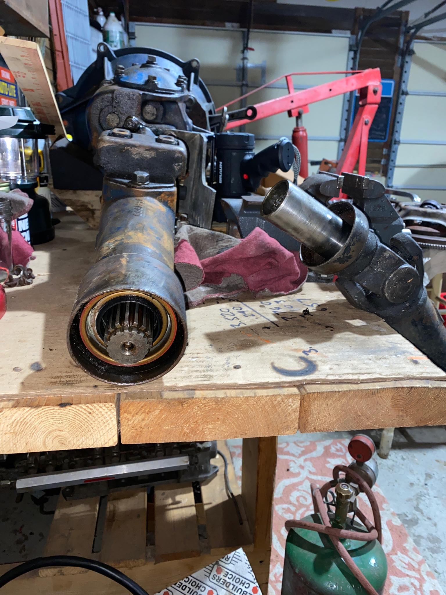

    My only question now is what is the difference between a 1939 Lasalle 3 speed and a 1949 Cadillac 3 speed. In the attached photo the green one I purchased from a HAMBER and was told it was a 39 Lasalle trans. The blue one I just purchased today and was told by the owner that it was removed from a 1949 Cadillac Sedanette. The blue one has a slightly longer input shaft measuring about 7 1/2 inches from the c clip as opposed to 7 3/8 inches for the green one. [​IMG][​IMG]
  12. Paul
    Joined: Aug 29, 2002
    Posts: 16,964
    Paul
    Editor
    They should be the same internally
    It looks like the blue one has the square cut nose at the pilot bushing, where the green has a chamfer.
    The blue one had an aftermarket floor shift the green one had the stock column shift.
